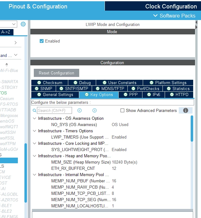

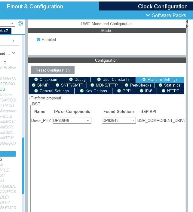

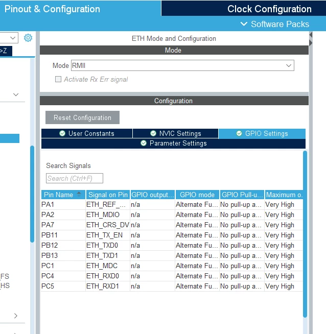

Good morning, I made a project using stm32f407vet6, configuring the stm32f407vet6 to use ethernet network without freertos, I can ping it and it responds immediately, follow the code:

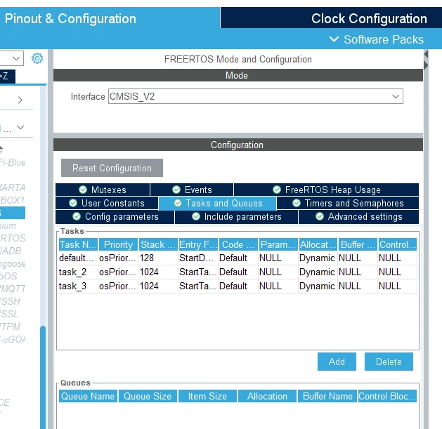

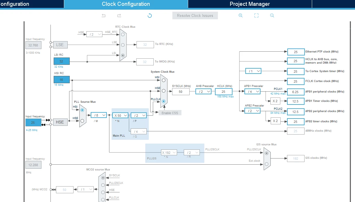

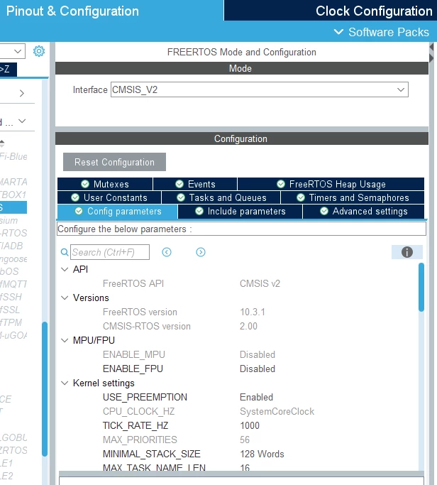

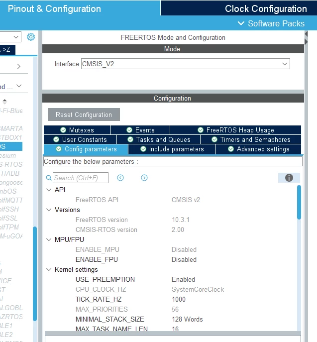

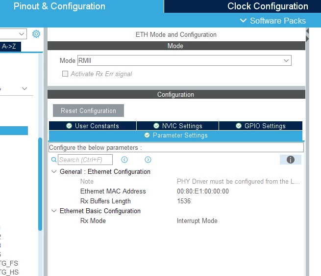

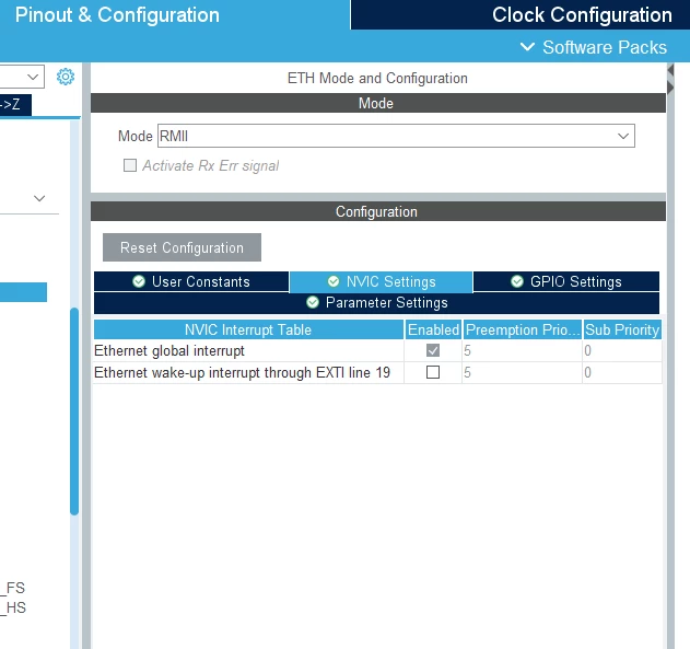

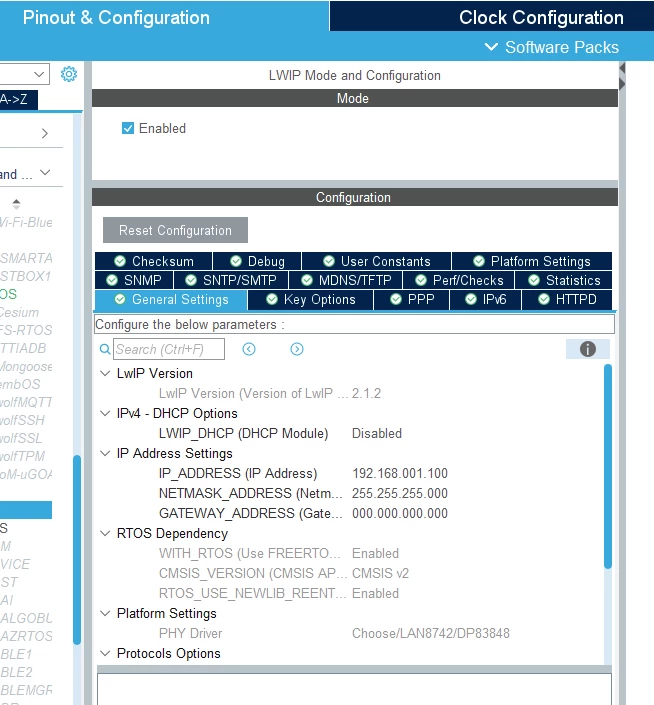

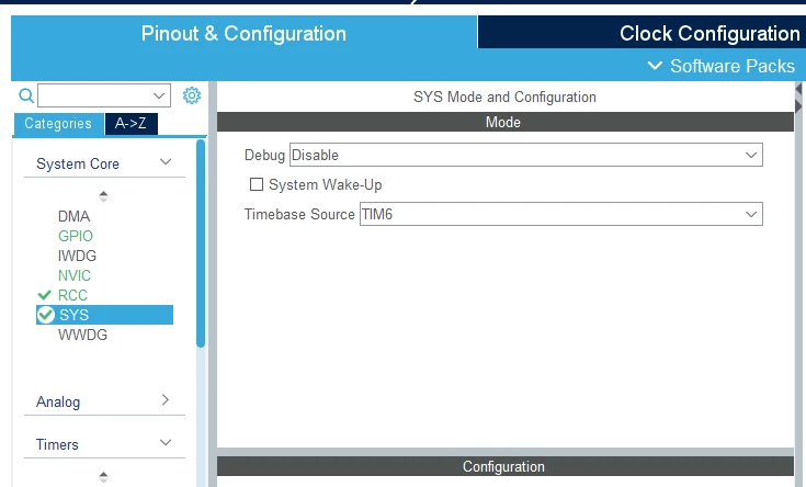

but now I want to use freertos and have a UDp server, but when configuring freertos, stm32f407vet6 gets stuck inside MX_LWIP_Init();, the firmware version for STmf4 is 1.28.1,  here is the code:

Hello @Mauricio_Vieira,
In your case, the application is stuck during the LwIP initialization due to insufficient stack size. You should increase the stack size to at least 256 words, preferably 512 words.
