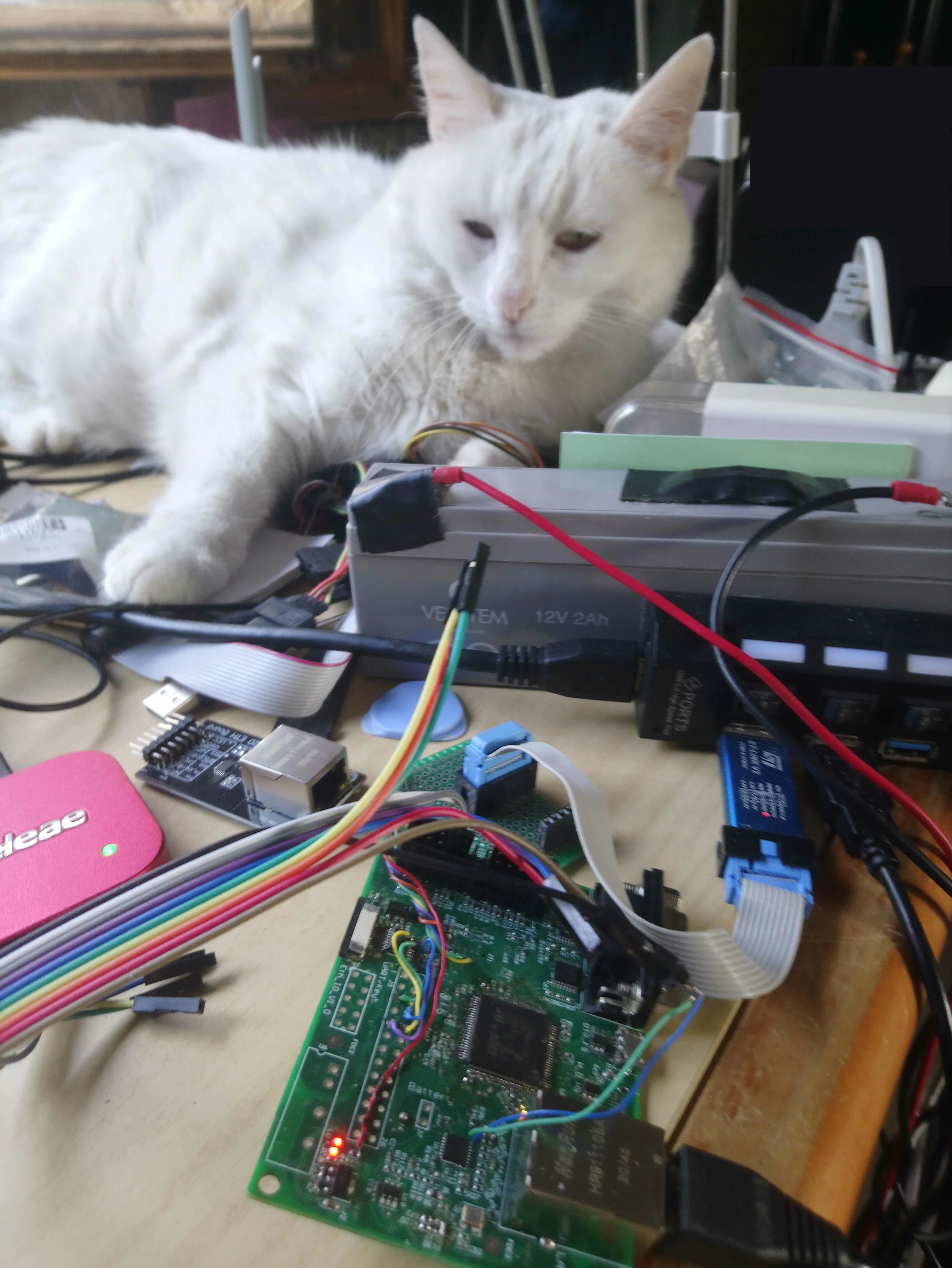

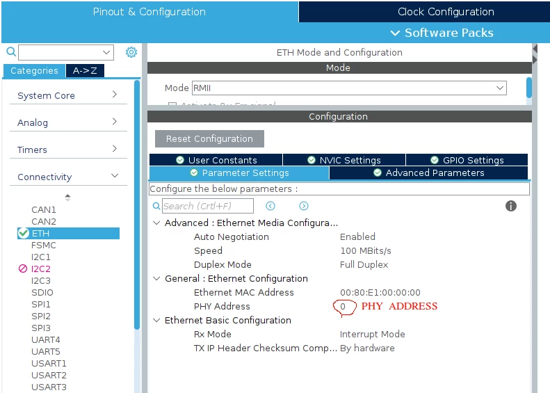

Hello, F407VET TQFP100 on custom board, ethernet PHY LAN8742A, STMCUBEIDE 1.6.1 on Linux (mint).
PHY and MCU both clocked by 25MHz oscillator, reference clock 50MHz is OK. Cpu running @168MHz
FREERTOS 3 task:
default init LWIP, start HTTPD thread then feed TCPIP ECHO server
Task1: feed UDP Echo Server
Task2: managing RGB led
Task 2 is OK but no signal come from Ethernet remain in idle color fading.
default task init LWIP, start HTTPD task, release init flag enter loop..
task 1 Ethernet echo enter loop after flag released.

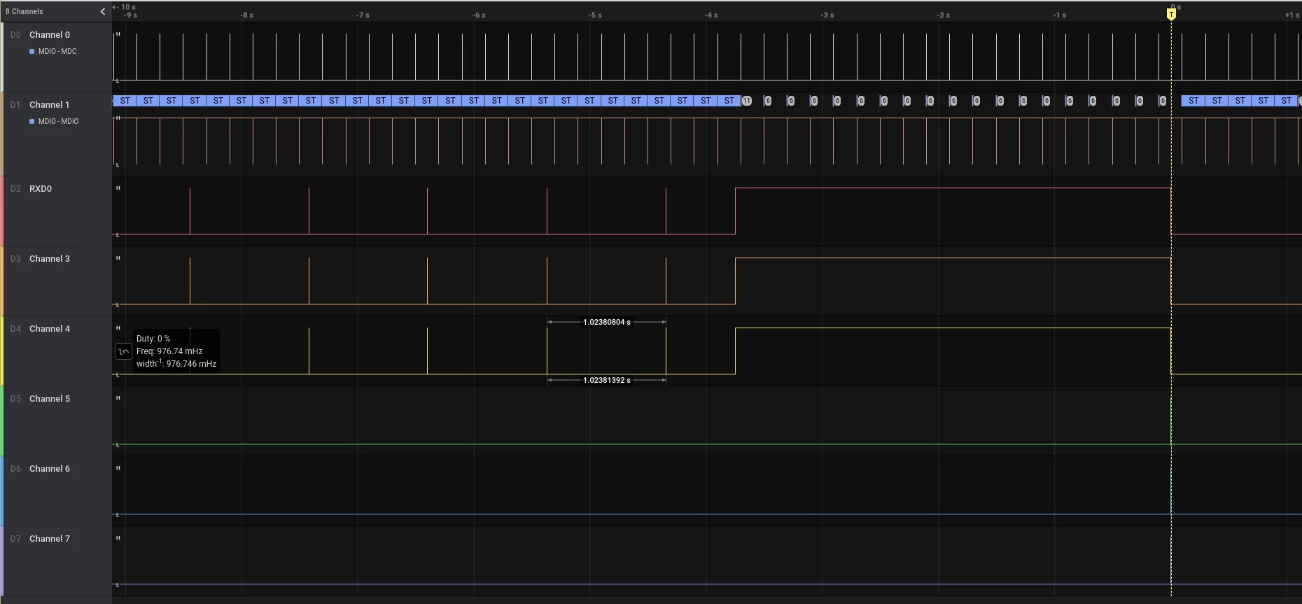

Checked MDIO Bus activity with Saleae Logic 8 pro it show PHY doesn't complete initialization:

  • Simplified MDIO communication
write register 0 phyadd 0 0x8000 (Software reset)
repeatedly read register 0x1f Phyadd 0x1f (??) result 0xffff (Open bus)
read register 1 Phyadd 0 result for a while 0x7809
after many poll status change to 0x782d
write register 0 phyadd 0 0x1000 (Auto Negotiation)
read register 1 Phyadd 0 result 0x782d
read register 0x10 Phyadd 0 result 0x0041
read register 0x1d Phyadd 0 result 0x00ca
write register 0x1d Phyadd 0 result 0x00cb
no more action appear on MDIO bus
No visible activity on rx tx PHY lines
Link led active solid.
Activity led pulse on ping packet
pcb is 4 layer, need some fixes due was planned for F429. Components shortage forced a change to F407, on this SPI 4 not present require some fix but nothing to do with LAN interface.
Has someone idea of what can be wrong? Read Piranha post but leave us at ground level, say what wrong ( I fell can be too) but no idea where are located (VERY) sparse files of Ethernet module.
Previous test were done on nucleo board with Adafruit LCD. Extended to FREERTOS and lan but none of old project compile on new ide.0693W00000CzxZ5QAJ.jpg My cat router assistant declared hand off too ;)
Thank in advance

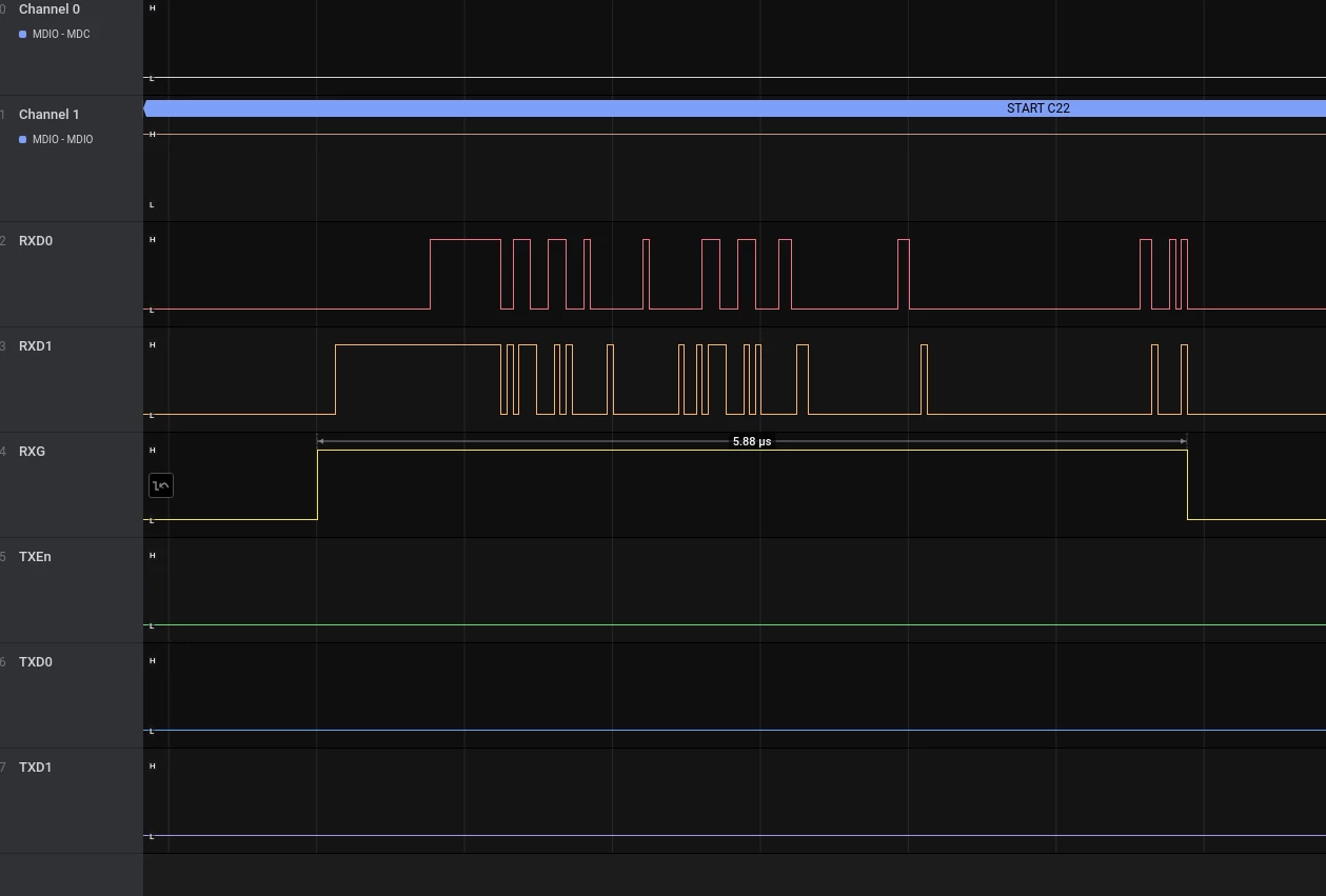

Update:

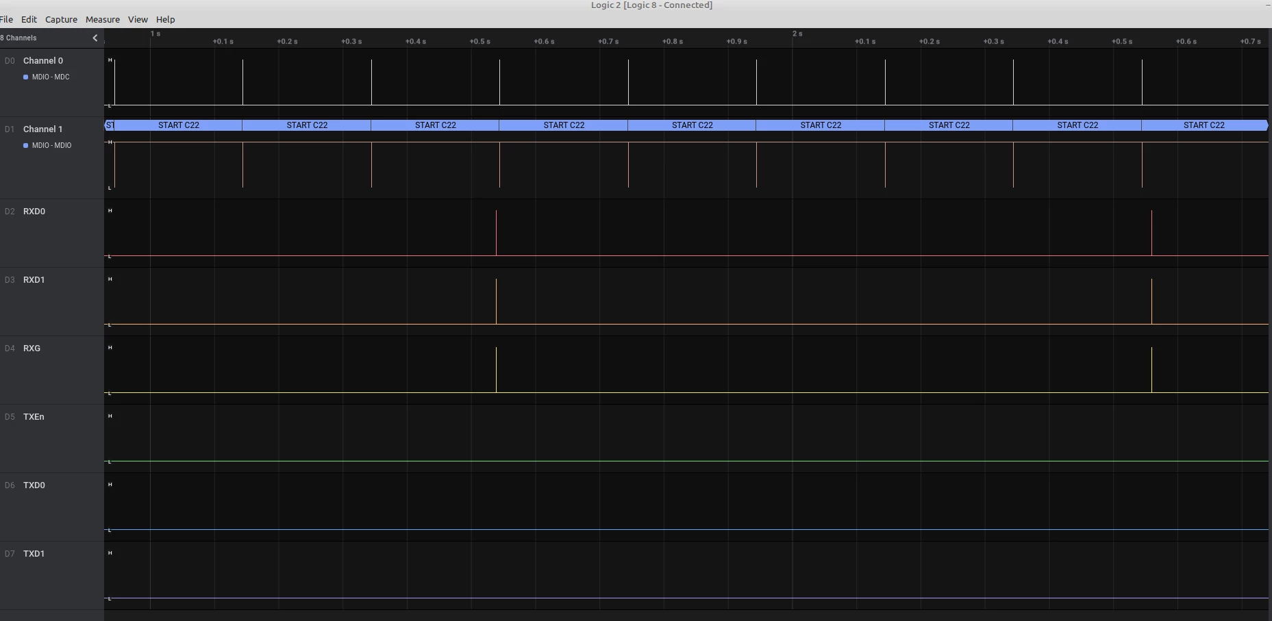

Connected all RX TX wires to get a more stable probing.
RX Gate and data is present, TX is missing. TX pin tested redeclaring as Output then driving in a sequence. Pin are OK
Work in progress still no idea from where trouble come from.0693W00000D00v1QAB.png0693W00000D011vQAB.pngEdit1: Found some hint from Majerle Tilen Site about Pin A8, try'd use as MCO but nothing changed.
Edit2: PHY configuration is ok, can work untouched too with resistor strap initial config. Issue come from MAC part, no transmit. Is Ping/ARP frame received? Inspection still in progress.

rromano001
Senior
Jul 20, 2021 8:34 PM UTC
0693W00000D09k0QAB.pngAppended trigger to TXen.
Nothing happen for a long time.
Pressed reset and released, one pulse is transmitted just after release. This time PHY is not ready...
Read errata about network issue on STM32F4x7, nothing appropriate and no mention of irresponsive network..

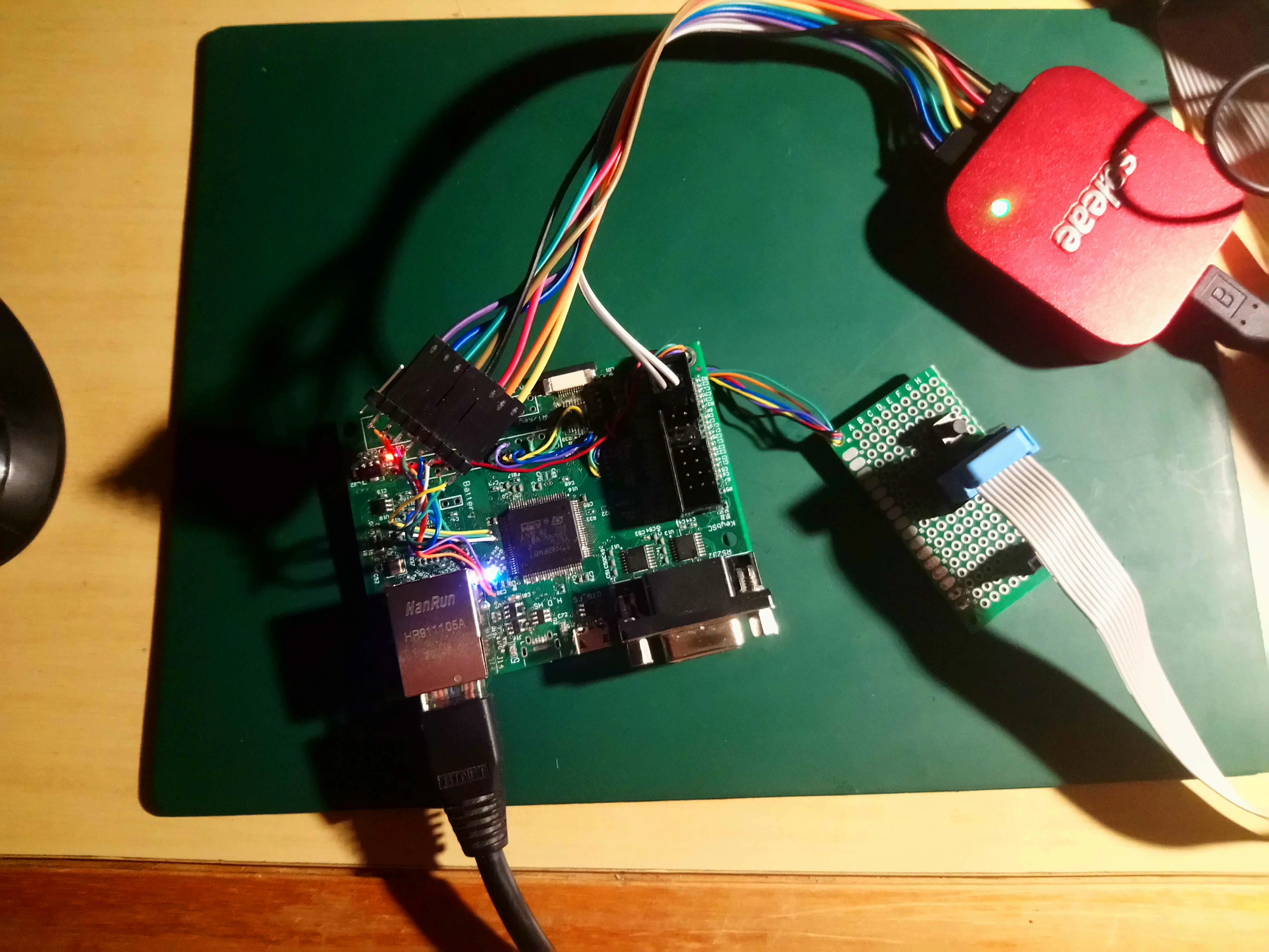

Actual setup
0693W00000D09o2QAB.jpgEdit1: traced both f407 and f429 code Ethernet register access not found. Someone know where MAC registe got accessed from?

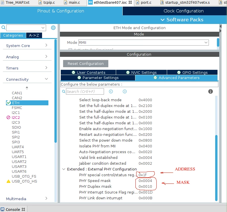

COntrol spawn across 3 task
stm32f4xx_hal_eth
on lines 415-479 register 16 of phy is interpreted as autonegotiation result, register 16 or 0x10 is listed on datasheet as EDPD NLP/CROSSOVER TIMEREGISTER
nothing to do with remote party negotiation
Register carrying this information can be 31 or 0x1f PHY SPECIAL CONTROL/STATUS REGISTER
but format is different on list, anyway
bit 4 is duplex PHY_DUPLEX_STATUS must be 0x10 not 4
1 Full
0 Half
Bit 3,2 PHY_SPEED_STATUS is assigned value 2 odd but ok bit 3,2 value must be 4, 8, better to test for right value.
01 10 Base T
10 100 Base T
link task also carry on HORRIFIC goto too... Is this professional or not?

 this same code is present on f429zi working project

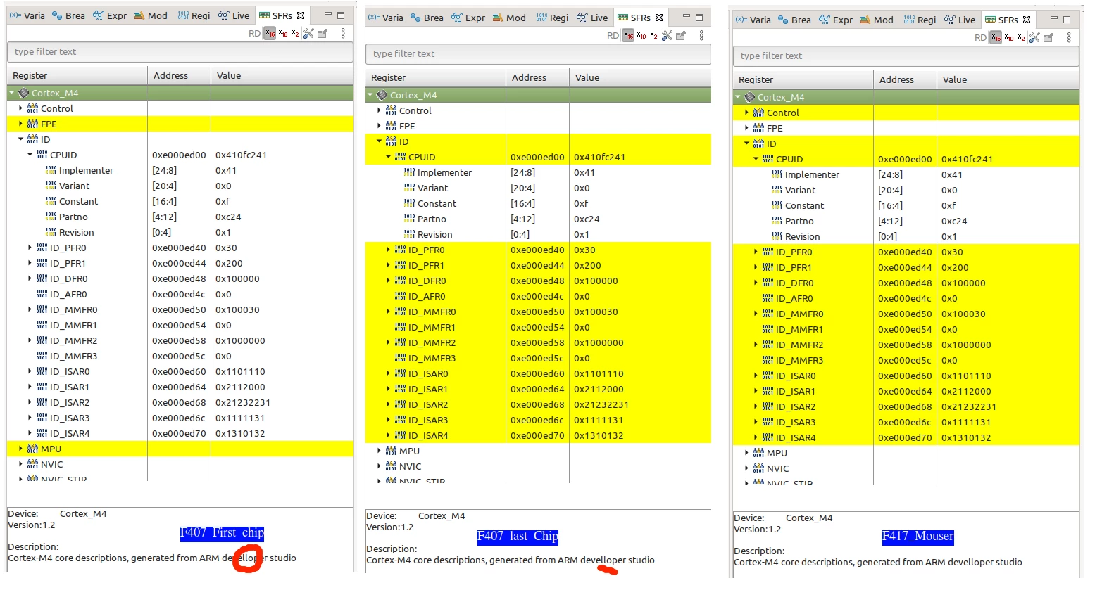

Result step:
R72 MDIO pullup is listed as 10K on schematic, on board got reworked to 1K5 as I found on reference schematic and sparse across LAN8742A data sheet.
Suspecting F407 can be defective mounted an STM32F417VET6 bought from Mouser. I own just one more 417, I found some 407 available from secondary channels, Ebay, Aliexpress.
Mounted F417 still doesn't work, all freeze after executing Ethernet interrupt line 1180 (stm32f4xx_hal_eth.c)
stopping cpu code appear seldom on HardFault, often show port.c lines 754 770 (freezed)
         configASSERT( ucCurrentPriority >= ucMaxSysCallPriority );
Added independent monochromatic blink led on hard fault loop never seen blink nor get solid color.
VCC 3.23V VCAP1=VCAP2 = 1.25V
Commenting out Network init code remaining task work fine.
Feel afraid and extremely scared about this issue as I read across forum plague all Ethernet parts since far past.

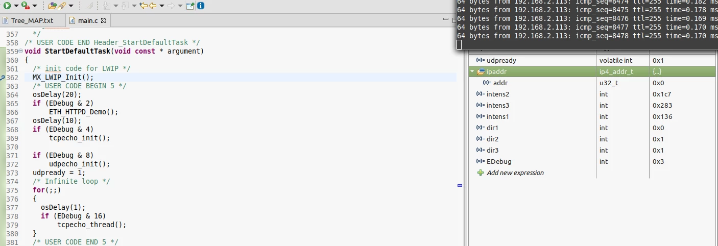

F417, generating a new project:
patching PHY register address,
commenting out all network tasks other than LWIP_Init
got DHCP negotiation:
IP address after negotiation remain zero(??)
0693W00000D0aEfQAJ.png From router table got address, it respond to ping.
Enabled HTTPD, browser work on demo page loading quite fast but slow down a lot during file access.

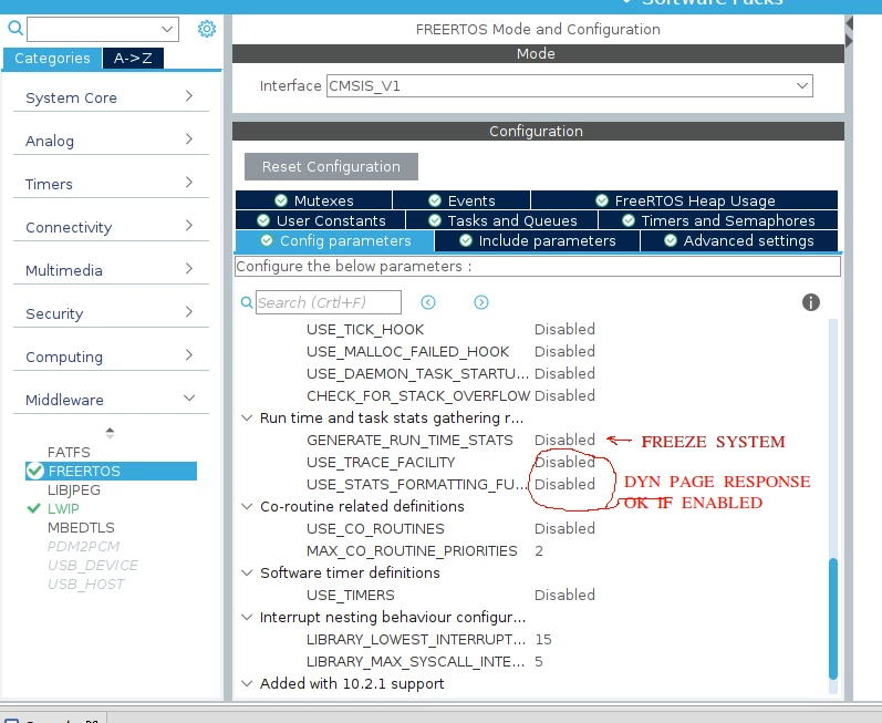

Enabling FreeRTOS config parameters:
USE_STATS_Formatting, USE_TRACE_FACILITY remain up and respond to dynamic page. (after patching stack space)
enabling GENERATE_RUN_TIME_STATS freeze all.

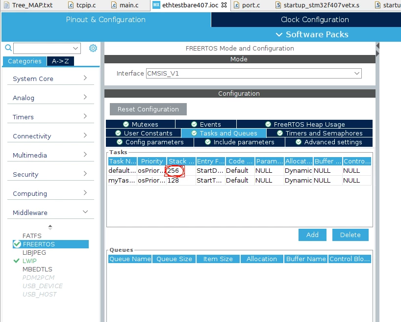

Default task 128Bytes stack is not enough, raised to 256 seems more stable.

Generated another base project targeted to 407VE, as is froze. Applied stack increment to default task respond to ping.

407 board maybe damaged, doesn't work, just wait some new 407 I ordered. When arrive try rework both mcu and PHY.
0693W00000D0a0dQAB.png0693W00000D0a0TQAR.png0693W00000D0a0OQAR.png0693W00000D0a0EQAR.png

Updated Cubeide to new version 1.7.0:
many RTOS setting reverted to default, all parameter listed need be checked again.
New fresh project now respond to ping. PHY Address still set to 1 when all board use 0. Status register address still 0x10
Old project after restoring settings respond to ping but HTTP task is no more working. (Work in progress)

I think I've seen issues with hard faults in the past when the configured stack was too low. It's good to enable the stack overflow monitoring in freertos configuration. I would anyway increase the stack to e.g. 768 to have a bit of margin...

Hard fault is not fired as written thru text, system freeze and lost control, yes it resemble a stack failure.
Stack overflow monitor was enabled, not of help when mcu is freezed with no idea where it was freezed, so catched by single stepping code or dynamic modifying bit of an execution flag.

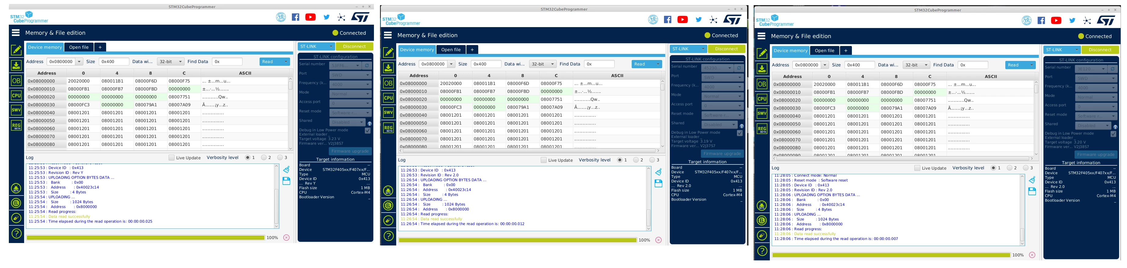

0693W00000DlVAIQA3.png0693W00000DlVA3QAN.pngHello Tesla DeLorean, all other, Yesterday I finally received new F407 chip.
Applied to a new board it work and respond to ping. Now 3 board are complete, F407 With name First doesn't work. F407_Last and F417 work.
Attached are images from CubeIde register and from Cubeprogrammer, all MCU return same ID, just F417 report version Y instead of version 2.0.
Also attached as Zip the text dump of all register by part.
Hardware test:
On board F407_First try'd rework PHY, no success, New PHY still complete negotiation and link but no MAC TX activity.
Don't rework F407 for now I reserve do some Inspection on.

traced init, HTTP task is not activated, terminate with memory allocation error... ??? ...
Increased Heap from default 15360 to 32K HTTPD task was correctly spawn.
Still slow when image file are accessed but now both 407 and 417 perform same way. First board remain behind dryer waiting some new hint to address failure reason.
