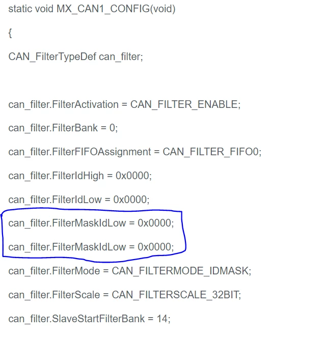

                   i'm using two boards for my hobby purpose(stm32f108cxx bluepill board and stm32f407g discovery board). i tried the controller area network loopback mode in bluepill is working fine but in the stm32f407 discovery board controller area network is not working. For CAN transceiver i'm  using sn65hvd230 IC. when absorb in the debugging mode transmitter is working fine but when pointer comes to receiver its not working. i pasted the code below
static void MX_CAN1_CONFIG(void)
CAN_FilterTypeDef can_filter;
can_filter.FilterActivation = CAN_FILTER_ENABLE;
can_filter.FilterBank = 0;
can_filter.FilterFIFOAssignment = CAN_FILTER_FIFO0;
can_filter.FilterIdHigh = 0x0000;
can_filter.FilterIdLow = 0x0000;
can_filter.FilterMaskIdLow = 0x0000;
can_filter.FilterMode = CAN_FILTERMODE_IDMASK;
can_filter.FilterScale = CAN_FILTERSCALE_32BIT;
can_filter.SlaveStartFilterBank = 14;
if(HAL_CAN_ConfigFilter(&hcan1, &can_filter) != HAL_OK)
Error_Handler();

code is stuck in the receiver section
"while(!HAL_CAN_GetRxFifoFillLevel(&hcan1, CAN_FILTER_FIFO0));"

Nov 10, 2023 5:15 AM UTC
Hi Karl Yamashita,
                          I got it. Mistake in my code only. That is in the CAN configuration block two times written Filtermask_low. need to give one filtermask_high and filtermask_low. so i corrected now its data is receiving.
