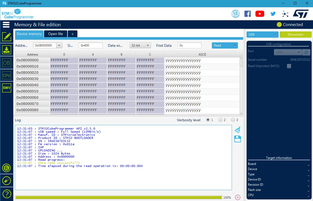

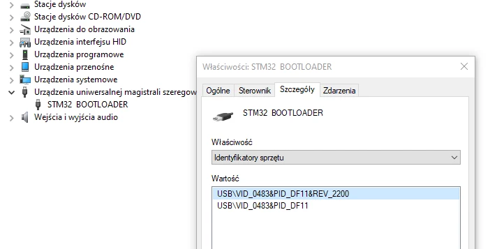

Recently I had to replace the MCU in a device and I tried to upload the code using USB Bootloader, as it is available and requires very little stuff when you're on site.

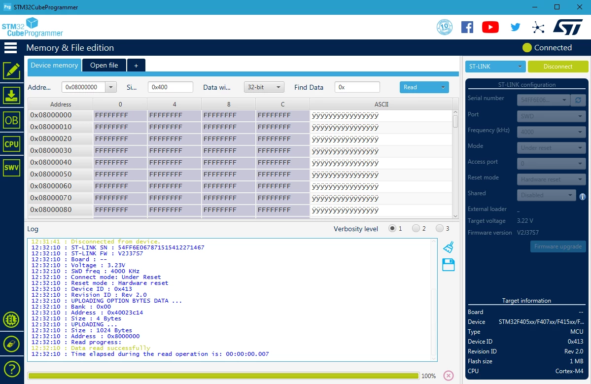

So, the MCU has been detected in the system (see PIC1.png), but the CubeProgrammer (v 2.5.0) could not properly connect to it via USB. Properly means that I'd get an accesss to anything - after a connection try, it changed state to connected, but the MCU ID, flash size etc are not shown, while they should be (see PIC2.png). Luckily I managed to connect using ST-Link (see PIC3.png) and the situation is partially resolved. The application does not use USB so I cannot do a fast check if the USB peripheral even works properly.
What I noted is that the MCU revision is 2.0, while in the other device (which normally connects via USB) it is Z. Can this be a problem?
Thanks in advance for any help, as I'd like to make the DFU via USB running back again.

The target information section is optional. Does it otherwise work okay? Looks like it read memory fine. Might not be a problem that needs solved.
You could try updating to the latest STM32CubeProgrammer version of v2.17.0, quite a bit newer than what you're running. I get the target information to populate when I connect via USB.

Jul 26, 2024 2:48 PM UTC
I updated CubeProgrammer to newest version and... it worked!
