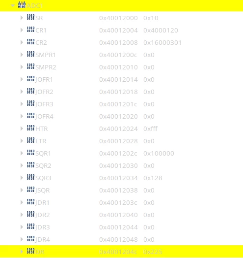

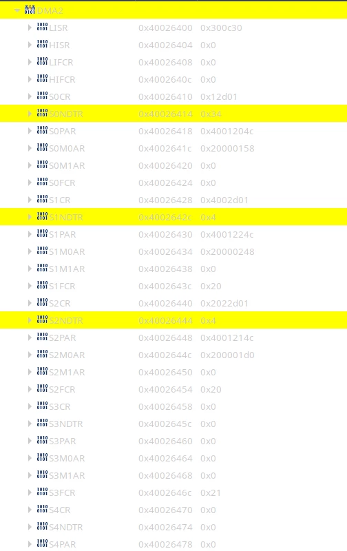

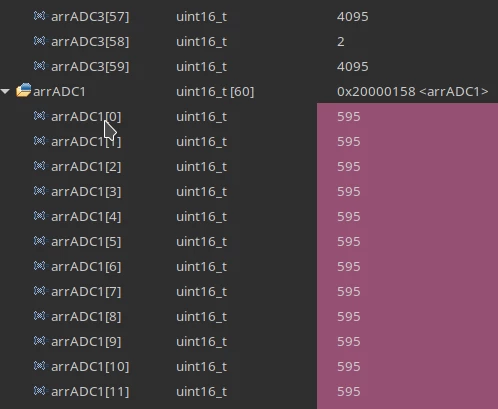

I config ADC with DMA and TIM2. By TIM2 overflow starts ADC process for ADC1 ADC2 and ADC3 simultaneously. DMA collect ADC data and store to RAM. In debug i see that DMA for ADC1 transfer the same ADC data several times.
For example:
ADC1: 32, 32, 32, 32, 32, 32, 32 11, 11, 11, 11, 11
ADC2: 32, 11
ADC3: 32, 11
Problem not with ADC1. I arrange interrupt after end of conversion. It's interrupts by TIM2.
void HAL_ADC_MspInit(ADC_HandleTypeDef* hadc)
 if(hadc->Instance==ADC1)
	 memset(arrADC1, 0, ARR_LEN * sizeof(arrADC1[0]));
 __HAL_RCC_ADC1_CLK_ENABLE();
 __HAL_RCC_GPIOB_CLK_ENABLE();
 GPIO_InitStruct.Pin = GPIO_PIN_0|GPIO_PIN_1;
 GPIO_InitStruct.Mode = GPIO_MODE_ANALOG;
 HAL_GPIO_Init(GPIOB, &GPIO_InitStruct);
 hdma_adc1.Instance = DMA2_Stream0;
 hdma_adc1.Init.Channel = DMA_CHANNEL_0;
 hdma_adc1.Init.Direction = DMA_PERIPH_TO_MEMORY;
 hdma_adc1.Init.PeriphInc = DMA_PINC_DISABLE;
 hdma_adc1.Init.MemInc = DMA_MINC_ENABLE;
 hdma_adc1.Init.PeriphDataAlignment = DMA_PDATAALIGN_HALFWORD;
 hdma_adc1.Init.MemDataAlignment = DMA_MDATAALIGN_HALFWORD;
 hdma_adc1.Init.Mode = DMA_CIRCULAR;
 hdma_adc1.Init.Priority = DMA_PRIORITY_MEDIUM;
 hdma_adc1.Init.FIFOMode = DMA_FIFOMODE_DISABLE;
 if (HAL_DMA_Init(&hdma_adc1) != HAL_OK)
 Error_Handler();
 __HAL_LINKDMA(hadc,DMA_Handle,hdma_adc1);
 HAL_ADC_Start_DMA(hadc, (uint32_t *)arrADC1, ARR_LEN);
 else if(hadc->Instance==ADC2)
	 memset(arrADC2, 0, ARR_LEN * sizeof(arrADC1[0]));
 __HAL_RCC_ADC2_CLK_ENABLE();
 __HAL_RCC_GPIOC_CLK_ENABLE();
 GPIO_InitStruct.Pin = GPIO_PIN_1|GPIO_PIN_2;
 HAL_GPIO_Init(GPIOC, &GPIO_InitStruct);
 hdma_adc2.Instance = DMA2_Stream2;
 hdma_adc2.Init.Channel = DMA_CHANNEL_1;
 hdma_adc2.Init.Direction = DMA_PERIPH_TO_MEMORY;
 hdma_adc2.Init.PeriphInc = DMA_PINC_DISABLE;
 hdma_adc2.Init.MemInc = DMA_MINC_ENABLE;
 hdma_adc2.Init.PeriphDataAlignment = DMA_PDATAALIGN_HALFWORD;
 hdma_adc2.Init.MemDataAlignment = DMA_MDATAALIGN_HALFWORD;
 hdma_adc2.Init.Mode = DMA_CIRCULAR;
 hdma_adc2.Init.Priority = DMA_PRIORITY_HIGH;
 hdma_adc2.Init.FIFOMode = DMA_FIFOMODE_DISABLE;
 if (HAL_DMA_Init(&hdma_adc2) != HAL_OK)
 Error_Handler();
 __HAL_LINKDMA(hadc,DMA_Handle,hdma_adc2);
 else if(hadc->Instance==ADC3)
	 memset(arrADC3, 0, ARR_LEN * sizeof(arrADC1[0]));
 __HAL_RCC_ADC3_CLK_ENABLE();
 __HAL_RCC_GPIOA_CLK_ENABLE();
 HAL_GPIO_Init(GPIOA, &GPIO_InitStruct);
 hdma_adc3.Instance = DMA2_Stream1;
 hdma_adc3.Init.Channel = DMA_CHANNEL_2;
 hdma_adc3.Init.Direction = DMA_PERIPH_TO_MEMORY;
 hdma_adc3.Init.PeriphInc = DMA_PINC_DISABLE;
 hdma_adc3.Init.MemInc = DMA_MINC_ENABLE;
 hdma_adc3.Init.PeriphDataAlignment = DMA_PDATAALIGN_HALFWORD;
 hdma_adc3.Init.MemDataAlignment = DMA_MDATAALIGN_HALFWORD;
 hdma_adc3.Init.Mode = DMA_CIRCULAR;
 hdma_adc3.Init.Priority = DMA_PRIORITY_LOW;
 hdma_adc3.Init.FIFOMode = DMA_FIFOMODE_DISABLE;
 if (HAL_DMA_Init(&hdma_adc3) != HAL_OK)
 Error_Handler();
 __HAL_LINKDMA(hadc,DMA_Handle,hdma_adc3);
 HAL_ADC_Start_DMA(hadc, (uint32_t *)arrADC3, ARR_LEN );

static void MX_ADC1_Init(void)
 /* USER CODE BEGIN ADC1_Init 0 */
 //ADC1->CR1 |= ADC_CR1_EOCIE;
 /* USER CODE END ADC1_Init 0 */
 ADC_MultiModeTypeDef multimode = {0};
 ADC_ChannelConfTypeDef sConfig = {0};
 /* USER CODE BEGIN ADC1_Init 1 */
 HAL_NVIC_SetPriority(ADC_IRQn, 4, 0);
 HAL_NVIC_EnableIRQ(ADC_IRQn);
 /* USER CODE END ADC1_Init 1 */
 /** Configure the global features of the ADC (Clock, Resolution, Data Alignment and number of conversion)
 hadc1.Instance = ADC1;
 hadc1.Init.ClockPrescaler = ADC_CLOCK_SYNC_PCLK_DIV4;
 hadc1.Init.Resolution = ADC_RESOLUTION_12B;
 hadc1.Init.ScanConvMode = ENABLE;
 hadc1.Init.ContinuousConvMode = DISABLE;
 hadc1.Init.DiscontinuousConvMode = DISABLE;
 hadc1.Init.ExternalTrigConvEdge = ADC_EXTERNALTRIGCONVEDGE_RISING;
 hadc1.Init.ExternalTrigConv = ADC_EXTERNALTRIGCONV_T2_TRGO;
 hadc1.Init.DataAlign = ADC_DATAALIGN_RIGHT;
 hadc1.Init.NbrOfConversion = 2;
 hadc1.Init.DMAContinuousRequests = ENABLE;
 hadc1.Init.EOCSelection = ADC_EOC_SEQ_CONV;
 if (HAL_ADC_Init(&hadc1) != HAL_OK)
 Error_Handler();
 /** Configure the ADC multi-mode
 multimode.Mode = ADC_TRIPLEMODE_REGSIMULT;
 multimode.DMAAccessMode = ADC_DMAACCESSMODE_1;
 multimode.TwoSamplingDelay = ADC_TWOSAMPLINGDELAY_5CYCLES;
 if (HAL_ADCEx_MultiModeConfigChannel(&hadc1, &multimode) != HAL_OK)
 Error_Handler();
 /** Configure for the selected ADC regular channel its corresponding rank in the sequencer and its sample time.
 sConfig.Channel = ADC_CHANNEL_8;
 sConfig.Rank = 1;
 sConfig.SamplingTime = ADC_SAMPLETIME_3CYCLES;
 if (HAL_ADC_ConfigChannel(&hadc1, &sConfig) != HAL_OK)
 Error_Handler();
 sConfig.Channel = ADC_CHANNEL_9;
 sConfig.Rank = 2;
 Error_Handler();
 /* USER CODE BEGIN ADC1_Init 2 */
 /* USER CODE END ADC1_Init 2 */

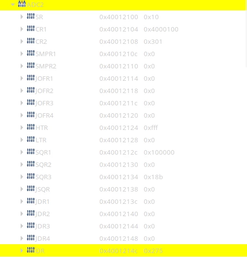

static void MX_ADC2_Init(void)
 /* USER CODE BEGIN ADC2_Init 0 */
 /* USER CODE END ADC2_Init 0 */
 /* USER CODE BEGIN ADC2_Init 1 */
 /* USER CODE END ADC2_Init 1 */
 hadc2.Instance = ADC2;
 hadc2.Init.ClockPrescaler = ADC_CLOCK_SYNC_PCLK_DIV4;
 hadc2.Init.Resolution = ADC_RESOLUTION_12B;
 hadc2.Init.ScanConvMode = ENABLE;
 hadc2.Init.ContinuousConvMode = DISABLE;
 hadc2.Init.DiscontinuousConvMode = DISABLE;
 hadc2.Init.DataAlign = ADC_DATAALIGN_RIGHT;
 hadc2.Init.NbrOfConversion = 2;
 hadc2.Init.DMAContinuousRequests = ENABLE;
 hadc2.Init.EOCSelection = ADC_EOC_SEQ_CONV;
 if (HAL_ADC_Init(&hadc2) != HAL_OK)
 Error_Handler();
 sConfig.Channel = ADC_CHANNEL_11;
 sConfig.Rank = 1;
 if (HAL_ADC_ConfigChannel(&hadc2, &sConfig) != HAL_OK)
 Error_Handler();
 /* USER CODE BEGIN ADC2_Init 2 */
 sConfig.Channel = ADC_CHANNEL_12;
	sConfig.Rank =2;
	 Error_Handler();
 /* USER CODE END ADC2_Init 2 */

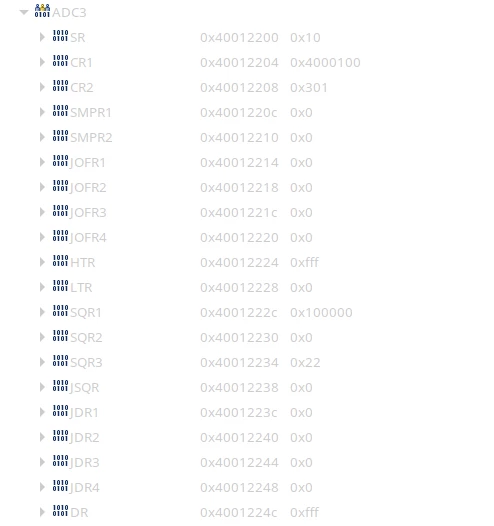

static void MX_ADC3_Init(void)
 /* USER CODE BEGIN ADC3_Init 0 */
 /* USER CODE END ADC3_Init 0 */
 /* USER CODE BEGIN ADC3_Init 1 */
 /* USER CODE END ADC3_Init 1 */
 hadc3.Instance = ADC3;
 hadc3.Init.ClockPrescaler = ADC_CLOCK_SYNC_PCLK_DIV4;
 hadc3.Init.Resolution = ADC_RESOLUTION_12B;
 hadc3.Init.ScanConvMode = ENABLE;
 hadc3.Init.ContinuousConvMode = DISABLE;
 hadc3.Init.DiscontinuousConvMode = DISABLE;
 hadc3.Init.DataAlign = ADC_DATAALIGN_RIGHT;
 hadc3.Init.NbrOfConversion = 2;
 hadc3.Init.DMAContinuousRequests = ENABLE;
 hadc3.Init.EOCSelection = ADC_EOC_SEQ_CONV;
 if (HAL_ADC_Init(&hadc3) != HAL_OK)
 Error_Handler();
 sConfig.Channel = ADC_CHANNEL_1;
 sConfig.Rank = 2;
 if (HAL_ADC_ConfigChannel(&hadc3, &sConfig) != HAL_OK)
 Error_Handler();
 sConfig.Channel = ADC_CHANNEL_2;
 sConfig.Rank = 1;
	Error_Handler();
 /* USER CODE BEGIN ADC3_Init 2 */
 /* USER CODE END ADC3_Init 2 */

I use 3 DMA stream and 3 data buffer. In debug all stream DMA registers are similar. But data buffer for master ADC1 filled by repeated data.
TAndr.1
TAndr.1Author
April 28, 2020
On picture - in arrADC3 - data from two adc channels. It OK. But in arrADC1 - repeated data from only one channel!0693W000000Wb07QAC.png
waclawek.jan
April 28, 2020
Read out and post content of ADC and DMA registers.
TAndr.1
TAndr.1Author
April 28, 2020
0693W000000WcUSQA0.png0693W000000WcUNQA0.png0693W000000WcUIQA0.png0693W000000WcUDQA0.png
