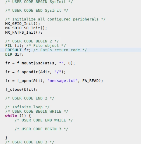

Hey Guys,
I am setting up some STM32F407VETx on a chinese breakout board with �SD-card-slot.
I try to read data from the sd card with SDIO (SD 4 bits Wide bus) and FatFs.
The Basic-Project is build with STM32 CubeMx and programmed in the OpenSTM32 Workbench
My Problem:
The SD Card is ALWAYS in 'FR_NOT_READY'. I am not able to mount  / open / write any data, because the �C is always stuck in the following function:
* @brief Checks for error conditions for R1 response.
* @param hsd SD handle
* @param SD_CMD The sent command index
* @retval SD Card error state
static uint32_t SDMMC_GetCmdResp1(SDIO_TypeDef *SDIOx, uint8_t SD_CMD, uint32_t Timeout)
Because of the timeout in this function i get an errorcode '1' (R/W Error ) in diskio.c
I've tried 3 boards, 3 SD-cards - nothing is broken! I have no clue, what to do...
I am just using the 'basic' fatfs functions, as you can the in the attachment.
Please help me!
Greets!
Ps.: If you need more information, please write some comment!

The code the OP uses in the .PNG attach to the top post
Seem to be some problems with the Cube release
https://community.st.com/0D50X00009XkZk8SAF

Hi Jakob and all,
the issue is that BSP_SD_Init() is not called in the sd_diskio.c file.This is a bug that is going to be fixed in the next release. Could you please modify the generated sd_diskio.c, in particular the SD_Initiaize() function as following and retest?
DSTATUS SD_initialize(BYTE lun)
  Stat = STA_NOINIT;
  if (BSP_SD_Init() == MSD_OK)
    Stat = SD_CheckStatus(lun);
  return Stat;
regards
Haithem.
