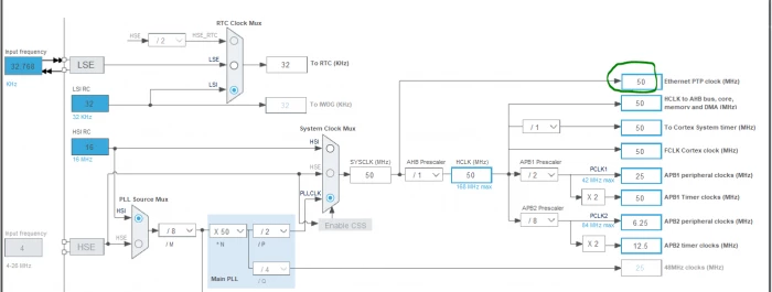

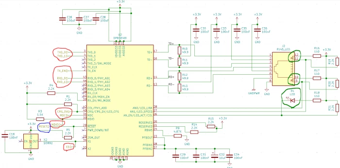

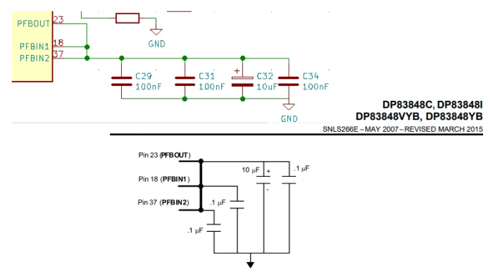

I have an STM32F407 and I'm using LwIP + DP83848 Ethernet PHY. I'm facing problems to ping the unit and I don't know why.

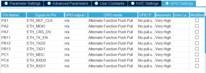

The pinouts for the RMII settings.
Red rings got to the processor. The blue ring shows RESET. It need to be logic 1 (HIGH) for the Ethernet PHY to start. The green ring shows a LED lamp that flashes when something happen on the internet cable e.g I ping an IP-address.

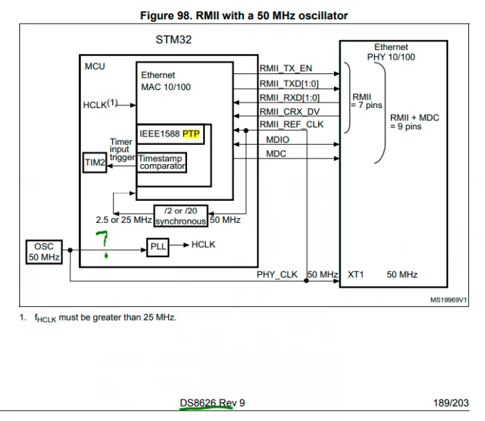

The oscillator is at 50 Mhz and I don't know why it should go inside my processor. This is from the datasheet DS8626 of the ST-microcontroller. https://www.st.com/resource/en/datasheet/dm00037051.pdf
I think this is OK to just write 50 MHz for Ethernet PTP?

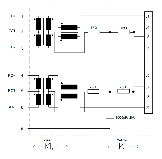

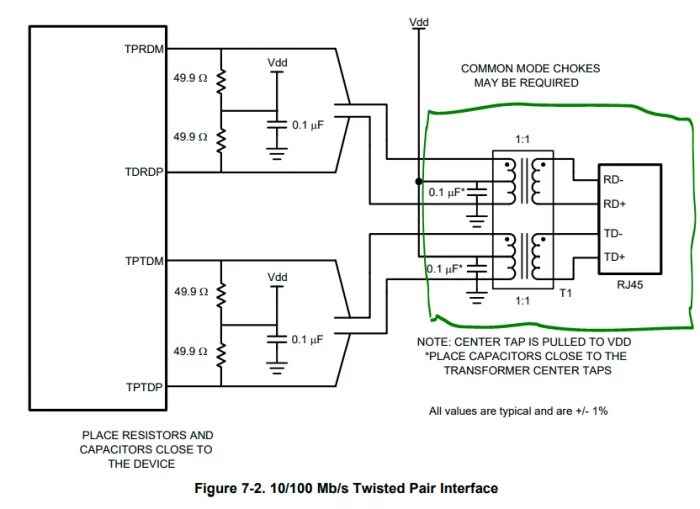

I have connected my RJ45 connector like this

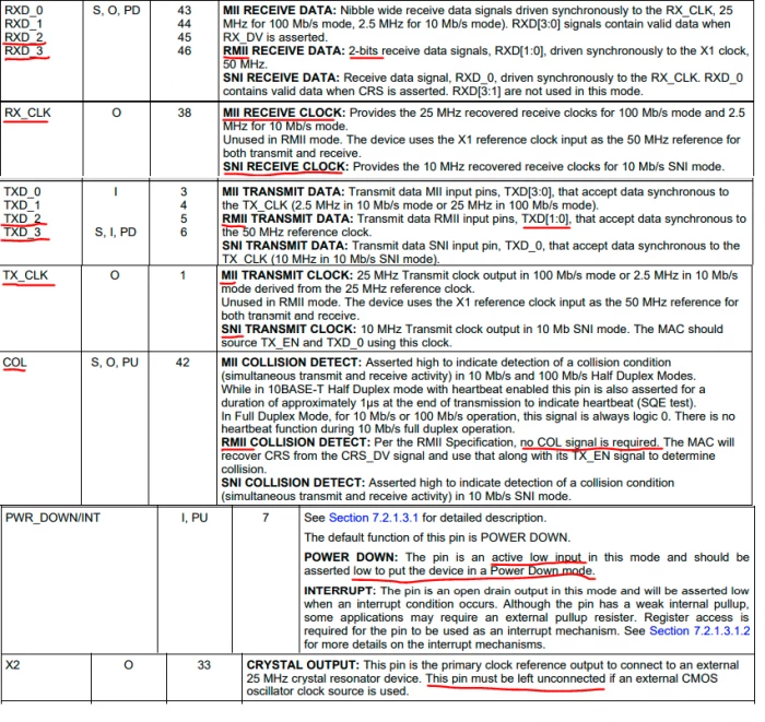

0693W00000LyBBTQA3.pngOther tiny pins of the Ethernet PHY
Pins that are not used are:
Special pinns:
https://i.stack.imgur.com/UszLt.png
Some pins have Pull-up and pull-down. I have pull-downs on all input pins of the ethernet PHY.
https://i.stack.imgur.com/CRwSZ.png

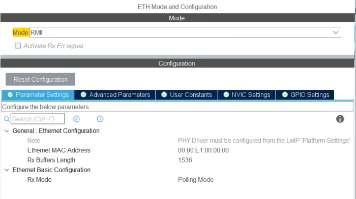

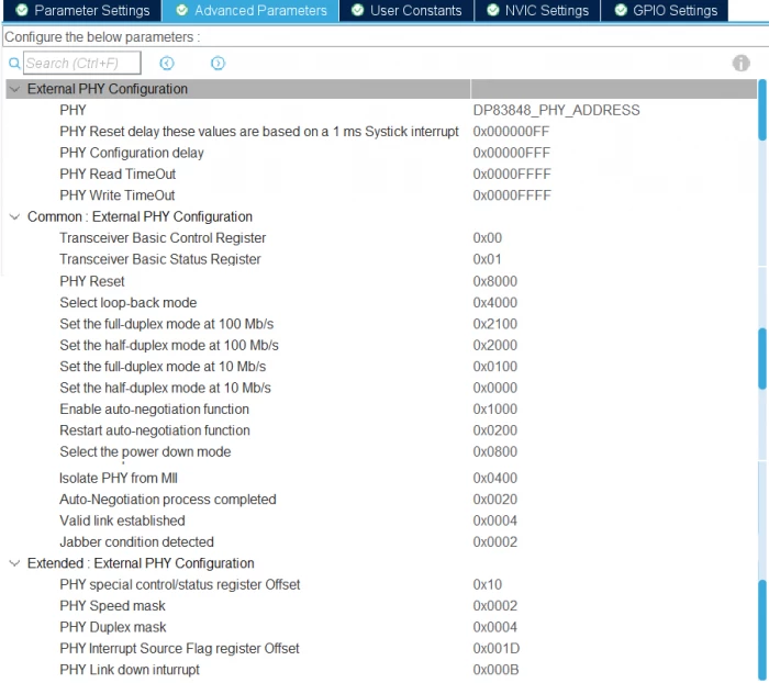

Last picture is the LwIP configuration. Were I select the IP address and the ram address at 0x20014000 with a size of 1600 bytes. My RAM address goes from 0x2000000 to 0x20020000 e.g 128 kB.
https://i.stack.imgur.com/dEliW.png
https://i.stack.imgur.com/HaCJR.png

Only the LED D1 flashes when I ping. So that means the pin LED_ACT/COL at my Ethernet PHY goes from HIGH to LOW when something happening at the ethernet cable. Right?
https://i.stack.imgur.com/7T9ZD.png
https://i.stack.imgur.com/Vphkh.png
Question:
What should I do in STM32CubeIDE to make my processor work with the Ethernet PHY? What have I missed?
  1. If you have a supported ST eval board (Nucleo, Discovery etc): find a ST-provided example for exactly this board. These examples have been created before CubeIDE so you need to convert (import) it to CubeIDE. Make this example build correctly after conversion; do not change anything until it runs on the board.
  2. If you have a custom board with a custom PHY: find a closest eval board and port some example for that board to yours. If this is too hard, find somebody to help.
