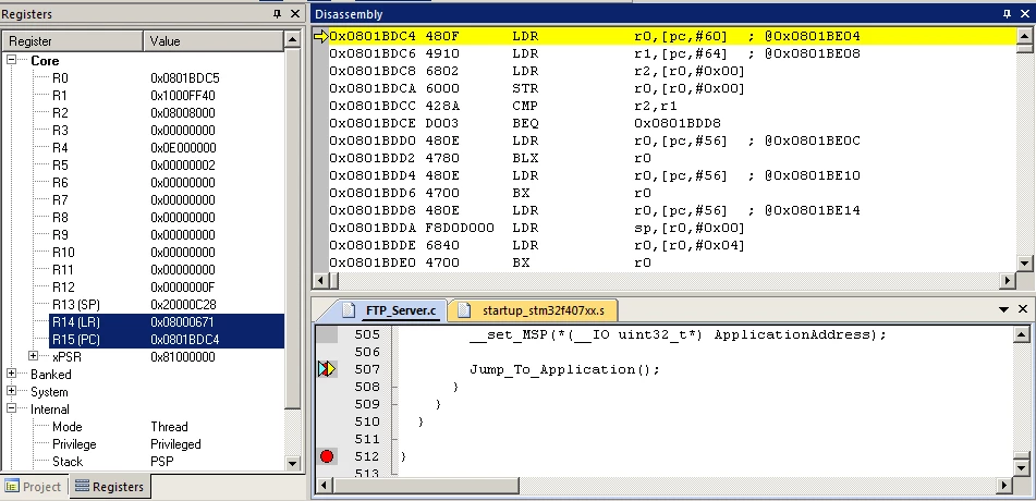

Stack base address on bootloader is 0x20005418;
Stack base address on application is 0x1000f540;
Now when debugging enter in the if condition but doesn't jump to the application, I had put a break point on Jump_To_Application and registers as image attached, but I don't know why this error still occur.

Tesla DeLorean
Guru
June 14, 2016
Posted on June 14, 2016 at 17:38
The registers without the assembler code it is executing really isn't going to tell me much.
What is the ''error'', you need to step through the code, probably in disassembly mode, and understand what it is doing, and what checks are being made. You'll want to step from the loader, into the application, confirming it goes and does what you've coded.
This test is backward if you want to check if the pointer is NULL, it does the test left-to-right, you should check for it being NULL before checking the values it is pointing too.

June 14, 2016
Posted on June 14, 2016 at 20:59
Hello Clive!
I don't know what is the error that occur because all seems to be correct.
I tried to paste disassembly code in attachment.
Thanks for your help again.

Tesla DeLorean
Guru
June 14, 2016
Posted on June 14, 2016 at 22:27
Ok, so it appears to have transferred control to the ResetHandler in the application, to some code that looks rather familiar
