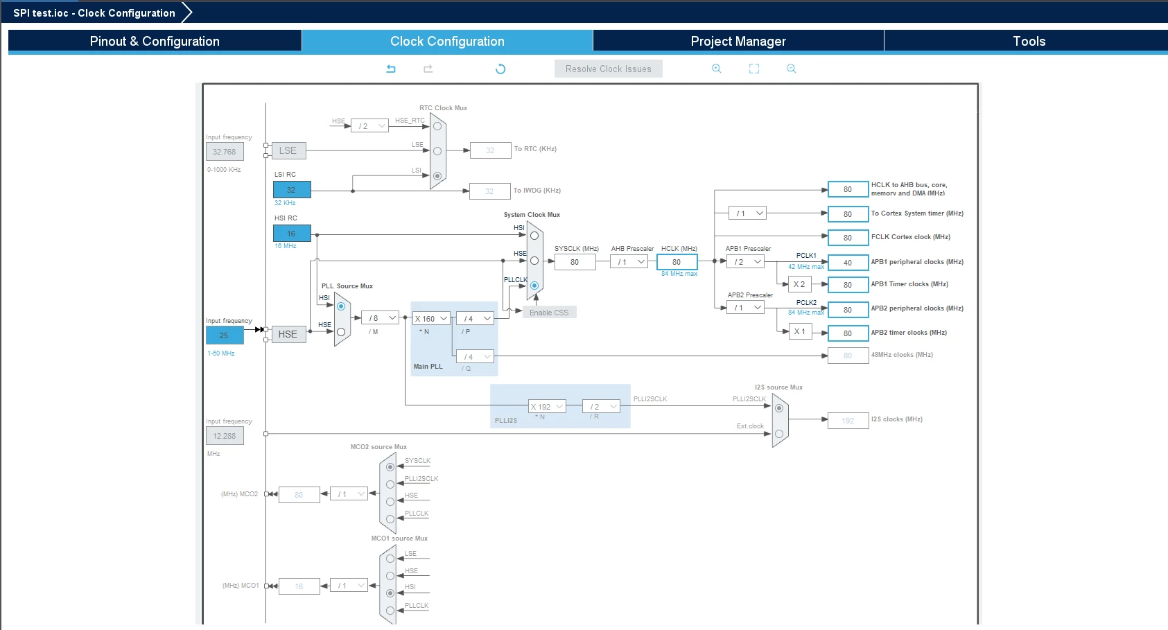

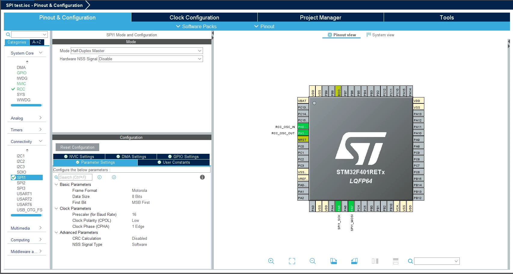

I'm currently working on a project where I need to use the SPI protocol.
After setting everything up in the .ioc file and generating the code. I wanted to check if the clock signal was properly working. So i hooked up my ossciloscop to the clk pin. To my surprise there was nog clk signal being generated.
I've attached a few pictures of the ioc view asswel as the code.
Could you guys help me out on this one?
Kind regards Erik

Nov 9, 2023 7:03 PM UTC
You'll need to be Transmitting something to get clocks.
It would be more helpful to show the code configuring the SPI, peripherals, pins, clocks, and the code transmitting, perhaps a 0x55 pattern, in a continuous loop.

These are the files with the code, i'm trying to build the same project as Controllerstech in this video:
https://www.youtube.com/watch?v=71SRVEcbEwc
Chris21
Nov 9, 2023 7:40 PM UTC
The for loop in this function doesn't look too good...
void ws2812_spi (int GREEN, int RED, int BLUE)
	uint32_t color = GREEN<<16 | RED <<8 | BLUE;
	uint8_t sendData[24];
	int indx = 0;
	for (int i=23; i>=0; i++)
		if(((color>>i)&0x01) == 1) sendData[indx++] = 0b110;
		else sendData[indx++] = 0b100;
	HAL_SPI_Transmit(&hspi1, sendData, 24, 1000);
Tesla DeLorean
Tesla DeLoreanBest answer
Guru
Nov 9, 2023 8:15 PM UTC
Incrementing from 23 to the integer limit. Probably getting a Hard Fault and not getting to the HAL_SPI_Transmit() at all.
Hint: not i++
