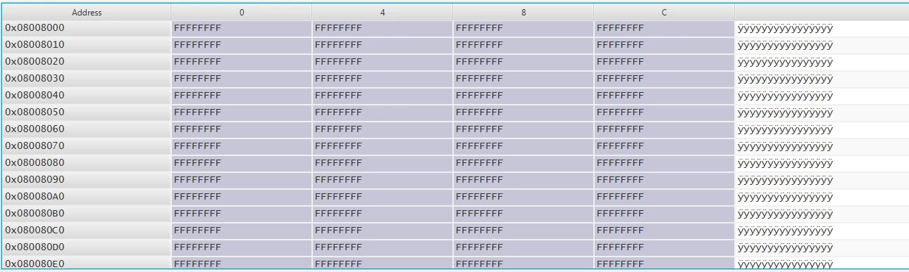

STM32F401 HAL_FLASH_Program not working
Hi community..
I have the following code :
bool FLASH_WriteDoubleWord(uint32_t flashAddress, uint64_t Data)
	FLASH_Unlock();
	/*clear some flag*/
	 __HAL_FLASH_CLEAR_FLAG(FLASH_FLAG_EOP | FLASH_FLAG_OPERR | FLASH_FLAG_WRPERR | FLASH_FLAG_PGAERR | FLASH_FLAG_PGSERR );
	//FLASH_Erase_Sector(2, 2);
	/* Program the user Flash area word by word */
	if (HAL_FLASH_Program(FLASH_TYPEPROGRAM_DOUBLEWORD, (uint32_t)&flashAddress, Data) != HAL_OK)
		FLASH_Lock();
		return false;
	FLASH_Lock();
	return true;
where
static uint32_t address_test = 0x08008000;
static uint64_t data_test = 0xAAAAAAAA;
I don't understand why the erase part is working instead HAL_FLASH_Program it is not writing the data in the expected address.
Can you please tell me why in your opinion?
Thanks a lot.
Simone

Hello @SGasp.1​ ,
The reference manual says:
The write access type (byte, half-word, word or double word) must correspond to the type of parallelism chosen (x8, x16, x32 or x64).
If not, the write operation is not performed and a program parallelism error flag (PGPERR) is set in the FLASH_SR register.
So, check if there is an error with the FLASH_SR register prior to calling HAL_FLASHEx_Erase.

Don't want the address of parameter variable. Need to pass the address as a uint32_t

Without the ampersand '&'​
SGasp.1
SGasp.1Author
Oct 5, 2021 7:22 AM UTC
I tried to remove but nothing to do

Oct 5, 2021 7:16 AM UTC
I changed the code in this way ...
uint64_t Data = 1000;
uint32_t 	address_test = 0x08008090;
FLASH_WriteDoubleWord(address_test , Data);
	FLASH_Unlock();
	/*clear some flag*/
	FLASH_EraseSectors(2, 1); /*working*/
	if (HAL_FLASH_Program(FLASH_TYPEPROGRAM_DOUBLEWORD, flashAddress, Data) != HAL_OK) /*not working*/
		FLASH_Lock();
		return false;
	FLASH_Lock();
	return true;
Nothing to do...
Please help

Oct 5, 2021 9:20 AM UTC
i tried in this way
	FLASH_Unlock();
	HAL_Delay(500);
	FLASH_Unlock();
	HAL_Delay(500);
	if (HAL_FLASH_Program(FLASH_TYPEPROGRAM_BYTE, (uint32_t) flashAddress, Data) != HAL_OK) /*not working*/
		Turn_on_red_led();
		FLASH_Lock();
		return false;
	FLASH_Lock();
	return true;
Now I don't get the erro from HAL but when I check the flash the values is not written as expected.

Read the relevant sections of a reference manual? RM0368 section 3.5.2 explains your "problem" very clearly.
