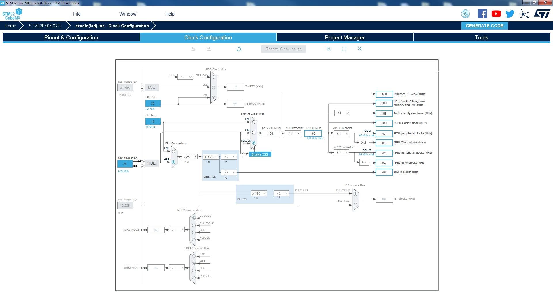

Thank you for the advice. I followed step by step the example "USB Custom HID Device lab", but when I connect the board to the PC it is detected as "Unkonwn Device" and if I try to open the HID terminal, it is shown the message "Failed to open device". Any suggestion? I am stuck on this part of my project...

I will gladly try to help you, but I will need more information from you about your HW setup. For start what MCU are you using and are you using embedded pull-up or external one? Also how do you clock your USB peripheral? Are you using external high speed oscillator? If you are using MCU for which there will be ready to use example within the STM32CubeF4 FW package I would maybe recommend to try this example so you exclude HW related problems. I will wait for your answer.

Hello Petr. The MCU is STM32F405ZGT6. In the GPIO settings on Cube I selected no pull up and no pull down. This is the clock configuration.0693W00000AOZeJQAX.pngIn the  STM32CubeF4 package there are no examples for boards with the same MCU. What could be the most similar to the one that I am using?
