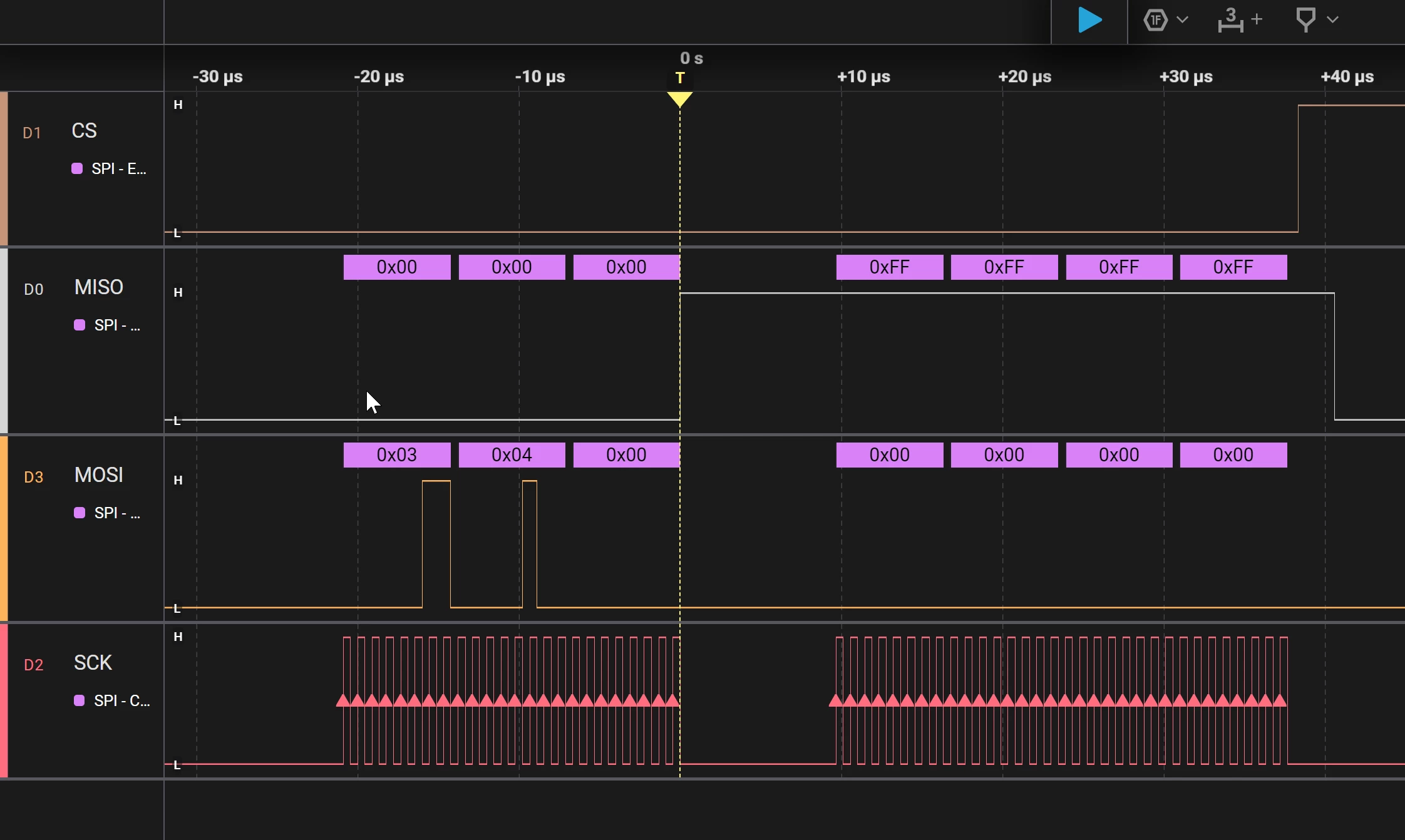

I am using a STM32F427 to read and write data to EEPROM Serial 256-Kb SPI
CAT25256. I use LL API, and DMA full-duplex over SPI. I manage myself the Chip Slect signal.
I can see with logic analyser that datas are sent and received to/from EEPROM correctly.
But I do not have interruption from DMA, neither input or outputstream.
I do not understand why.
The only way to detect the end of the transfer is to look at the BSY flag LL_SPI_IsActiveFlag_BSY(pSPI_Instance). Could-you help me to find where is the problem?

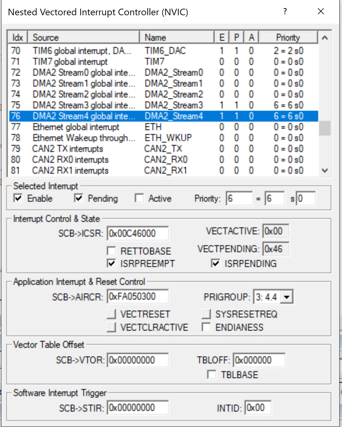

FWXAuthor
Aug 19, 2024 9:00 AM UTC
Because I set an indicateur in the interrupt handler, and my main loop is waiting for this indicator to change.
I also put a breakpoint in the interrupt handlers, for both input and output stream, but never stopped.
But I can see the transfer complete flag set in interupt status register when I stopped the code.
See capture screen image attached.
waclawek.jan
Aug 19, 2024 9:39 AM UTC
Interesting.
I don't use FreeRTOS so can't help with this further, sorry.
