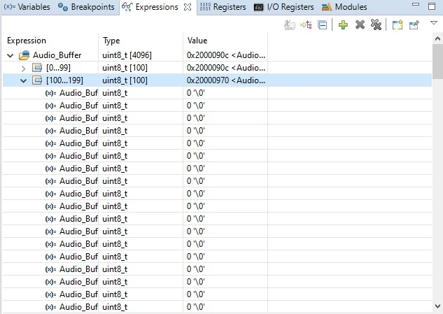

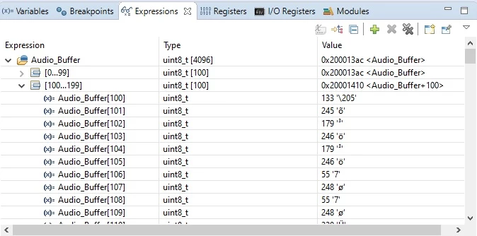

Hello everyone! I'm working on a project like Audio Playback. I have tried compile and run Audio_playback_and_record from ST's Firmware pack its working good.
I'm trying create my own project file, i'm stuck in read wave data from usb. I can get waveformat data but i cant get audio data.
I have tried debug results are bellow;
Audio_playback_and_record inside audio buffer data;
And my own project inside audio buffer data;
As you can see there is always '/0' except 0-99 indexes(that's include audio format data like wave, riff.)
I attachted my project file. Please help me.

I mean, i can get waveformat data from file(FileSize, Byterate, Samplerate.. etc) but when i want read audio data i getting just zeros
