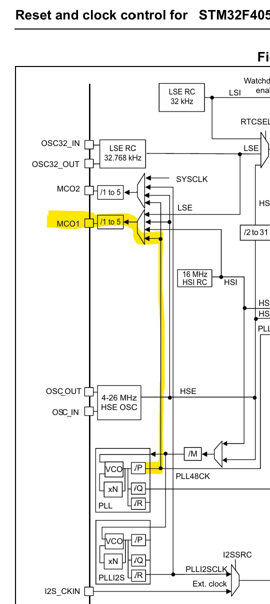

On STM32F4, when you choose PLLCLK as the MCO1 source, does the HAL actually routes the PLL output going into SYSCLK, i.e. after the PLLP division?

 HAL_RCC_MCOConfig(RCC_MCO1, RCC_MCO1SOURCE_PLLCLK, RCC_MCODIV_1);
TDKBest answer
Jul 3, 2025 1:45 PM UTC
Per the reference manual, yes. It outputs PLLP. This may or may not be SYSCLK, depending on the system clock mux.
