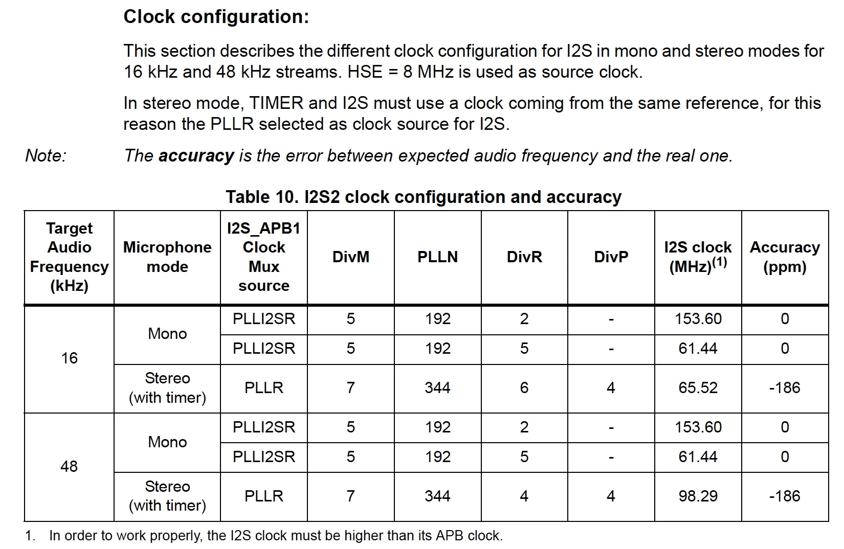

After reviewing AN5027 (interfacing with PDM mics), I noticed it says for stereo I must use PLLR for the I2S clock source, not PLLI2SR (see table below).
I'm trying to follow the recommendations in the table for 16Khz Stereo, but I can't work out how to set this in a way that doesn't cause havoc with all the other peripherals and MCU?

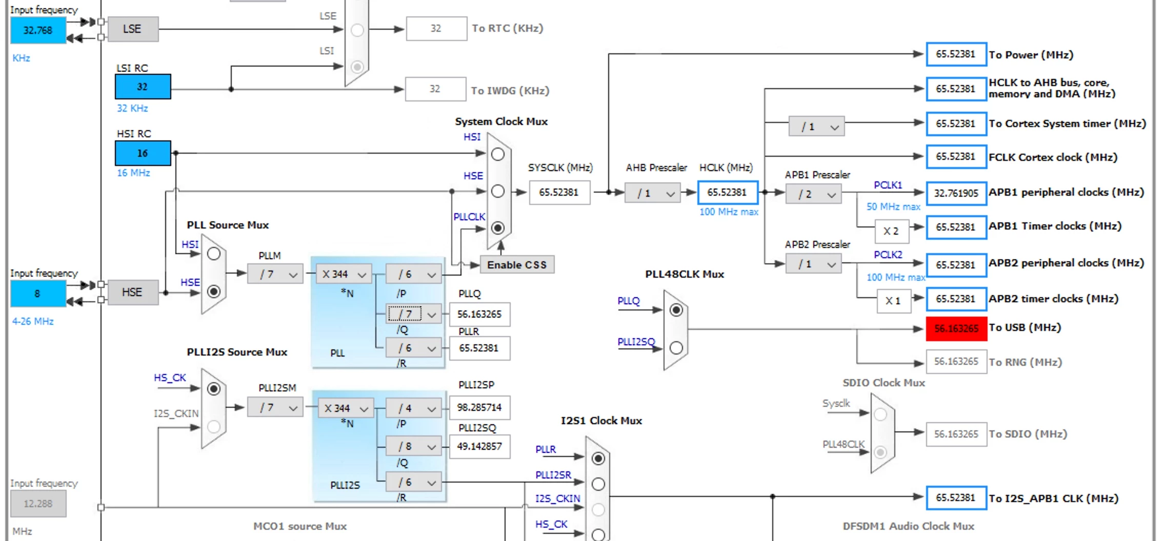

I've got my attempt at clock setup, using PLLR instead of PLLI2SR for "I2S1 Clock Mux".
Does anyone have advice on how to interpret this requirement and setup my clock config to suit stereo PDM, USB and a good (>80Mhz hopefully) MCU supply clock?

In this particular mcu, if you don't use the PLLI2S for I2S, you can use it to generate the 48MHz for USB; it's trivial from the 8MHz crystal (divide by 8, multiply by an integer multiple of 48 so that result fits into VCO range, divide by the same integer to drop to 48MHz, done).
With the given constraints of PLL/VCO, there's no way to achieve a perfect 16kHz x 64 = 2.048MHz mic clock (i.e. integer multiple of 2x2.048MHz (PLL divides its input by 2x(2xI2S_DIV+ODD) to the bitclock if MCO is not used) as R output of the PLL going to I2S) while having >80MHz system clock. But why don't you use a more suitable crystal, e.g. the fairly common 12.288MHz (or 24.576MHz = 2 x 12.288MHz)?
12.288MHz (HSE) / 8 (PLLM) = 1.536MHz (PLL input freq)
1.536MHz x 128(PLLN) = 196.608MHz (VCO output freq)
196.608MHz / 2 (PLLP and PLLR) = 98.304MHz (both to SYSCLK mux and to I2S)
98.304MHz / 2 / 24 (I2S_DIV) = 2.048MHz bitclock
and for USB
12.288MHz (HSE) / 8 (PLLI2SM) = 1.536MHz (PLLI2S input freq)
1.536MHz x 125 (PLLI2SN) = 192MHz (PLLI2S VCO output freq)
192 / 4 (PLLI2SQ) = 48MHz (to USB)
Using the same divider for P and R would also remove any doubts about possible audible artefacts even if the timer's clock comes from the same PLL VCO, but is divided differently than the I2S clock.
