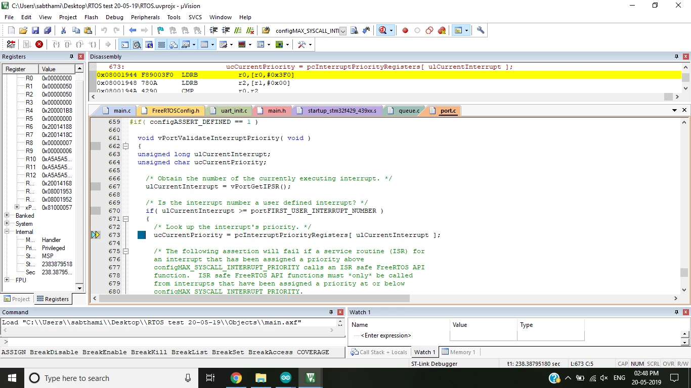

Hi guys
Can any one provide me how to use queue inside UART ISR receive interrupt....
I have tried it using some web search but I couldn't achieve it can any one provide me the working example. below, I have attached my code and the image where my code got struck any one help me to find out the solution to my problem Iam using keil ide with FreeRTOS and stm32f429igt6 controller

RobGeografo
May 18, 2023 4:30 PM UTC
@AChan.15​ did you get this resolved eventually? I am facing a similar issue
Bob S
May 18, 2023 5:22 PM UTC
Post your code, explain what you are TRYING to do, what steps you've taken to debug it and what is or isn't happening. The code from the original post is so horribly broken it isn't worth referencing.
And using an RTOS queue for incoming UART data SOUNDS like a good idea but isn't always the best approach.
