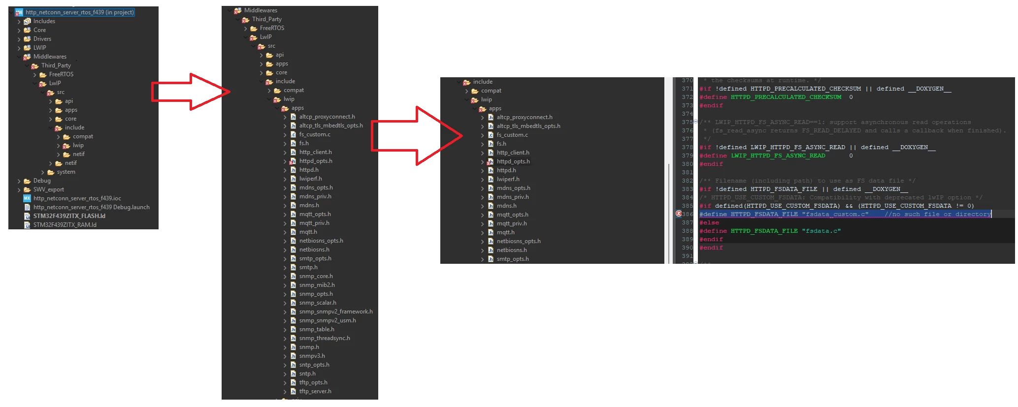

Feb 4, 2025 5:04 AM UTC
I am getting the above error in the code. Don't know why it is happening? @STea

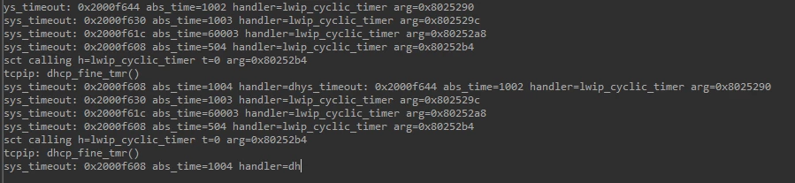

Feb 5, 2025 6:17 AM UTC
@STea Tried using cloning and I think it is because of the version mismatch, the error previously. No error and code compiled but I am getting the below in the ITM.
Kindly help me resolve this issue!

Feb 11, 2025 10:09 AM UTC
Hello @vbk22398 ,
 you can disable ITM as you don't need it in your case and try the example out this can be done by commenting LWIP_DEBUG in lwipopts.h.
Regards
