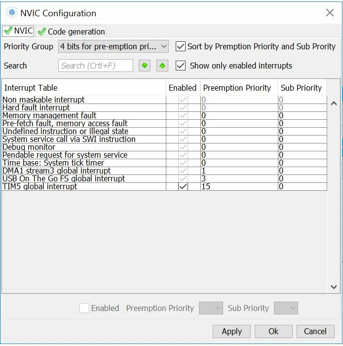

Posted on December 14, 2016 at 12:17
Here is my NVIC table. But it doesnt matter what settings i make. I tried new approach: I got rid of subpriority, now i am using only preemption priority. I have tried SPI_DMA priority set to 0 and USB set to 1... AlsoUSB 0 and SPI_DMA 1. Doesnt matter.
Another Courious thing is: That when i put break point to part, where f_write is called, when i get there, i put another breakpoints to IRQ's and hit ''unpouse'' then i can observe that program goes into DMA IRQ (data from microphone ready), then program goes intoOTG_FS_IRQ , then i can see it goes back to DMA IRQ and it stucks here ... exactly in the PDM library.
I even made an experiment where i light up orange LED right before program enters into PDM filter function, and turn off right after program returns from PDM filter function returns. It always get stucked with my orange LED lighting. That means program really get stucked inside that function that is part of STMs static library.
Now please can anyone tell me, how this pdm func can be influenced by fatfs write to USB? I have no clue ...
Also, why STM can not provide us with .c file for the PDM library?!!!! Then i could easily build it on my own with whatever HW/SW floating point settings i want and i could observe my program stucking inside that library! But with that static library it is not possible!
