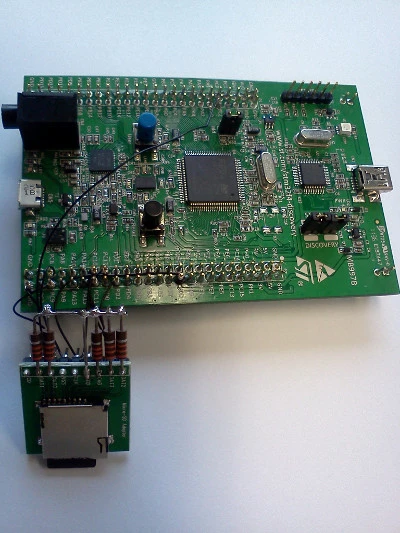

My current GNU release for the STM32F4-Discovery USB MSC for an external SD Card is attached to this post.
/public/STe2ecommunities/mcu/Lists/STM32Discovery/Attachments/2816/stm32f4_discovery_msc_sdhc_release_3.zip
See also
[DEAD LINK /public/STe2ecommunities/mcu/Lists/cortex_mx_stm32/Flat.aspx?RootFolder=/public/STe2ecommunities/mcu/Lists/cortex_mx_stm32/ST32f4discovery%2Bsdcard%2Bfatfs problem&FolderCTID=0x01200200770978C69A1141439FE559EB459D7580009C4E14902C3CDE46A77F0FFD06506F5B&currentviews=568]https://my.st.com/public/STe2ecommunities/mcu/Lists/cortex_mx_stm32/Flat.aspx?RootFolder=%2Fpublic%2FSTe2ecommunities%2Fmcu%2FLists%2Fcortex_mx_stm32%2FST32f4discovery%2Bsdcard%2Bfatfs%20problem&FolderCTID=0x01200200770978C69A1141439FE559EB459D7580009C4E14902C3CDE46A77F0FFD06506F5B¤tviews=568
