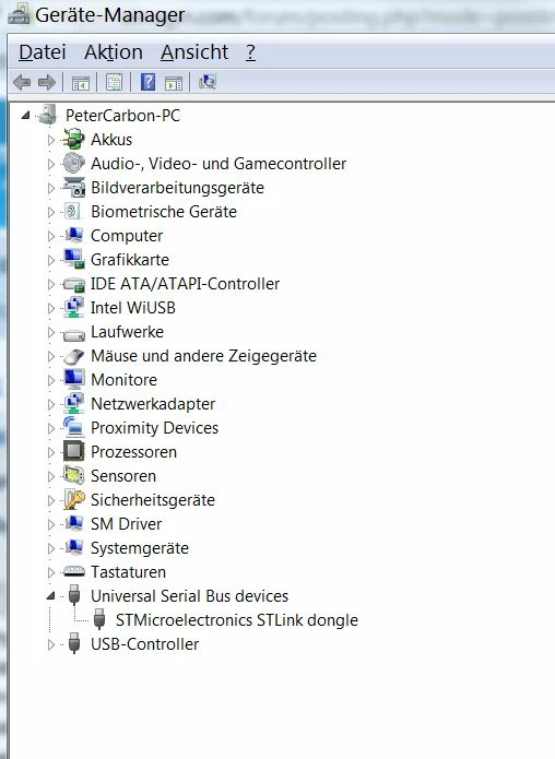

Hey,
i have a problem to connect the SMT32F4-discovery Board as a vcp device on my laptop. The board is detected as a USB device but i can not connect it as a vcp device.
I have installed the Stm32 st-Link Utility and tried the stm vcp driver and the FTDI Diver but it did not work.
Is there any other Software i have to instal?
I read that there is the StLink/V2 on the Board. Does this debug tool support vcp?
best regards
Peter
NO.
VCP is availible only on STlink V2-1.

Posted on February 03, 2016 at 18:36
The NUCLEO boards, and some of the newer DISCO (mbed enabled) boards support a VCP via the debugger's USB connection.
For the old STM32F4-DISCO you'd need to compile a USB firmware for the F407 and connect via CN5 (micro USB)

I'v connected it via Micro-USB (CN5) and it works now.
Thanks for your help!!!!
