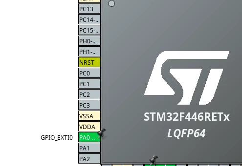

I have connected a sensor to my nucleo board to send data when sensor detects movement.
I have introduced an ISR for that.
void HAL_GPIO_EXTI_Callback(uint16_t GPIO_Pin)
if (GPIO_Pin == GPIO_PIN_0)
pirDetected = true;
unfortunatelly with that approach everytime the sensor was triggered ( I was able to measure 3.3v on the OUT pin using voltmeter) my stm32 is kind a freezing.

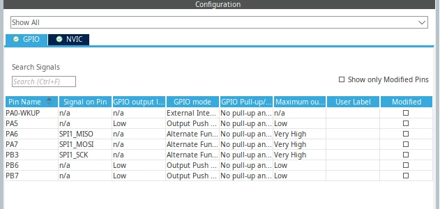

  /*Configure GPIO pin : PA0 */
GPIO_InitStruct.Pin = GPIO_PIN_0;
GPIO_InitStruct.Mode = GPIO_MODE_IT_RISING;
HAL_GPIO_Init(GPIOA, &GPIO_InitStruct);
/* EXTI interrupt init*/
HAL_NVIC_SetPriority(EXTI0_IRQn, 0, 0);
HAL_NVIC_EnableIRQ(EXTI0_IRQn);
with that my LED is on for about 5-6seconds and after that goes off, even when I am triggering the sensor, no reaction on led.

oh, my goodness ! I messed up  …
I had generated the code with ISR in CubeMX, but I am writing not in .c but .cpp, and I had my new file generated with ISR as .c file, but I am using g++ compiler for .cpp
Thanks everyone for support :(

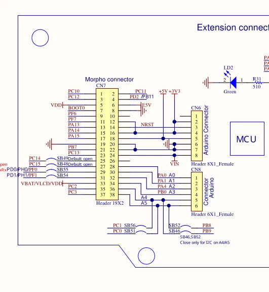

unfortunately setting priority to 1 or 15 didnt help, I have tried to directly connect PA0 to 3.3v and GND with test code below, but dont see any reaction. If I start whit PA0 connected to GND, then my LED stays off all the time even if I connect to 5v afterwards. If I start with PA0 not connected, then my LED stays on even if I connect PA0 to GND … That is strange..
I am using Pin 18->5v, 20->GND and 28->PA0

Your Callback should clear EXTI_PR (Pending register).
If you can’t debug, it is very difficult find these SFR value.
