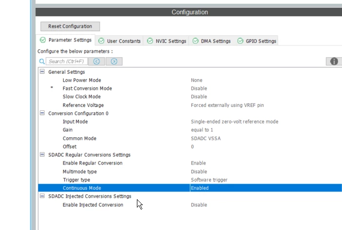

 I tried to use the HAL_SDAC functions to read two Analog signals (0-3.3V) with DMA but I didn't have good results.
That's why I started reading only one Analog signal in Polling mode (ING 5)....unfortunately even in this case I always read zero (AD_result=0)
I am using the STM32F373 and STM32CubeIDE.
Any good ideas?
My configuration:
The code in main.c:
MX_SDADC1_Init();
HAL_SDADC_CalibrationStart(&hsdadc1, SDADC_CALIBRATION_SEQ_1)
HAL_SDADC_PollForCalibEvent(&hsdadc1, 10);
HAL_SDADC_SelectRegularTrigger(&hsdadc1, SDADC_SOFTWARE_TRIGGER);
HAL_SDADC_AssociateChannelConfig(&hsdadc1, SDADC_CHANNEL_5, SDADC_CONF_INDEX_0) ;
HAL_SDADC_ConfigChannel(&hsdadc1, SDADC_CHANNEL_5, SDADC_CONTINUOUS_CONV_OFF);
HAL_SDADC_Start(&hsdadc1);
while (1){
HAL_SDADC_PollForConversion(&hsdadc1, 100); // Poll ADC1 Peripheral & TimeOut = 1mSec
AD_result = HAL_SDADC_GetValue(&hsdadc1); // Read ADC Conversion Result

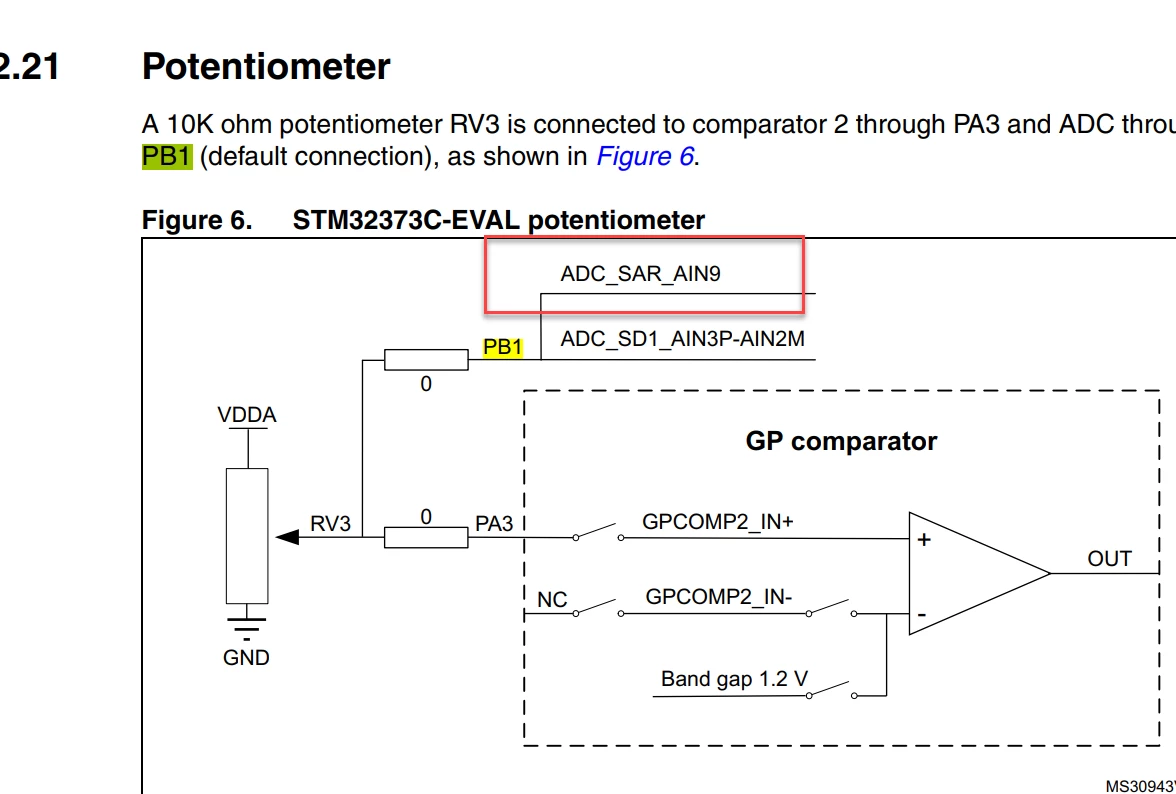

May 15, 2024 2:07 PM UTC
I am using the ST demo board STM32373C-EVAL and the PB1 GPIO pin with the potentiometer.
The Vref is good..:grinning_face:

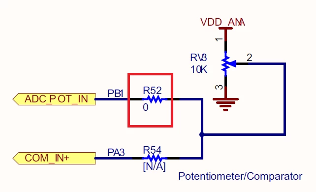

mƎALLEm
May 15, 2024 2:14 PM UTC
Check R52 0 ohm resistor,  already soldered?

news...it seems if I do START and STOP of conversion whenever on the while loop the AD_result  is changing
while (1){
HAL_SDADC_Stop(&hsdadc1);
This even though I put continuous mode ENABLE:

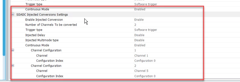

VeroAuthor
May 17, 2024 7:53 AM UTC
news... 2 analog signals ( injected conversion mode) with trigger software (no timer) and NO DMA is working....
 in MAIN:
MX_SDADC1_Init();
if( HAL_SDADC_CalibrationStart(&hsdadc1, SDADC_CALIBRATION_SEQ_1)!= HAL_OK)
/* Start injected conversion in interrupt mode */
if (HAL_SDADC_InjectedStart_IT(&hsdadc1) != HAL_OK)
void HAL_SDADC_InjectedConvCpltCallback(SDADC_HandleTypeDef *hsdadc)
/* Get conversion value */
if(ch==1)
measurements_SDADC[0] = HAL_SDADC_InjectedGetValue(&hsdadc1, &ch);}
else{
measurements_SDADC[1] = HAL_SDADC_InjectedGetValue(&hsdadc1, &ch);
Now I will try whit DMA and timer trigger

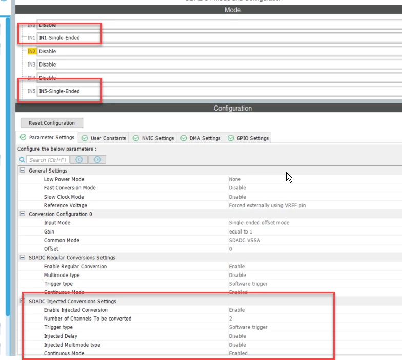

VeroAuthor
May 17, 2024 7:55 AM UTC
The configuration for the previously example (2 analog signals ( injected conversion mode) with trigger software (no timer) and NO DMA)
