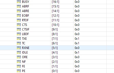

Unfortunately register level coding comes with responsibility to debug it yourself, and go over the register definitions to understand the reported conditions when it fails.
Is there a Noise or Framing type error blocking further reception? If the source of the interrupt is not cleared it will keep reentering.
Confirm the UART2 is outputting successfully by sending a diagnostic message as the code starts.
Also
TIM3->SR = ~(TIM_SR_UIF); // Just write the mask, don't do the RMW &=
February 24, 2025
@Tesla DeLorean At the beginning of the program execution, I successfully sent the letter. However, the USART is not receiving the letter I am sending for interrupt. The registers in SRFs debugger mode do not show any Noise or Framing type error blocking further reception.image.pngimage.png
