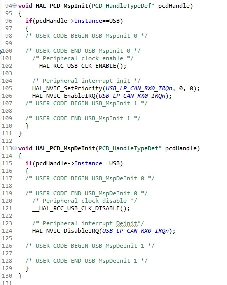

Bench
September 20, 2018
Hi @Imen DAHMEN​
thank you for the recommendation. I already did that. Unfortunately it still doesnt work. Above is the Cube file I use and the generated code doesnt include the GPIO Config for the pins. So I think there might be a bug in Cube. The Code looks also different if I generate an USB project for the L4 for example. There the Pins are configured and the functions are not empty as in the COde for F303ze. Could that be?
Thanks a lot and best regards

Bench
September 21, 2018
Hi @Imen DAHMEN​ ,
thank you for the advice, that there is a new version of Cube. However, I get the same problem and the MSP_init functions are still empty and the initialization of the Pins is still missing as you can see in the attached file.

September 25, 2018
Hello @Bench​ ,
You are right, I confirm that using STM32CubeMx (version 4.27.0), the MspInit functions are empty and there is no GPIO Configuration for STM32F303 and STM32F302.
This issue is raised internally to CubeMx team for fix.
Thank you for bringing this issue to our attention.
