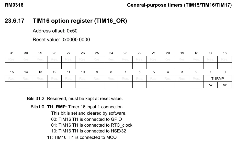

1. Issue description
The TIM16 peripheral includes the OR register at offset 0x50, but its SVD definition does not contain any <fields> element:
<register>
<name>OR</name>
<displayName>OR</displayName>
<description>option register</description>
<addressOffset>0x50</addressOffset>
<size>0x20</size>
<access>read-write</access>
<resetValue>0x0000</resetValue>
</register>
2. Reference manual
According to RM0316 Rev. 10, Section 23.6.17, page 767, the TIM16 option register contains the following field:
  • Register: TIM16_OR
  • Address offset: 0x50
  • Field: TI1_RMP[1:0]
  • Bit positions: [1:0]
  • Access: Read/write
  • Bits [31:2]: Reserved
The field selects the input source for TIM16 channel 1:
Value Input source
00 GPIO
01 RTC clock
10 HSE/32
11 MCO
Official reference manual:
https://www.st.com/resource/en/reference_manual/DM00043574.pdf
3. Suggested correction
The following field definition could be added to TIM16.OR:
<fields>
<field>
<name>TI1_RMP</name>
<description>Timer 16 input 1 connection</description>
<bitOffset>0</bitOffset>
<bitWidth>2</bitWidth>
</field>
</fields>
Could you please confirm this discrepancy and forward it to the team responsible for maintaining the official STM32F3 SVD package?
If confirmed, could you also provide an internal tracking ticket number and consider including the correction in a future SVD release?
Thank you for your support.

Hello ​@shandianchengzi and welcome to the community,
Thank you for bringing the issue to our attention. I reported this behavior internally.
Internal ticket number CDM0066786 (This is an internal tracking number and is not accessible or usable by customers).
Thank you.
