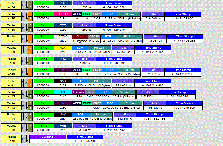

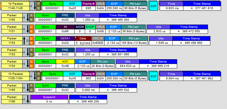

I'm using STM32F217IGH and I'm stuck on a problem with USB FS in host mode.
When I'm connecting
Low Speed
devices through Full Speed hub,  during enumeration, the core generates a port disabled interrupt. The reference manual suggests a port babble error, but i don't know why this is happening. The problem does not ocuur with Full Speed devices.
My USB analyzer shows that the last packet send by a host is always PREamble packet (i've attached some screens from analyzer).

It looks like a silicon bug of built-in host scheduler:
After the host puts PRE token at very near to the end of frame, the host is suddenly aware that there remains insufficient period in the frame, for following LS packet. And then, the host stops all bus activity, because of this error.
I recommend you to contact to ST's support on this issue. This issue isn't seen on the errata.
Your bus traces are enough to tell what occurs here.
Unfortunately, no host register is exposed to tune the schedule timing in a frame.
If there would be anything for us to deal with this bug, every LS transaction over hub is registered to the host at SOF interrupt, so that the host puts the transaction in early stage in the frame.
