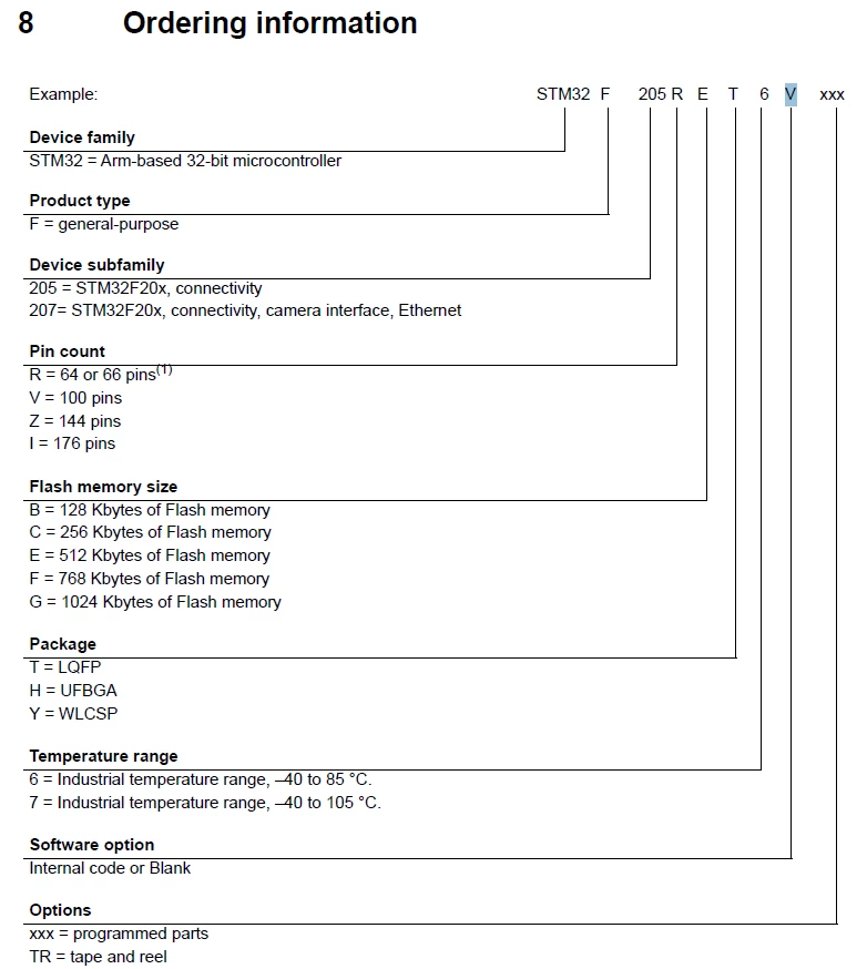

In my Project i need to update firmware from USB. I wrote a code that when i send a command (a determinated string) from my PC to my board by USB, the code jump from my application to the bootloader address so i can update my firmware and using the DFU Bootloader.
My code works well with the demo board STM32F207-NUCLEO but the same code doesn't work with my custom board (i think that in my custom board, code jump to booloader but then it restart and return in my application code).
The marking on the chip of my Nucleo is: STM32F207GT6U
in my board is: STM32F207GT6
It could be a chip revision problem? What means the last letter 'U' on Nucleo Chip ? What means: "Software Option" on Ordering information code (see Figure) ?

Aug 24, 2023 1:09 PM UTC
Okay, so perhaps a hardware issue? But your custom board initializes and uses USB okay? Can you share the schematic? Does your custom board use HSE with an appropriately valued crystal?
The "U" suffix is a part number that is only found on ST boards. I believe it's due to a licensing issue, but it's the same chip as the non-"U" version and isn't the source of the problem. Lots of threads on this, none with definitive answers from ST as far as I can see.

Aug 25, 2023 2:30 PM UTC
> I have a crystal oscillator 8MHz : ECS-250-18-30-GM-TR and 4.7pF capacitor.
This is a 25 MHz crystal, not 8 MHz, and 4.7pF is certainly not the right load capacitor for it, should be closer to 25 pF.
