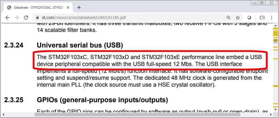

Andrew Neil
Aug 13, 2019 12:36 PM UTC
The datasheet tells you that it has USB Device:
So that's not Host (nor OTG).
Nimit Vachhani
Aug 14, 2019 5:36 AM UTC
Checked... It will not work as usb host device. I will work as usb device when connected with the compatible operating system. It uses bulk transfer method...
