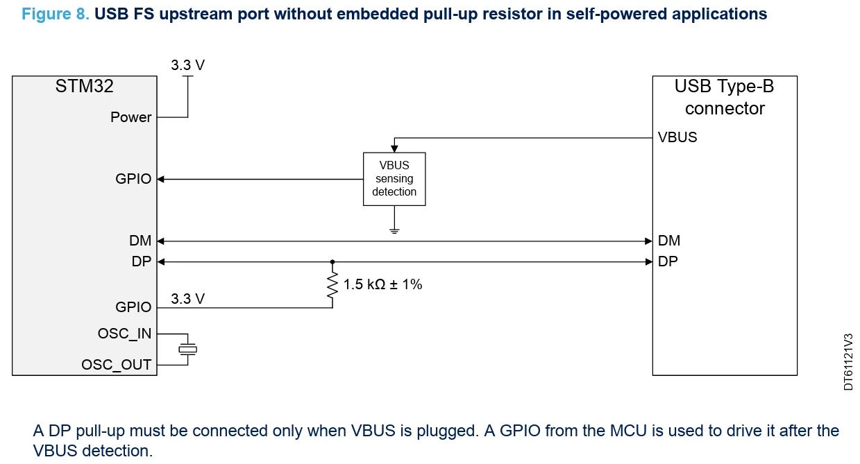

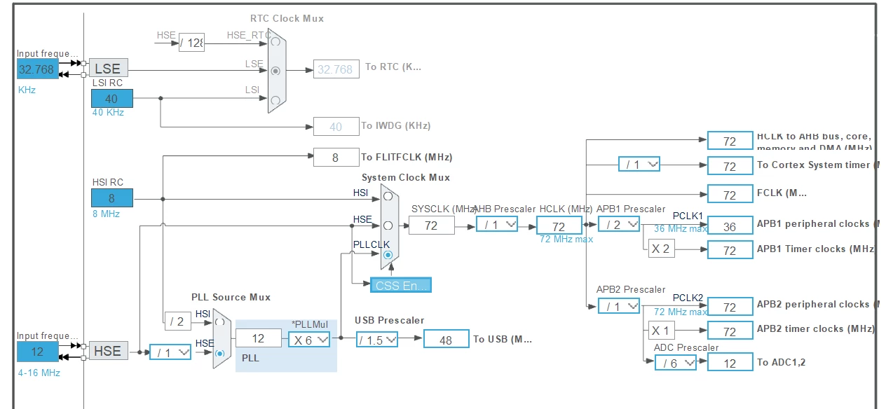

I have a problem with communication between my PC and MCU. I have connected my project according to this diagram (with external 12MHz oscillator):

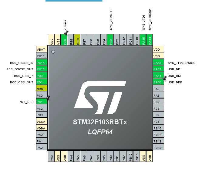

I attempted to connecting the 1,5k GPIO pin (PA10) to control the pull up. Then I connected a 1,5K resistore to 3V3.
Additionally, I experimented with connecting the VBUS with resistor devider (33k and 82k) to the PA9 and then I tried to connecting VBUS directly to PA9.

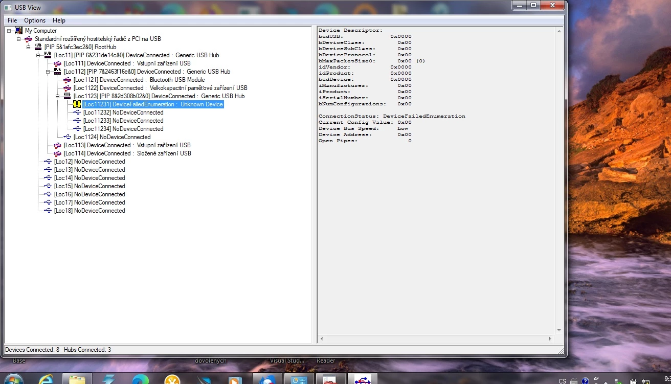

Same result: DeviceFailedEnumeration : Unknown Device.
Do you have any idea why this enumeration issue is occurring?

Mar 13, 2025 1:31 AM UTC
Hardware USB analyzer is your friend. It will show what the host sends and how the STM32 responds. Trace messages in the STM32 device firmware can be helpful too.
