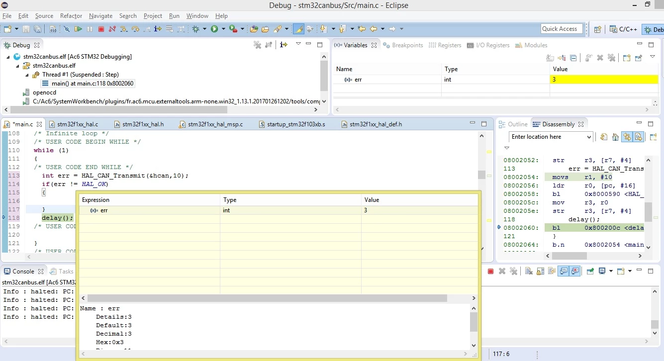

Stm32F103C8X HAL_CAN_Transmit(&hcan,10) not working, always return HAL_TIMEOUT and HAL_ERROR
Posted on March 02, 2017 at 11:56
I am programing STm32F103 for Transmitting CAN data. Initialization of can  is done by following function with 250kb bit rate

and for transmitting data I used following function is main
while (1)
     int err = HAL_CAN_Transmit(&hcan,10);
      if(err != HAL_OK)
      delay();
err always get HAL_TIMEOUT then after some time HAL_ERROR. I receiving CAN data on Arduino but their is no data on CAN TX. I try to check signals on Oscilloscope its shows fluctuation on first time execution of HAL_CAN_Transmit(&hcan,10).

Posted on March 21, 2017 at 08:37
My problem get solved. It actually I am providing 3.3v power supply to CAN driver which is not up to the working voltage of MCP2551. CAN library is working fine.
