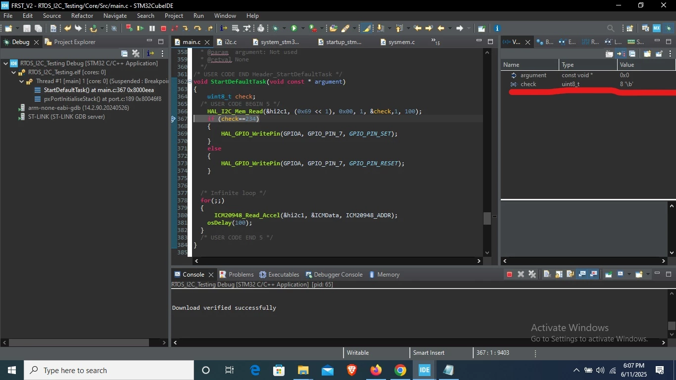

Piyoosh
PiyooshAuthor
June 11, 2025
Thanks for responding
I am using only one task in setup.
this line --- HAL_I2C_Mem_Read(&hi2c1, (0x69 << 1), 0x00, 1, &check,1, 100); is properly return check value "234"(0xEA) in bare-metal (non-RTOS) project which is show that sensor is available  to read data, but in RTOS project (i include Free Rtos code bellow) it is reading 8 value of check.Screenshot (213).jpg

mƎALLEm
June 11, 2025
You need to probe what is going-on on the bus using an oscilloscope or a logic analyzer.
You need also to refer to the sensor datasheet to know what that "8" value means!
Try also to declare uint8_t check; global and test.
