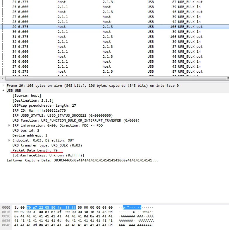

I'm writing a code for stm32f103c8t6 to perform a kind of USB->SPI bridge.
USB periph configured as Virtual COM, based on the VCP example.
USB library I'm using is USB-FS-Device-Lib.
USB on the STM is configured for Bulk transfer, using 64-byte Receive_Buffer. So, according to USB specification, the host shouldn't send packets with length more than 64 bytes. But..

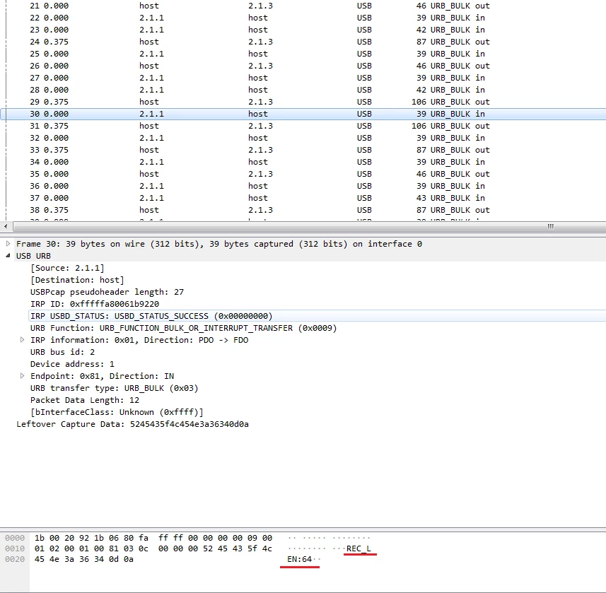

When I send data through USB to the STM, I'm also monitoring the bus with WireShark, and, on the receiving side, I wrote a simple counter data_size that counts the incoming data and then it's being sent back to the host at the end of reception. Also, I'm monitoring the Receive_length.
So, the issue is that everything works fine as long as the host sends packet of length no more than 64 bytes. But sometimes occasionally it decides to send more, for instance, 79 bytes: 0690X000009Yg4dQAC.png
And the STM responds with Receive_length = 64, i.e. it just cuts the data length resulting in data loss.
And, what's interesting, the USB on the STM's side doesn't raise any flags, like PMAOVR or whatever. It just cuts the data length, resulting in data loss.

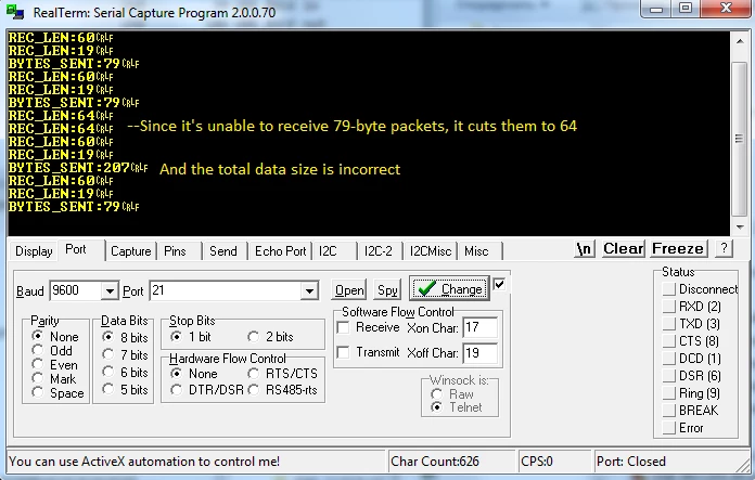

Here's what I see in the terminal:
I'm constantly sending a 79-byte file each 200 ms. Sometimes it works correctly, sometimes not.

The program receives a file with a '*' character(indicates end of file) in the end. It sends current Receive_length value back to the host, then adds it to the data_size var and searches for the '*'. When it reaches the end of file, it sends back its total size.
The Receive_length is updated in EP3_OUT_Callback function each time the USB_CTR interrupt is generated.
I just can't understand why does the host send me more than 64 bytes sometimes and how to deal with it.
