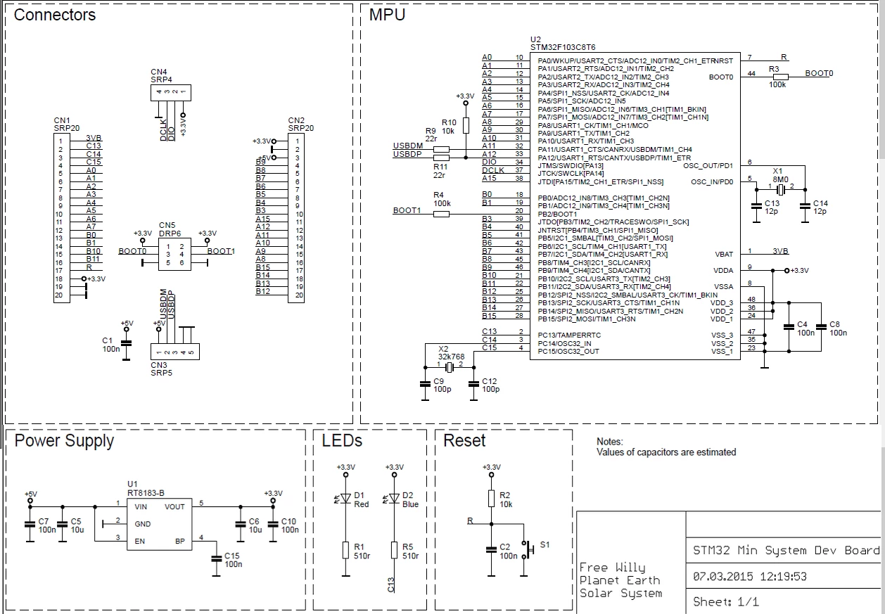

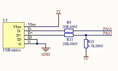

On this moment I'm using a Blue Pill board that have also a
STM32F103, the only difference is that the PA12 is connected to 3.3V through a 10K resistor as you can see in the image below:
I decided to ''port'' the example that is provided with the HAL using the CubeMX initialization to this board and works well, in the example the microcontrollers worksas an USB-to-serial converter, if you just power your micro with 3.3V the LED don't blink, but if you power the board through the usb port, the PC recognize the virtual serial port and the LED blinks. I attach the code to this post if want to check ita and in the folder is also de .ioc file of the CubeMX if you want to port it to Keil.

10k pullup usb, 100pf!! caps for LSE crystal,  super bright (510Ohm) Leds , no VDDA 'some kind of  isolation'.  At least is cheap.!!

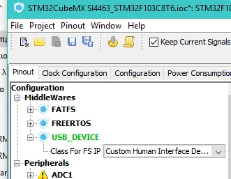

Now I have created a project with CubeMX for the USB hid example. When I run this project on the STM32F103, the computer recognizes my device as a USB Mouse. But I want to use it as a Custom HID device. How are the settings related to this? How do I fix my descriptor file?

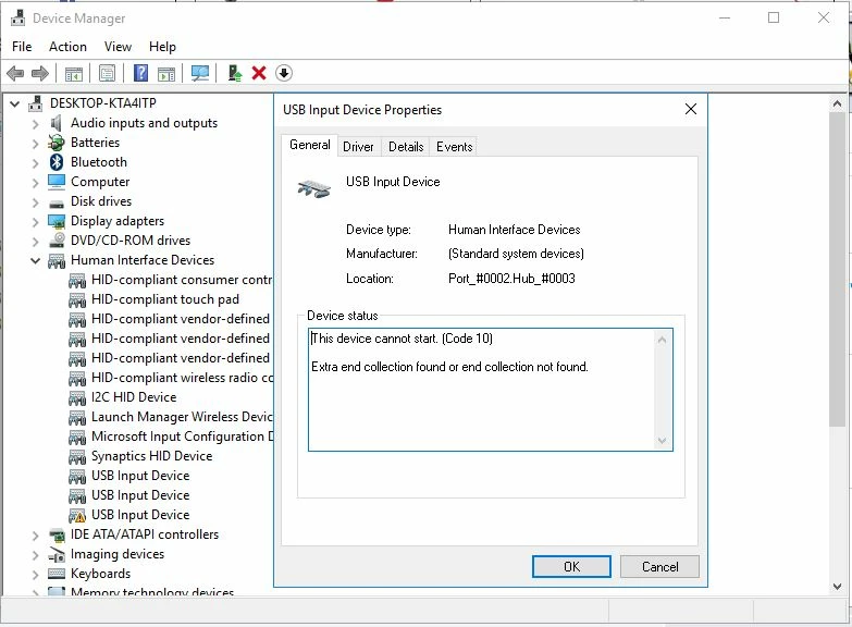

Thank you for the reply. Now I created Custom USB HID project via CubeMX.   When I loaded the project to the STM32F103 and then made the USB connection, I got the error ''This device cannot start''. The driver installation is successful, but the device can not be started.
Do you have any information about this problem? I do not understand why this happens.

No, There is no problem with stack size. I understand the problem. I need to fill in the Report Description section in the USB Custom Hid project
__ALIGN_BEGIN static uint8_t CUSTOM_HID_ReportDesc_FS[USBD_CUSTOM_HID_REPORT_DESC_SIZE] __ALIGN_END =
/* USER CODE BEGIN 0 */
0x00,
/* USER CODE END 0 */
0xC0 /* END_COLLECTION */
The device can not be started by the PC because this function is empty. How to create USB Report Description?

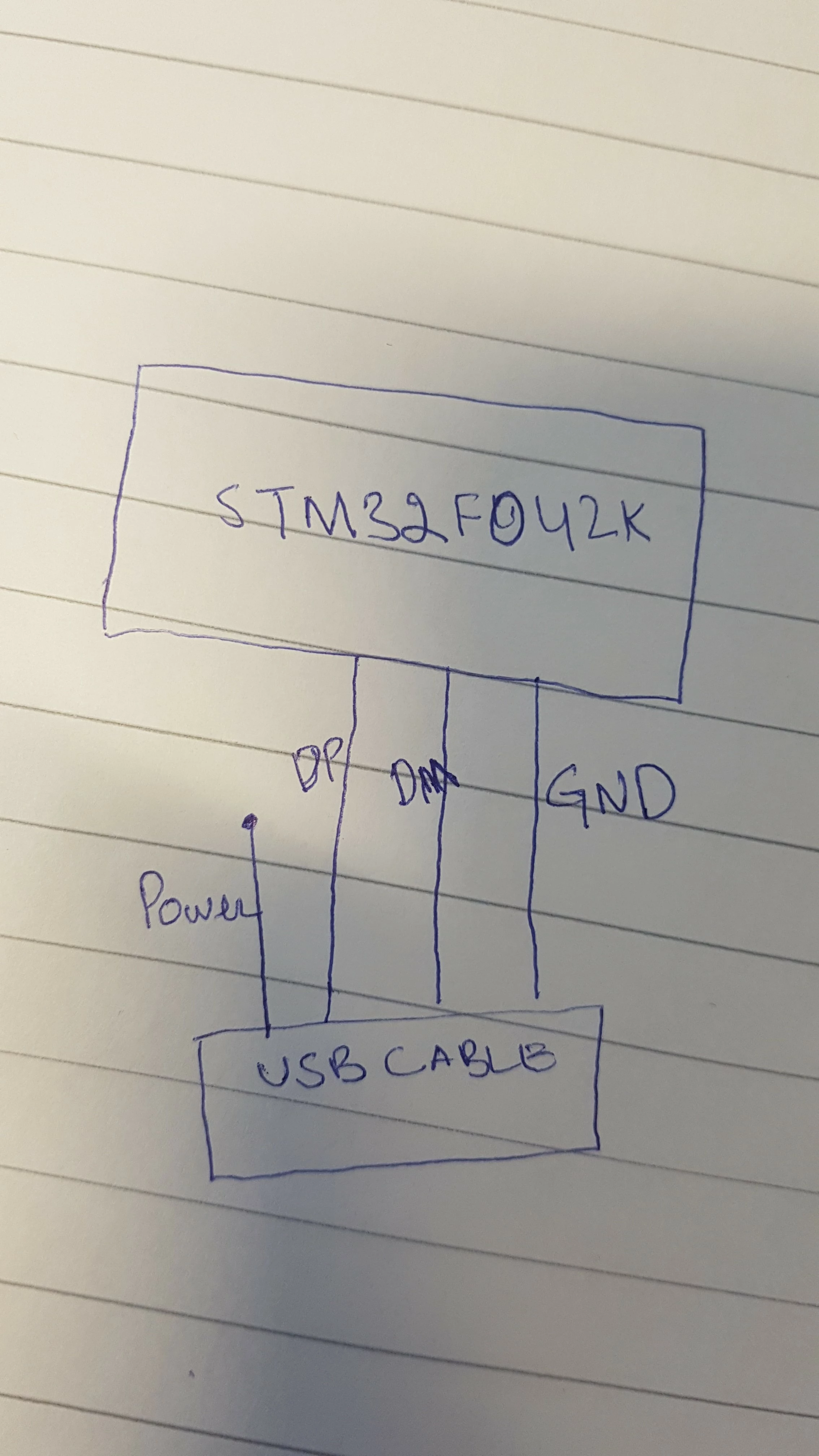

Hi
.I configured Usb HID Device libraries for my stmF042k..but windows says Usb device not recognised. since F042k dont have a dedicated user usb,so here is my scheme i connected a usb cable to my stm..i left the power cable open because i am not sure whether i need to power it.Can you please share your experience how you solved the problem..I am using Cube for initilisation..(I did the same for Stmf3 Discovery,the code was working but that board has a user usb.)0690X000006CGVeQAO.jpg
