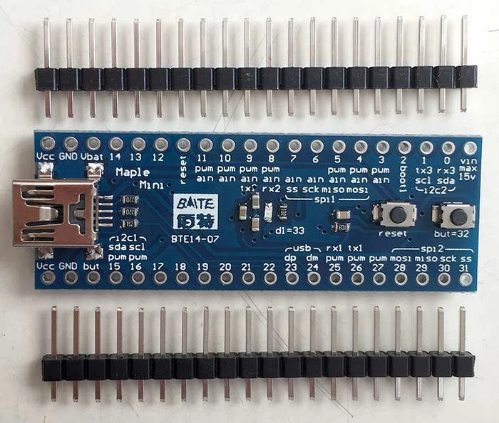

I am trying to communicate my Maple Mini clone board with PC without using a USART hardware.
I've configured MCU with STM32Cube IDE which has STM32CubeMX in it. I've enabled USB hardware, set it to FS, set FS mode to CDC. After I flashed that firmware, when I plug board using a USB cable, there is no device shown on Device Manager.
CDC_Transmit_FS functions returns 1 which I think corresponds to HAL_ERROR. I've set the CDC_SET_LINE_CODING in usbd_cdc_if.c as recommended in some other thread. I've tried another USB cable in case other one does not have working data bus. No matter what I've done, I could not get it working.
I am using Windows 10 64 bit version. As I know, I should let Windows to take care of driver installation.

waclawek.jan
May 29, 2019 6:46 AM UTC
Do you switch on the DP pullup?
Nuppo
NuppoAuthor
May 29, 2019 7:36 AM UTC
What do you mean by switch on DP pullup? Pullup resistors are already implemented on Maple mini hardware.
Glen Cook_2
May 29, 2019 7:39 AM UTC
Is this a blue pill type board? If so you may need to change one of the resistors from 10k to 1.5k
See the know issues here
https://wiki.stm32duino.com/index.php?title=Blue_Pill
Cheers
Glen.
Nuppo
NuppoAuthor
May 29, 2019 7:43 AM UTC
0690X000008a7y2QAA.jpgThis is the board I'm using.
Glen Cook_2
Glen Cook_2Best answer
May 29, 2019 7:49 AM UTC
There is a USB reset line on one of the GPIO ports that may need to be toggled. Looking at the schematic it's on PB9.
Nuppo
NuppoAuthor
May 29, 2019 8:51 AM UTC
Configuring PB9 as output then setting it to low solved my problem. Thank you for your help.
