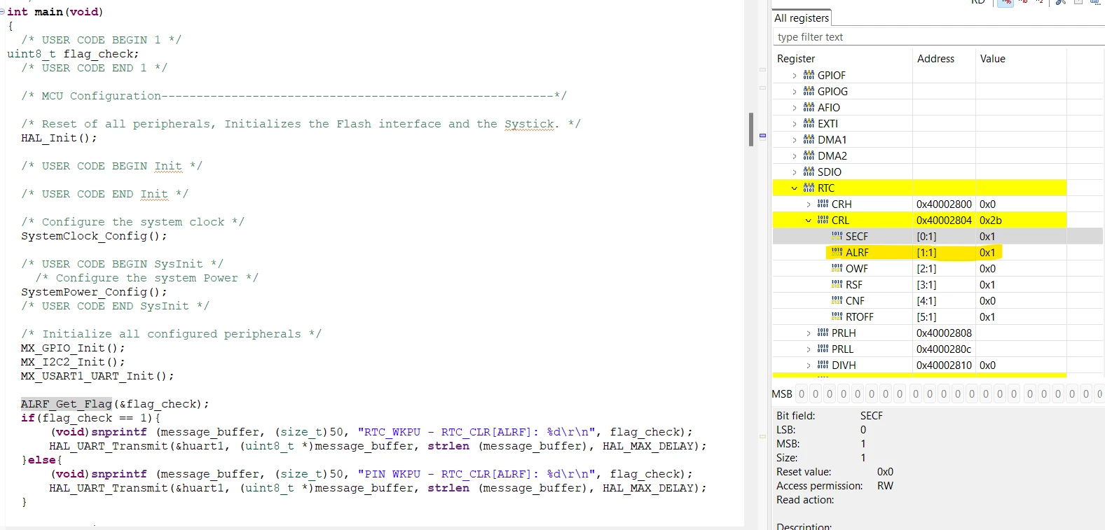

To achieve this, I am trying to read the RTC_CRL[ALRF] bit after returning from STANDBY mode and executing the functions HAL_Init(); and SystemClock_Config(); The result I obtain is somewhat curious. When the debugger is connected (Stlink V2), the flag is correctly activated after the system reset. However, when I disconnect the debugger and perform logging through UART, the bit never gets activated, even though it is the alarm that causes the system reset.

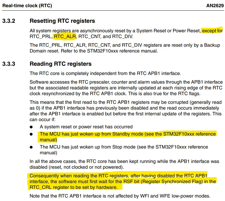

I have created my own function to read the register following the instructions I´ve found on the reference manual and on AN2629, and it must be executed before the function MX_RTC_Init(); generated automatically by the STMCUBE IDE. This is because MX_RTC_Init includes the HAL_RTC_Init function, which clears the ALRF flag during RTC initialization.

The ALRF bit is part of RTC_CR register, not ALR - this can be seen e.g. in the figure just above, the paragraph from the reference manual i´ve posted. And this register is not part of the backup domain.

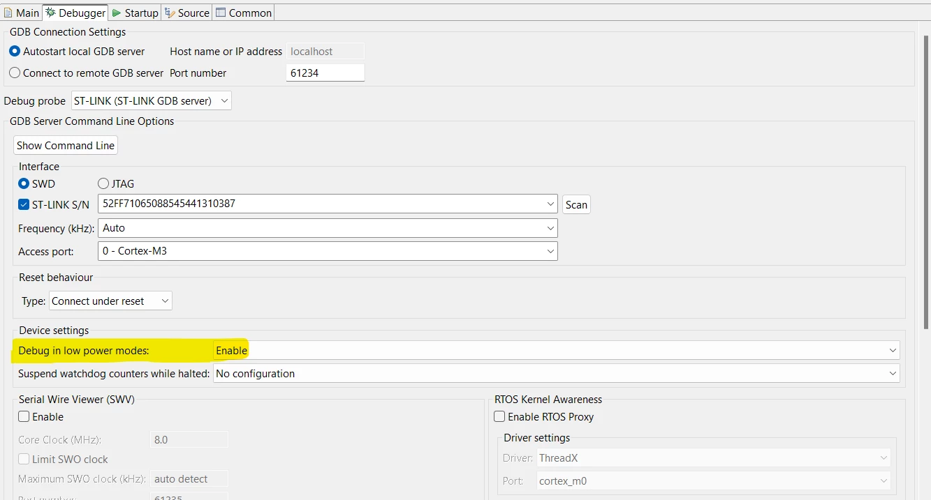

When debugging during this time, then the MCU is not really in standby - the debug enable bit is active. This means that the core is still clocked along with all the registers and thus they are not reset. In normal conditions, debug does not provide power / clock to the core and peripherals.

You´ve shared one link that contains one interesting option that i did not test regardind the debug status during low power modes.
#ifdef NDEBUG
	DBGMCU->CR = 0; // Disable debug, trace and IWDG in low-power modes
#endif
Also this option can be disabled on the debug configurations of the STM32CUBE IDE 1.13.2. I´m not sure if a new compilation flag is generated/removed by enabling/disabling this option.
I will investigate it and share with you my results.

Hello @Issamos , what you say is correct, but using that function to read the flag does not influence the result; I have already tested it, and the result is the same. Also is needed to wait for the RSF (Register Synchronized Flag) bit after waking up from standby mode. After a reset caused by the scheduled RTC alarm, if I have the debugger connected, it reads the ALRF flag correctly. However, if I disconnect the debugger and check the value of the variable again (I print the flag's value through the serial port), I see that the ALRF flag is 0 after the system has restarted due to the RTC alarm activation. I will continue investigating this issue and will share the results in this post.

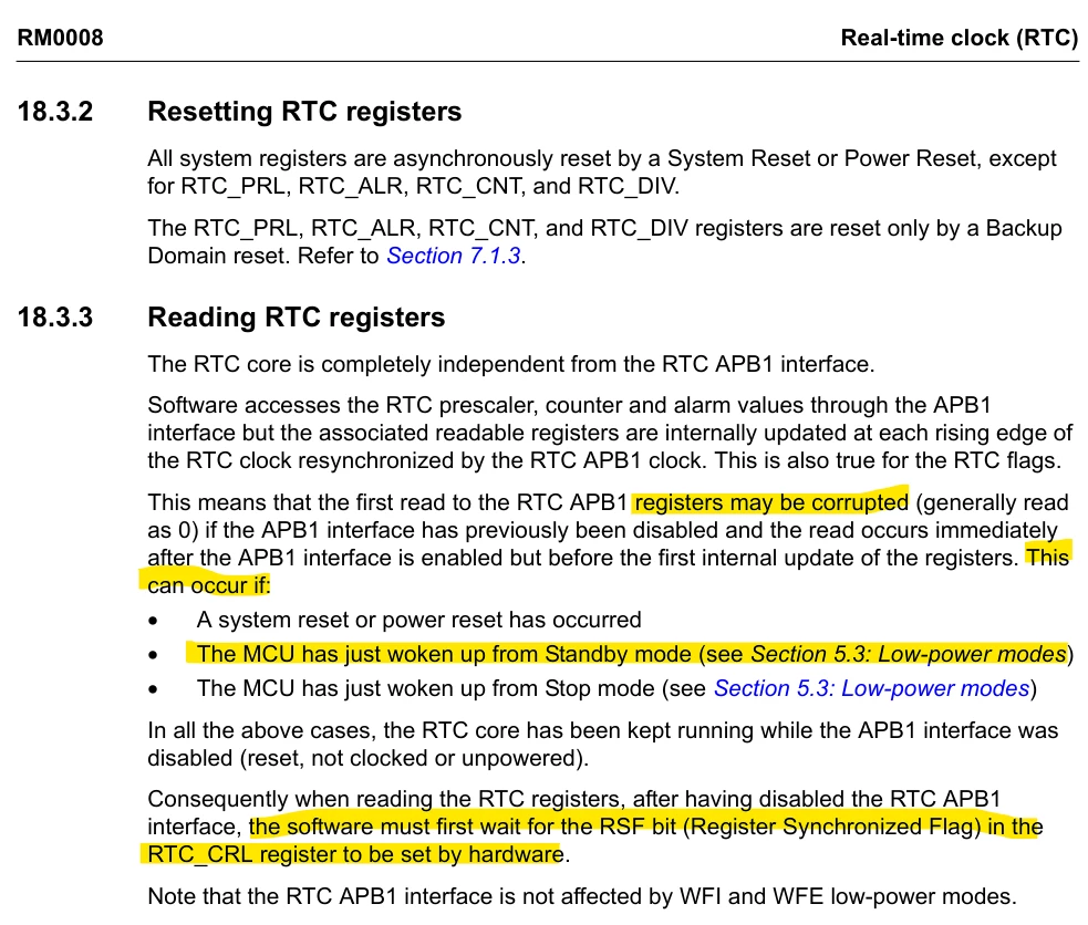

As can be seen even in your screenshot, the RM0008 section 18.3.2 "Resetting RTC registers" documents the reset factor very clearly:
All system registers are asynchronously reset by a System Reset or Power Reset, except for RTC_PRL, RTC_ALR, RTC_CNT, and RTC_DIV.
There is no RTC_CRL register in the list of exceptions, therefore it is reset and it is documented. But, of course, ST's support stuff also cannot see it...
