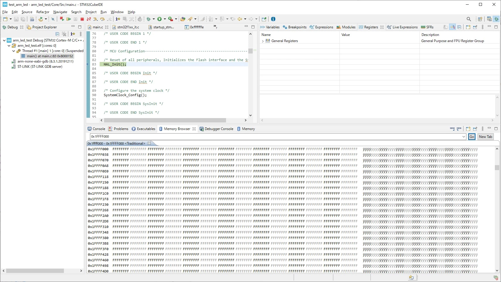

Hi all.
I am using the STM32F103RBT6 microcontroller.
Some MCUs mounted on the board did not run the bootloader.
When I checked system memory ​address(0x1FFFF000 - 0x1FFFF800) with STM32CUBEIDE ,
The range of the address is filled with 0xff(attached file).
Is there any way to recover MCUs in this situation?

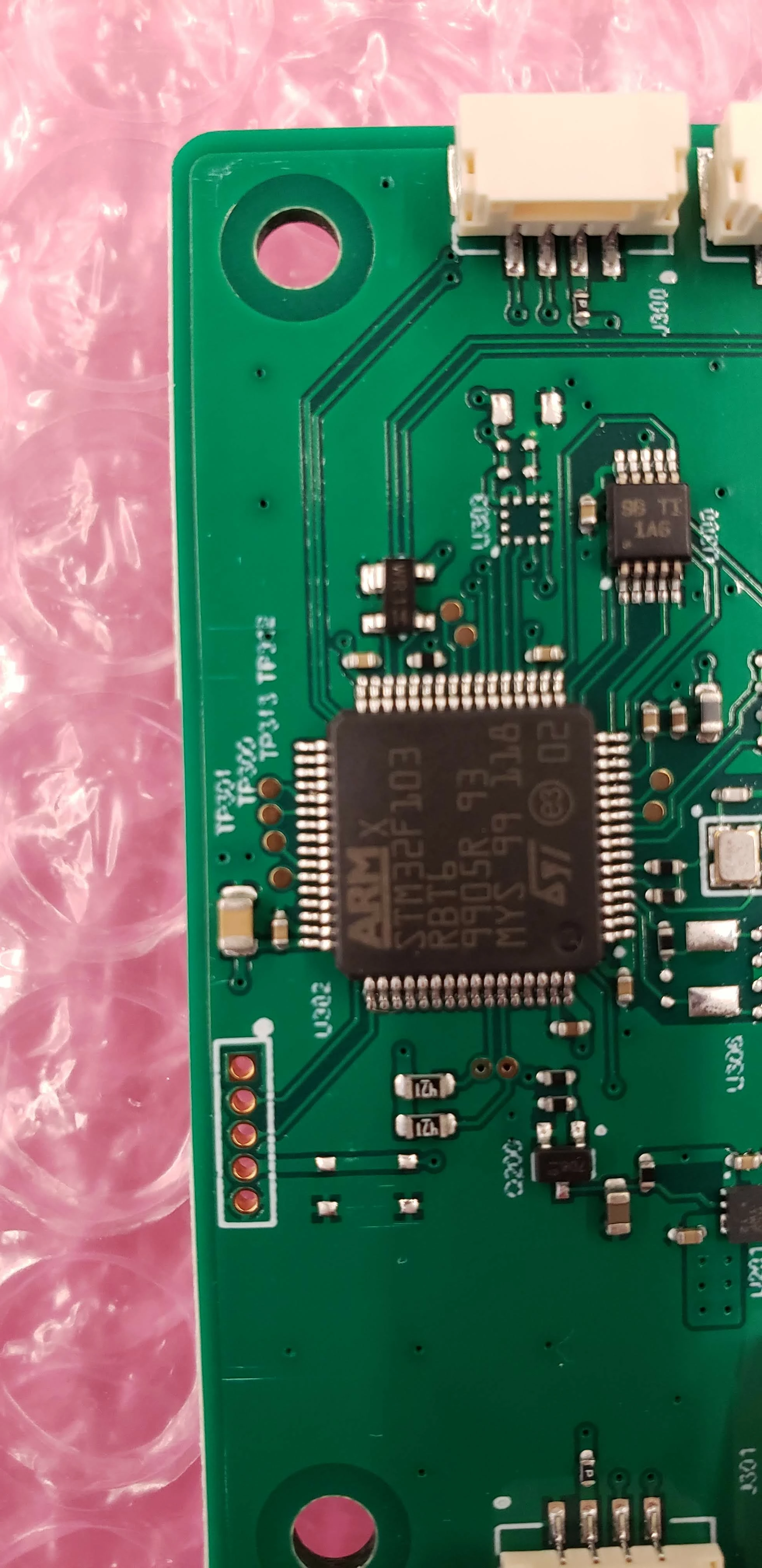

A picture of the faulty MCUs package is attached.

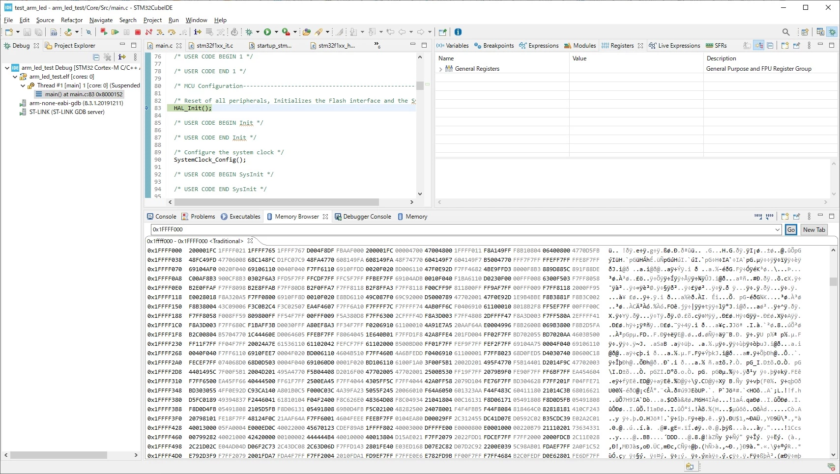

MCUs that can communicate with the bootloader have some binary written in the system memory.

Feb 14, 2022 9:27 AM UTC
The system memory of the MCU that can communicate with the bootloader is shown in the attached file.

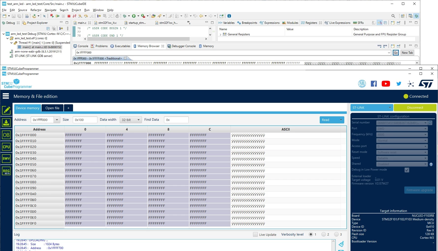

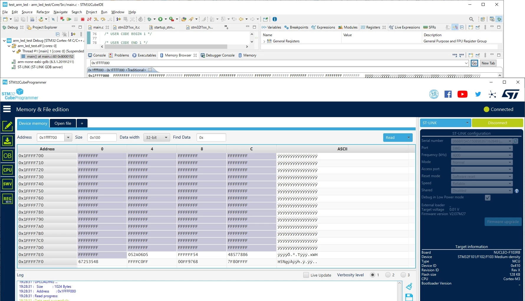

To exclude a fake as far as possible, please check the system memory (0x1FFFF000) and also the unique device ID (0x1FFFF7E8) with the STM32CubeProgrammer.

Feb 14, 2022 10:38 AM UTC
Thank you for your reply.
the address of unique device ID(0x1FFFF7E8) is written some binary(attach file).
but address of system memory(0x1FFFF000) is filled with 0xff

Feb 14, 2022 10:41 AM UTC
address of  system memory (0x1FFFF000) is filled with 0xff
Feb 14, 2022 1:10 PM UTC
Barring a weird STM32CubeProgrammer communication issue, your chip is likely counterfeit and is missing a bootloader. 0x1FFFF000 is in ROM which you can't write to. The UID looks bad as well.
