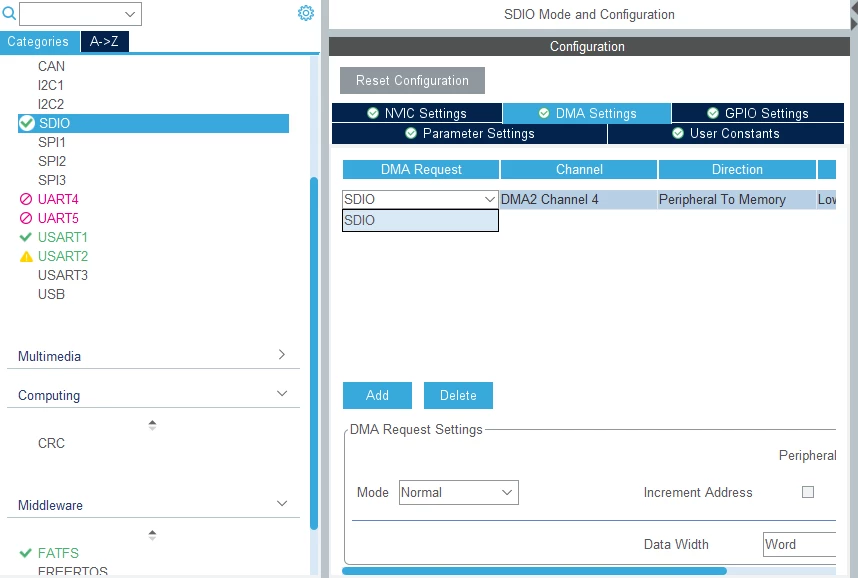

I tried to set DMA along the link, but SDIO_RX and SDIO_TX were not found.
0693W00000FCVefQAH.png​

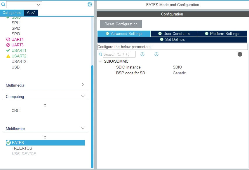

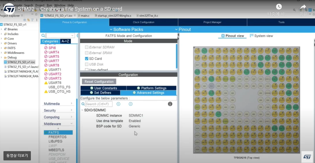

Also, I couldn't find the 'Use dma template' item in FATFS settings.
0693W00000FCVjfQAH.png​

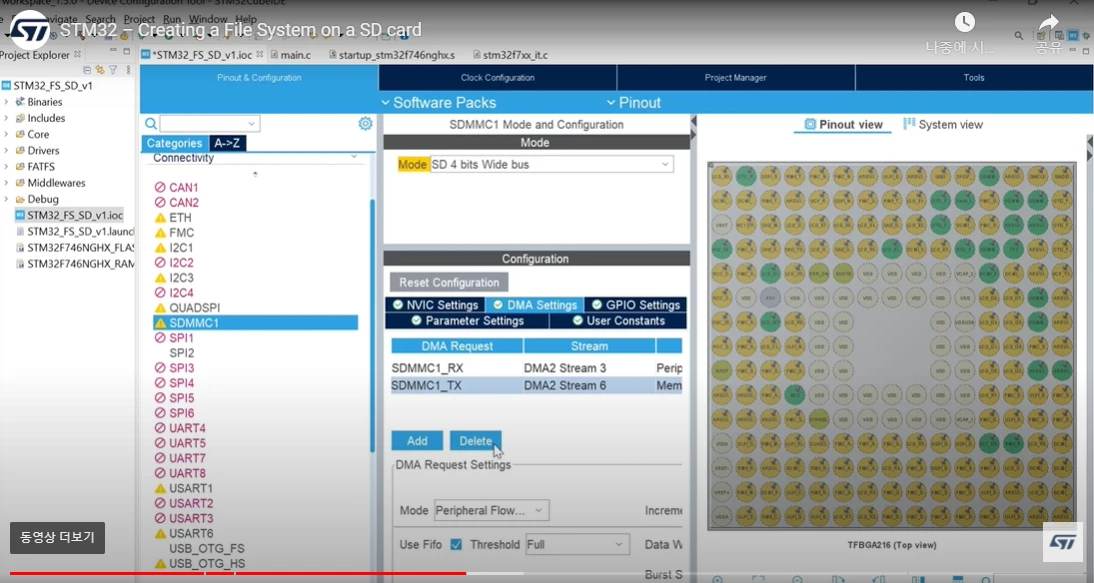

Thanks @Walid ZRELLI​  for the reply.
The STM32F7 series in the video you linked can set both RX and TX DMA settings,
0693W00000FE2EmQAL.png​
But the STM32F1 series cannot settings.
0693W00000FCVpxQAH.png​
Is it impossible to set DMA RX, TX in the .ioc file for STM32F1 series?
Is there no other way?
I would very much appreciate it if you confirm this question.

Hello @RKim.1​
This is normal because as mentioned in the reference manual SDIO DMA settings can only be configured on DMA2 Channel4 with peripheral to memory direction.
You can refer to the Reference manual.
BeST Regards,
Walid

  2. Use dma template settings is no exists at STM32F1 series. Is it set automatically in STM32F1 series?0693W00000FE32SQAT.png0693W00000FCVjfQAH.png
  3. SD card does not work in STM32F1 series if this is set. Are there any problems with these settings?
