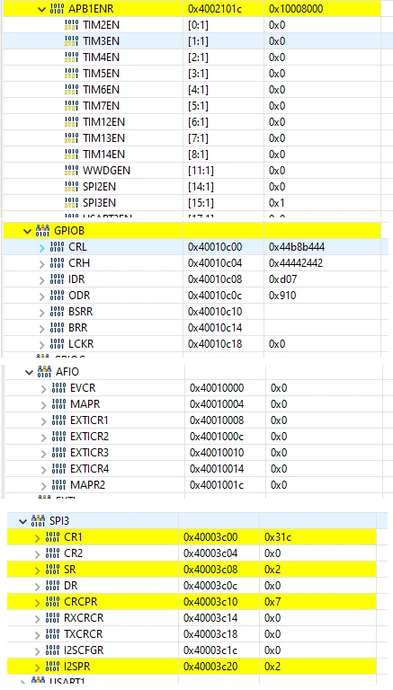

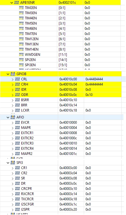

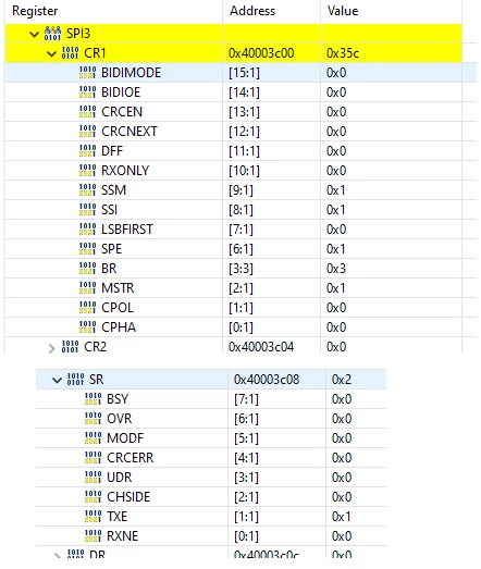

Registers before init:
Registers after SPI init:
_legacyfs_online_stmicro_images_0693W00000bj815QAA.pngRegisters after transmit:
_legacyfs_online_stmicro_images_0693W00000bj81AQAQ.png Is it correct?

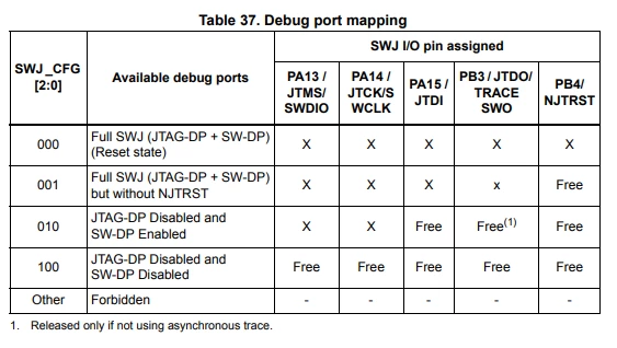

SCK is also SYS_JTDO so I add to HAL_MspInit:
__HAL_AFIO_REMAP_SWJ_NOJTAG();
After that SCK toggle too. When I turn on SPI I don't have any signal again :\
I fund in F1 HAL documentation "__HAL_AFIO_REMAP_SPI3_DISABLE" but it isn't available in my MCU.
Should I use more configuration to run SPI3?

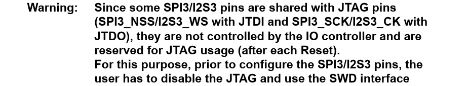

AScha.3
May 1, 2023 4:43 PM UTC
_legacyfs_online_stmicro_images_0693W00000bj8lhQAA.pngyou did...prior configure spi3 ?

I disabled JTAG in HAL_MspInit function, so before SPI init, but...
I aslo want to use PB4 as GPIO so I added "__HAL_AFIO_REMAP_SWJ_NONJTRST();" too.
Then I have value 0x060 in SWJ_CFG register.
I find table in RM0008 where is no 011 value. So I use only "__HAL_AFIO_REMAP_SWJ_NOJTAG();" and now SPI is working.
_legacyfs_online_stmicro_images_0693W00000bj8q5QAA.pngThank you AScha.3 and waclawek.jan for help! :)
