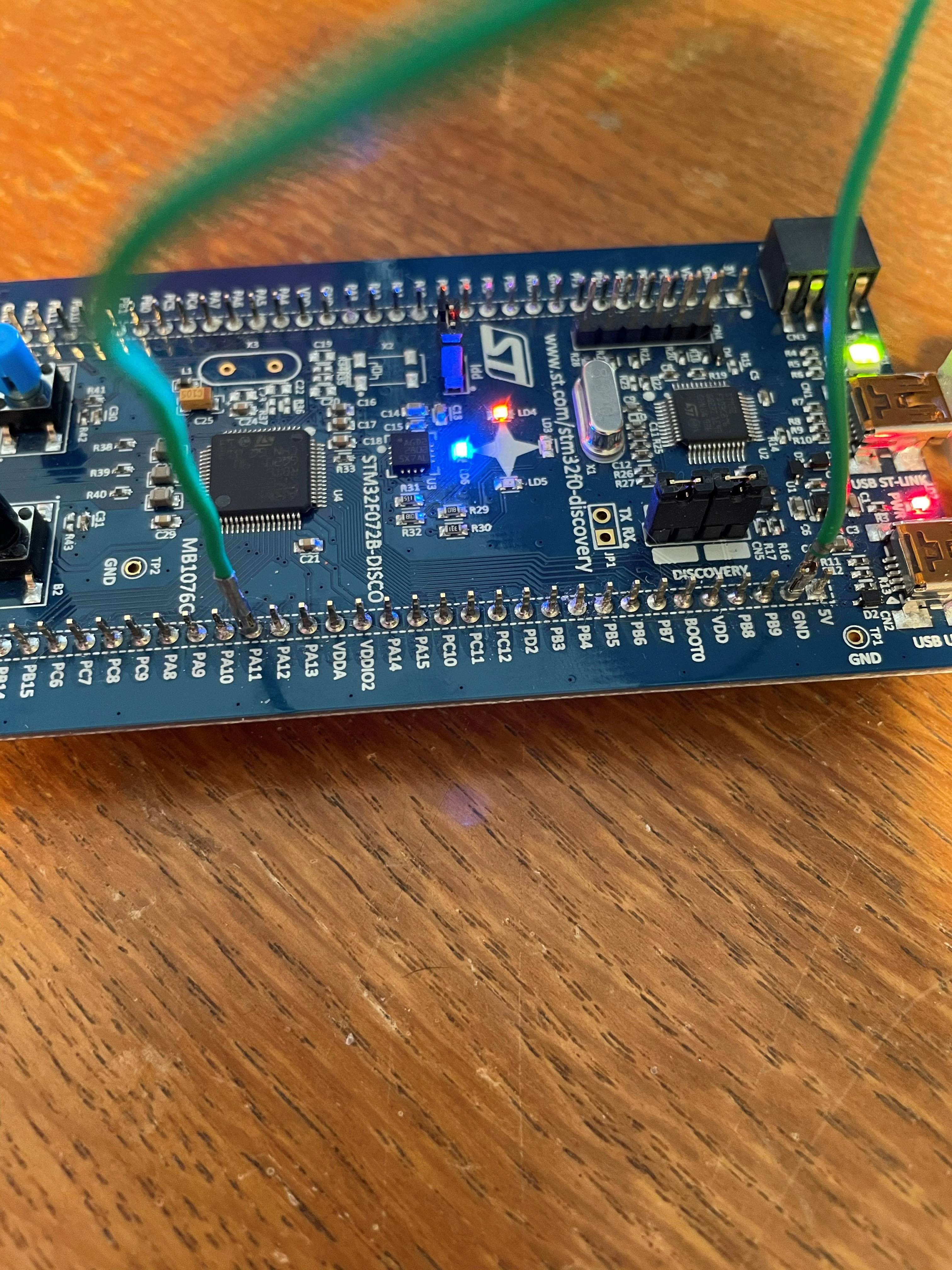

No matter what voltage/logic level I applied to the pins the LEDs did not change state.
I then set PA11 and PA12 as output push-pulls, made them write high, and used a logic analyser to scope the pins. With this set-up the pins should have been outputting a logic 1, however they remained at 0!
In short, I do not seem to be able to use these pins as regular GPIOs. I have tried looking through the documentation for any reference to this behaviour but came up with nothing. I know it is not how I am setting the pins up as applying the same process/config to PA9 and PA10 yields the expected results.

However I am still not able to correctly read pins PA11 and PA12. The IDR register seems to only change depending on whether I have a pull-up or pull-down resistor enabled - e.g. pins set up with pull-ups enabled, fly a wire from GND to PA11, pause program, IDR register for GPIOA reports it as a logic high (1). I have stripped the test program to not use any HAL libraries to try to eliminate that as a factor. Is there anything obvious that I am missing?
James

Jul 2, 2021 2:42 PM UTC
Hi TDK,
> IDR following the pull resistor but not your input would suggest you're not applying the input to the pin. Where exactly are you applying the flying pin?
That would be my assumption as well. It almost seems as though the pin on the board isn't physically connected to the chip. I have a lead connecting PA11 to GND on the discovery board as shown in the photo.0693W00000BcgpBQAR.jpg

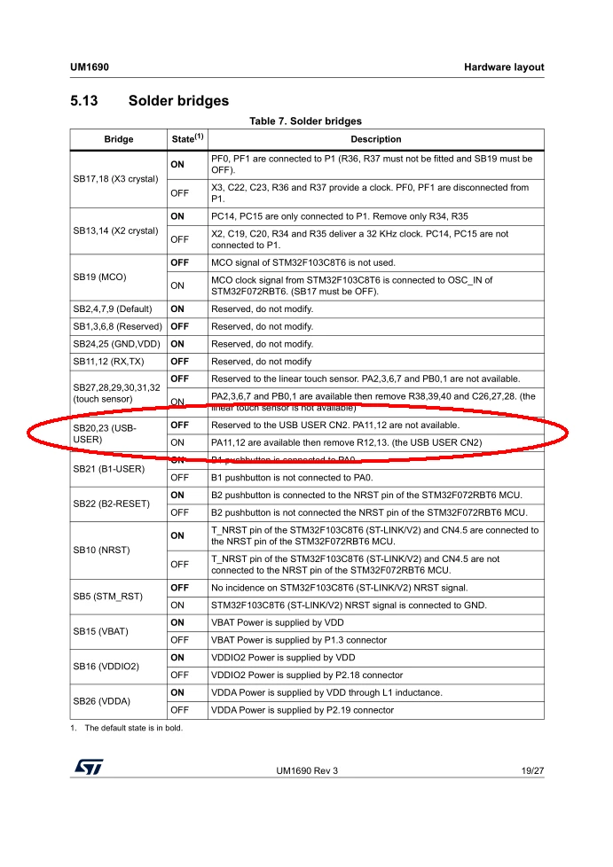

waclawek.jan
Jul 2, 2021 2:49 PM UTC
By default, it isn't.
0693W00000BcgsFQAR.pngJW
JCame.1
JCame.1Author
Jul 2, 2021 3:27 PM UTC
Ah that would explain a lot. Thanks a lot for your help, I should've looked at that document a lot earlier. I'll join that bridge and report back whether it springs back to life (which I am very certain it will).
Jul 2, 2021 4:06 PM UTC
> STM32F0-Discovery board
I checked the schematic beforehand and it did not show these solder bridges.
Turns out the issue was that I was looking at STM32F0-DISCOVERY board (per the OP), whereas the OP actually had the 32F072BDISCOVERY board, despite it saying "stm32f0-discovery" on the board itself. The OP also says STM32F072xB so can't really fault.
https://www.st.com/en/evaluation-tools/stm32f0discovery.html
vs
https://www.st.com/en/evaluation-tools/32f072bdiscovery.html

Jul 5, 2021 10:09 AM UTC
I have joined those bridges and now have the expected behaviour, thank you both for your help it is greatly appreciated.
Apologies for any unnecessary confusion I caused, I was not aware there were 2 evaluation boards (with a similar name) and somehow didn't notice that even with the page JW linked - that'll teach me to take a bit more time reading next time.
