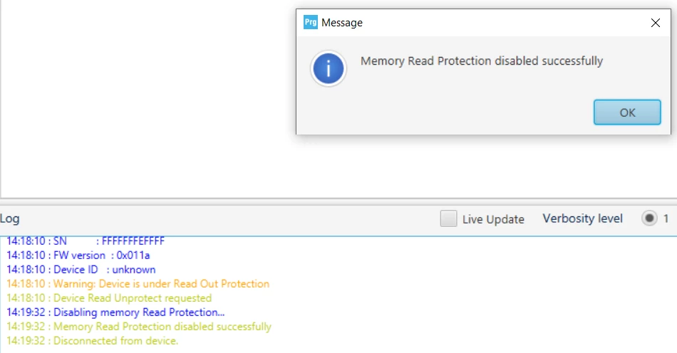

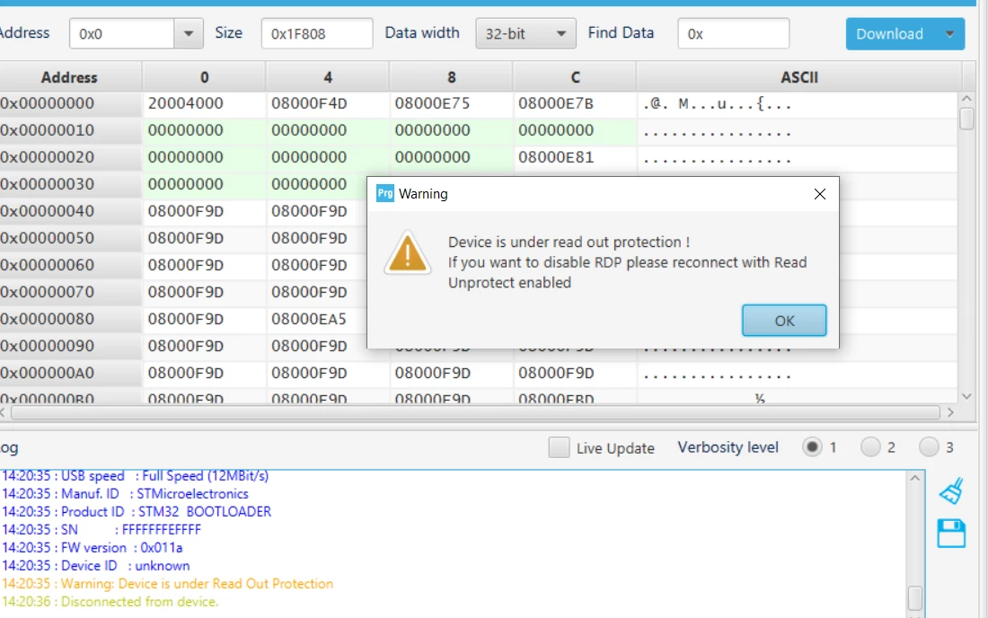

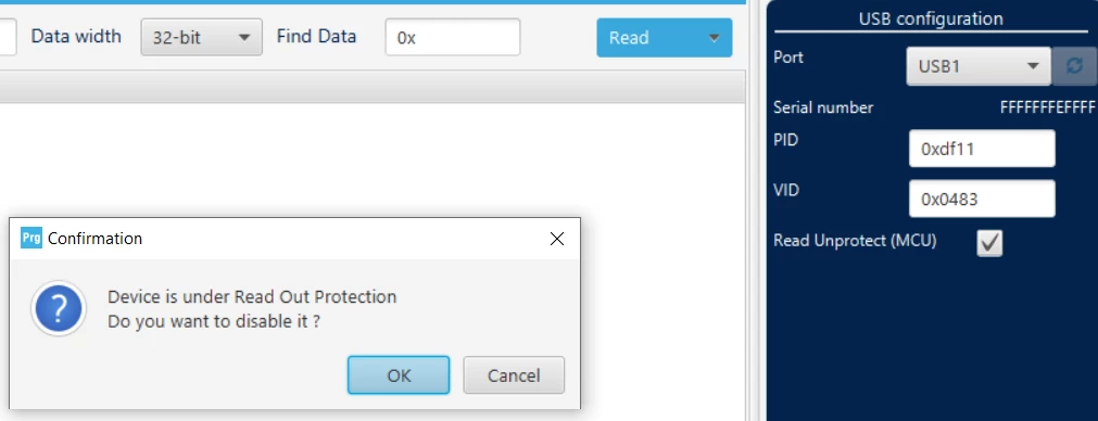

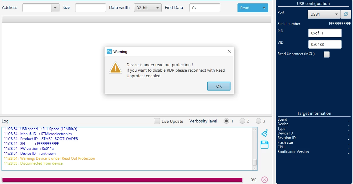

I also tried as suggested, setting up a flag to run the Bootloader_Start function after reset just before the initialization of peripherals begin.
But I still get the same issue. The STM32CubeProgrammer is able to connect but says the device is read protected:
0693W00000Kcjm6QAB.pngAnd when connecting with the "Read Unprotect (MCU)" option enabled, then I'm asked for confirmation to disable.
0693W00000KcjmLQAR.pngAfter confirmation, I get that it is disabled successfully:
0693W00000KcjnOQAR.pngBut then when I try to Download a new firmware I get the same warning saying it is under Read out protection:
Is there a way to disable this RDP during runtime before I call the Bootloader function?
