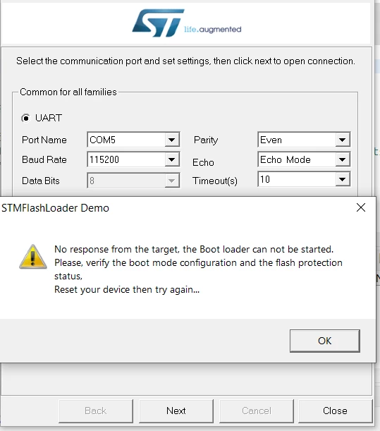

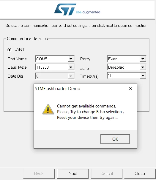

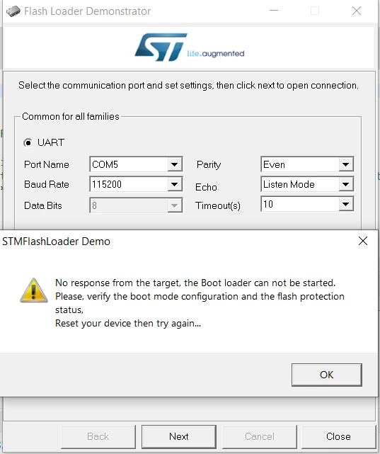

Thank you very much. Very helpful. It looks like I was missing this:
SYSCFG->CFGR1 = 0x01;
So now it doesn't end up in a Hard Fault interrupt. However, I haven't been able to connect using the Flash Loader Demonstrator. I have tried all 3 options for Echo without luck.

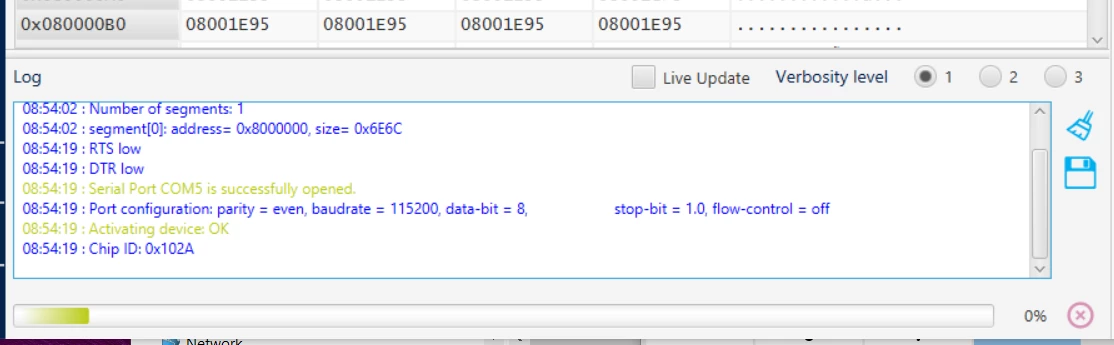

0693W00000GYKviQAH.png0693W00000GYKwIQAX.png0693W00000GYKvYQAX.pngUsing the STM32CubeProgrammer UART, I get it to connect, but haven't been able to flash anything. It stays with the loading bar ping-ponging without ever increasing from 0%.
What am I missing here?
