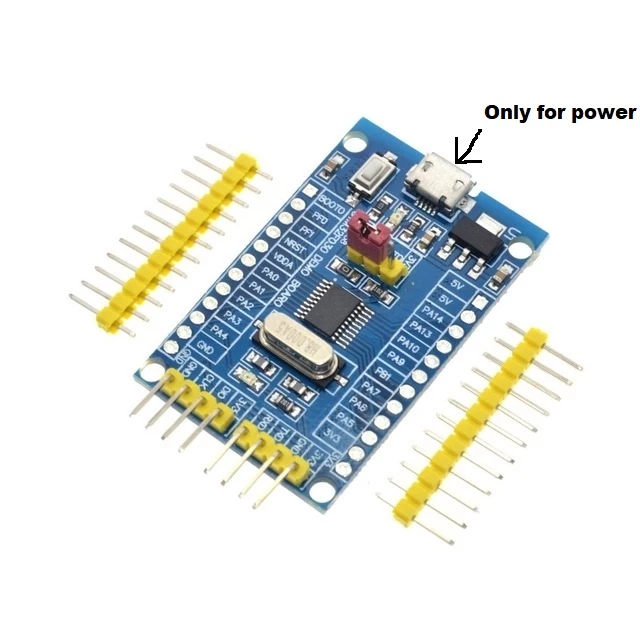

I am using STM32F070F6P6 china made breakout board

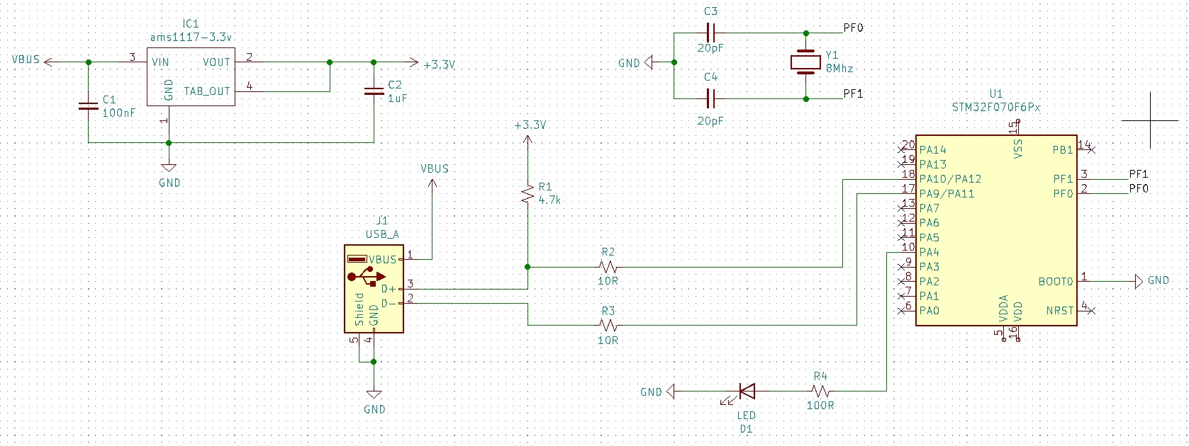

and has no on-board USB circuit so I made it on breadboard. please see attached circuit
I am using default STM32CubeIDE inbuilt MX created HAL driver and USB CDC VCP or HID middleware without any changes so not attaching any code.

Schematic

Hello @VPal.1​ ,
Follow this FAQ: USB device not recognized, it may help you.
Also try changing CDC_DATA_HS_MAX_PACKET_SIZE in usbd_cdc_if.h (like in this thread),
#define CDC_DATA_HS_MAX_PACKET_SIZE        64 /* Endpoint IN & OUT Packet size */
