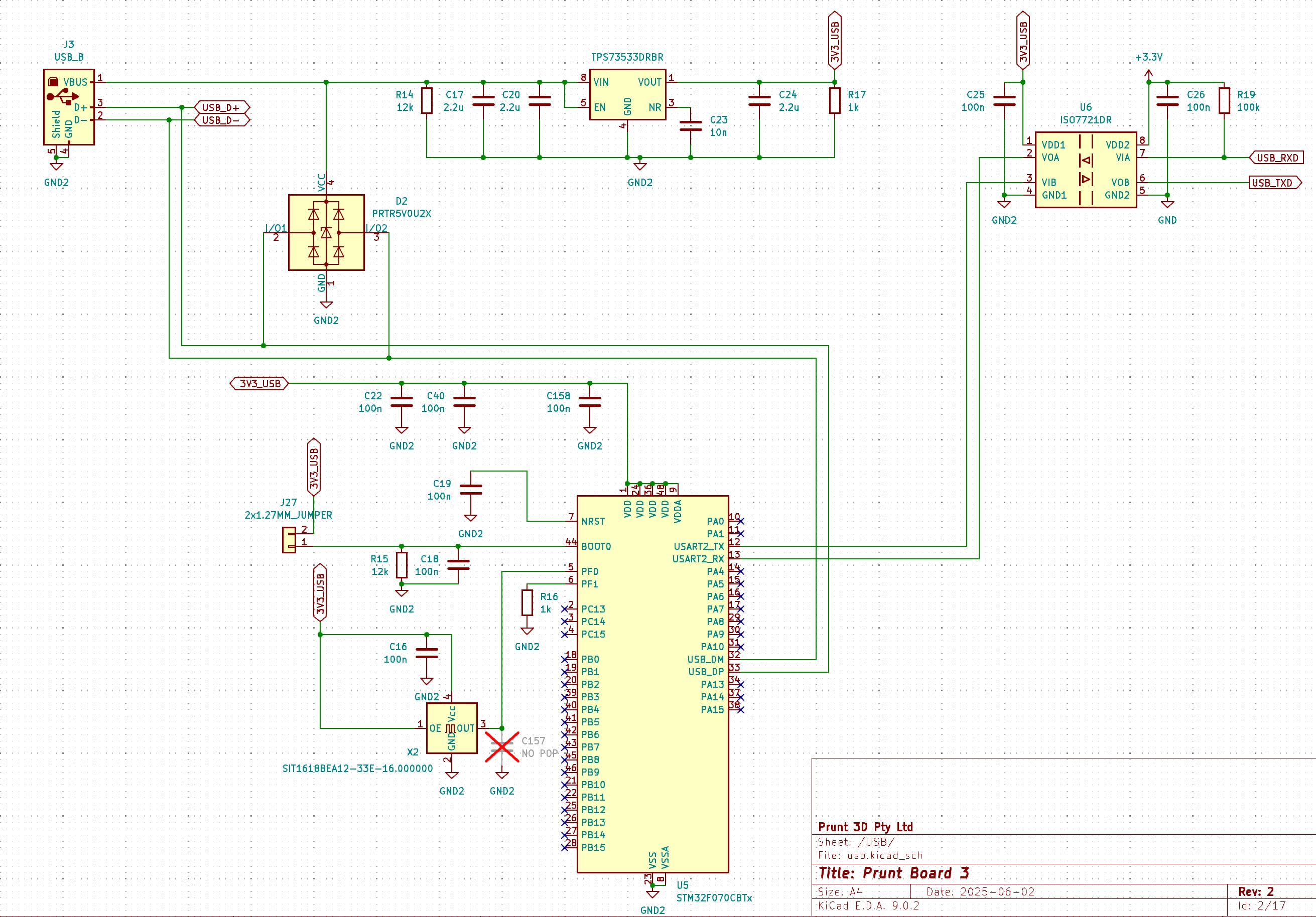

We have a STM32070CBT6 with minimal connections (schematic below) and it appears to be unresponsive to USB enumeration, although it does pull DP low to trigger it. This occurs when hotplugging it or holding reset low for a few seconds. I've checked the input on PF0 and it is getting a clean 16 MHz.

Pavel A.
Jul 17, 2025 7:13 AM UTC
On the host side do you see enumeration error or nothing at all? Borrow a hardware USB analyzer.

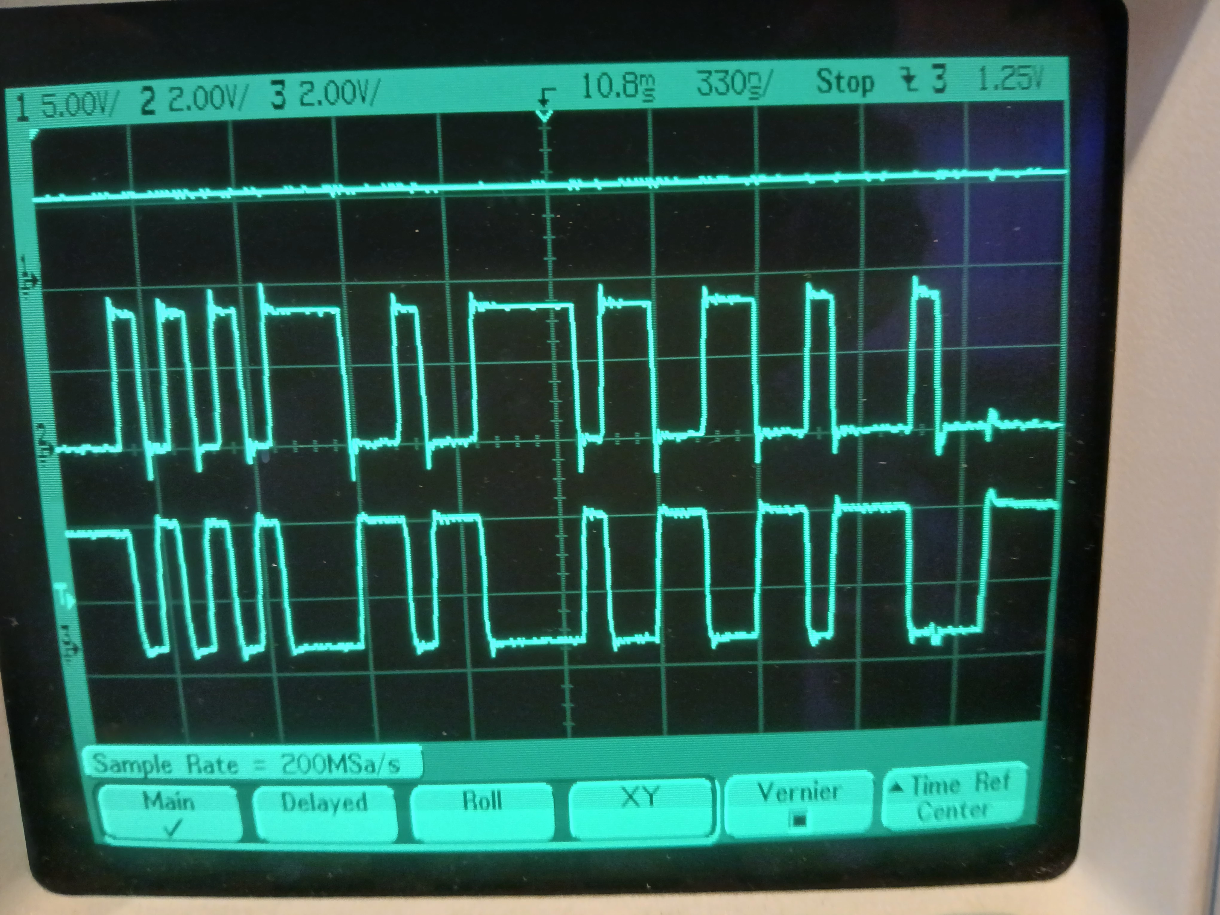

With a scope I see the pull down and then the setup packets going through every address from the host but no response from the STM32.
liampwllAuthor
Jul 17, 2025 7:50 AM UTC
You can decode the packet if you like, but I've tried on multiple machines so I doubt this is a USB driver issue. None of the packets are longer than this so I assume they're all setup packets.

I've also tried another board without an oscillator installed. In this case the pull-down does not occur, so it is not the case that it's just not detecting the oscillator. The MCU is certainly reaching the USB configuration step but then it is just not responding to USB setup packets.
For the sake of completeness I also installed the oscillator on that board, in which case it behaves just like the first one.

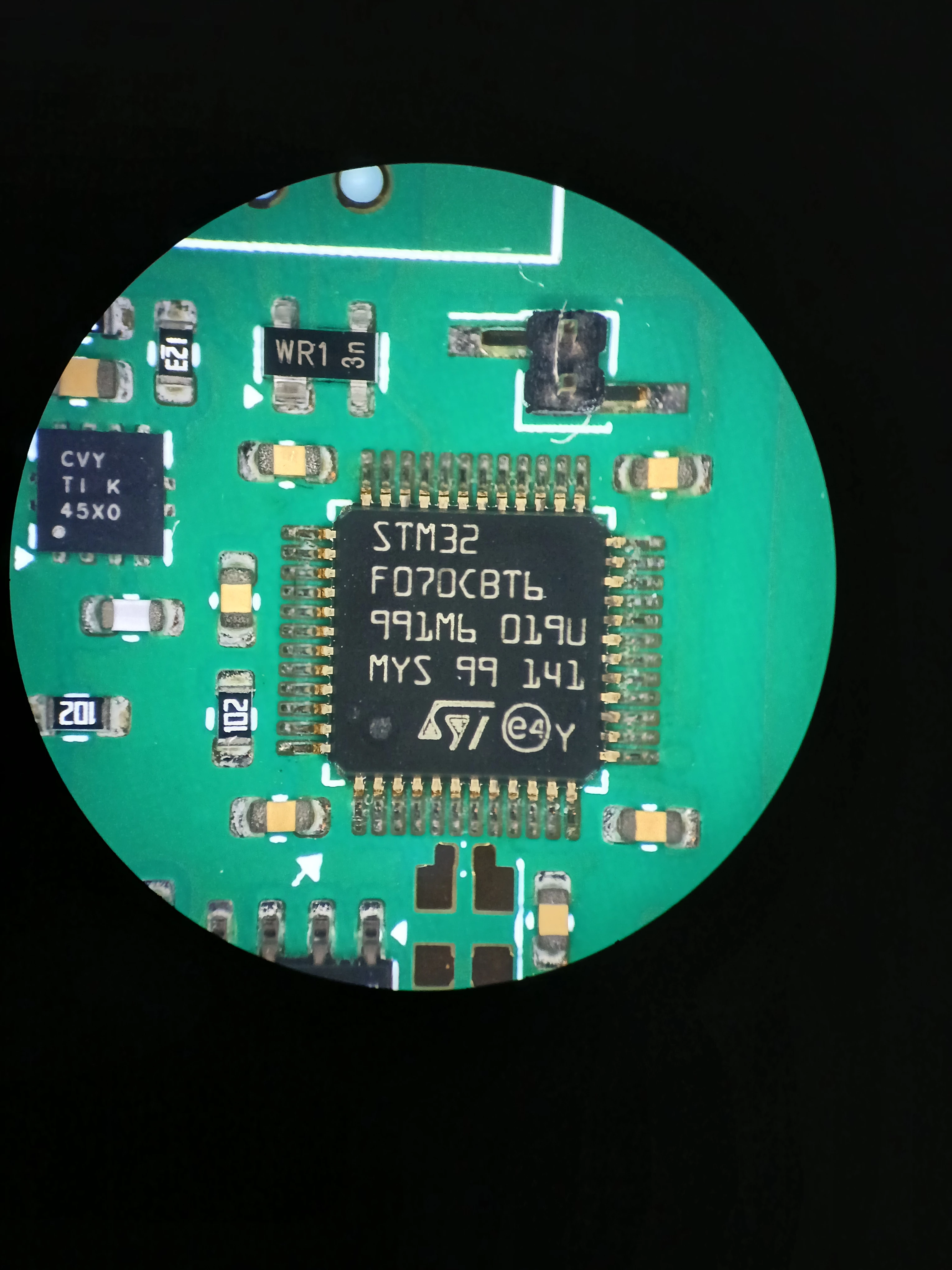

liampwllAuthor
Jul 18, 2025 3:15 PM UTC
Here are the package markings for reference as some searching of this forum shows that many others have reported the same issue and some have also reported that it was fixed by different revisions.

We've replaced the STM32F070CBT6 with a STM32F042C6T6 on the boards, specifically we have replaced just the MCU on the boards that were not working, and it now works fine so this strongly suggests that the bootloader is completely broken.
