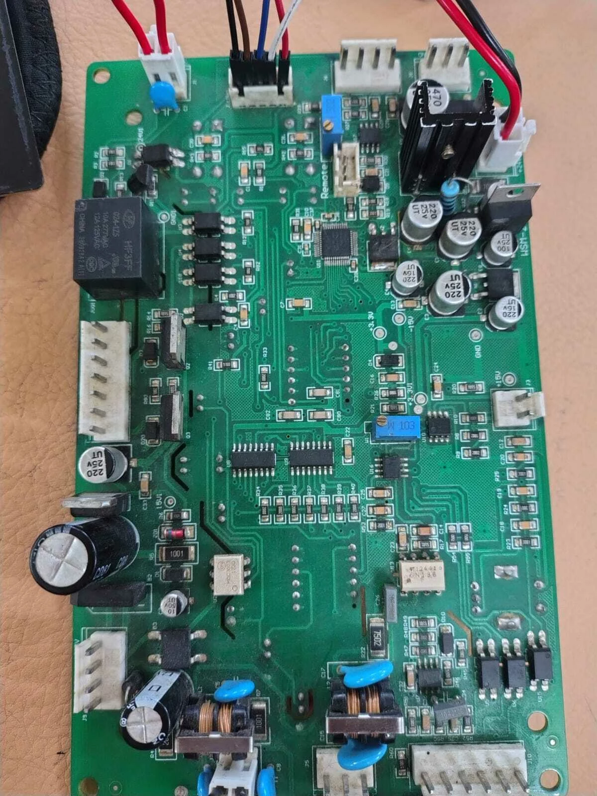

STM32F051C8T6 PWM not generating on custom TIG control board
I am using the STM32F051C8T6 MCU for TIG welding project, but PWM is not being generated on my custom TIG control board. Can anyone help me so

Are you sure, you call HAL_TIM_Base_Start_IT() for the timer you need?
In your main.c I see only HAL_TIM_Base_Start_IT(&htim3) inside an if()… but HAL_TIM_PWM_Start(&htim14, TIM_CHANNEL_1) for another timer.
Jul 30, 2026 11:12 UTC
yes i do this thing also but PWM is not working

Please show the schematic of the board.
Before starting on this custom board, have you got the PWM working on an ST board; eg,

I did replay for @Siddni, this code at least with three mistakes,
  • 1. Set TIM3 to PB10 was wrong, PB10 only support TIM2 ch3.​​​​​​​
  • ​​​​​​​2. Didn’t set AFRH moder.
  • 3. TIM3 didn’t set to PWM mode in CCMR1
Jul 30, 2026 11:13 UTC
but i use a TIM14 for pwm
Richard Li
Senior
Jul 29, 2026 23:45 UTC
After read new code, my early comment need update, new code change to TIM14, the CCMR1 setting done. AFRL setting done.
My comment three point fixed.

In your project, there are two main.c, which one you want use?
This project structure need change, should only one main.c inside.
Richard Li
Senior
Jul 30, 2026 02:21 UTC
I did change your project structure, and add code inside TIM14_init, PA5 output come out.

I didn’t change every code in your project, after TIM14 init, the “__HAL_TIM_SET_COMPARE(&htim14, TIM_CHANNEL_1, 5000);”   the 5000 too big, force TIM14 stop, if you reduce 5000 to 100, it will continual output pulse.
I used debug step by step, before this set 5000, pulse come out.
Please find some one in local help you, your STM32 code knowledge not enough handle this project.

In main.c
I add these code:
Your new project delete these code, of cause it doesn’t work.
If you use Scope measure PA4, you can find pulse come out.
    //RL
    // 1. Enable ARR preload
//    TIM14->CR1 |= TIM_CR1_ARPE;
    // 2. Put channel 1 into output mode
    TIM14->CCMR1 &= ~TIM_CCMR1_CC1S;
    // 3. Enable output compare preload
//    TIM14->CCMR1 |= TIM_CCMR1_OC1PE;
    // 4. Set PWM mode 1 (110b)
    TIM14->CCMR1 &= ~TIM_CCMR1_OC1M;
    TIM14->CCMR1 |= (6 << TIM_CCMR1_OC1M_Pos);
    // 5. Enable channel output
    TIM14->CCER |= TIM_CCER_CC1E;
    // 6. Set ARR and CCR1
    TIM14->ARR = 1000;
    TIM14->CCR1 = 50;
    // 7. Start counter
    TIM14->CR1 |= TIM_CR1_CEN;
//RL

Attached new code change CCR1 to 5000 fit your original code, it verify by STM32 f0 discovery board , PA4 output pulse frequency 4.8K duty 50%, you can download to F0 discovery test first, maybe your new board with another problem.
