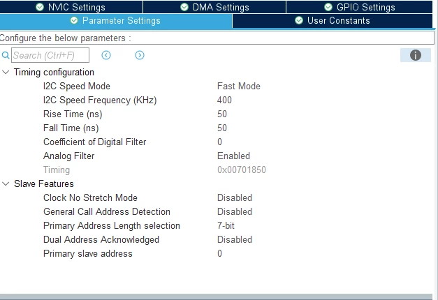

Today, I was receiving my eeprom data normally with my normally working I2C code, but when I entered debug mode, the uwtick increased on my processor, but it was not receiving my commands. The LED indicating that the code was running was not blinking. After some time I noticed that in debug mode the commands were not working but when not in debug mode it was working.
Setting & Code

Before the while, I call an eeprom method called Memory_Init(). When I call this method, sometimes I2C works properly, the microcontroller receives my commands or overrun etc. It returns errors, it does not loop, it does not receive all my engine, gpio and other commands, but my EEPROM chip is not broken and it does this from time to time. After opening this issue last night, I realized that this problem occurs even if I enter debug mode or not.

Have you tried using the DMA process? Utilizing DMA can help avoid overrun issues.
Why are you waiting 5ms after the read operation? Is this the recommended wait time mentioned in the slave device's datasheet to ensure the device is ready after a read process?

Before doing i2c read, there is a command to chek if the bus is ready or not. Try to reduce the i2c pullups. Check the return code of i2c calls. Try with reduced i2c speed(100khz)
