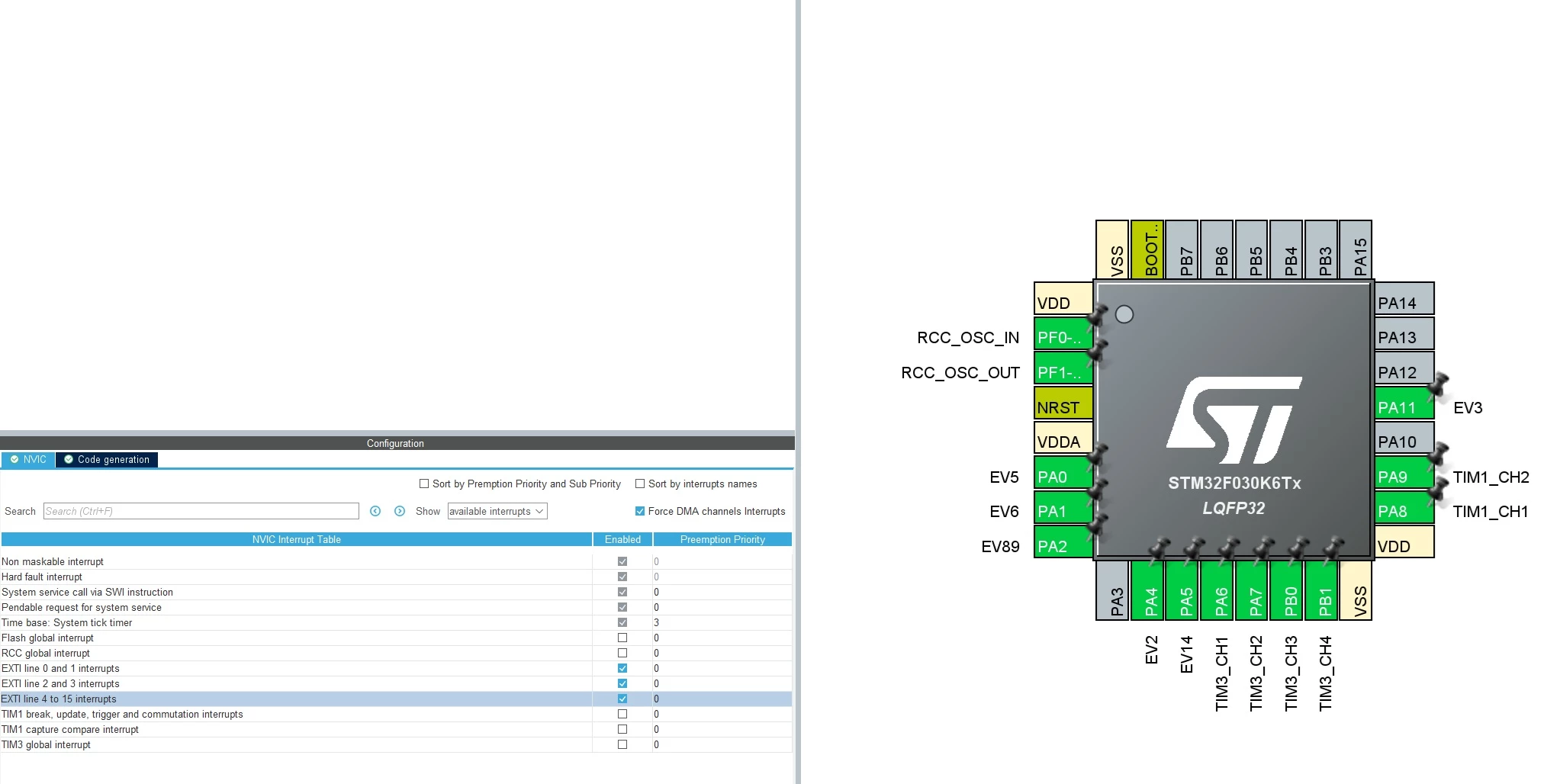

STM32F030K6 _ external interrupt just 1/3 EXT line is function
I try to use 6 external interrupts but only EXT4_15 is functionning. All is functionning correctly when i use HAL_GPIO_ReadPin() function without interrupts.
Thank you for your HELP
void EXTI0_1_IRQHandler(void)
 /* USER CODE BEGIN EXTI0_1_IRQn 0 */
 /* USER CODE END EXTI0_1_IRQn 0 */
 HAL_GPIO_EXTI_IRQHandler(EV5_Pin);
 HAL_GPIO_EXTI_IRQHandler(EV6_Pin);
 /* USER CODE BEGIN EXTI0_1_IRQn 1 */
 /* USER CODE END EXTI0_1_IRQn 1 */
 * @brief This function handles EXTI line 2 and 3 interrupts.
void EXTI2_3_IRQHandler(void)
 /* USER CODE BEGIN EXTI2_3_IRQn 0 */
 /* USER CODE END EXTI2_3_IRQn 0 */
 HAL_GPIO_EXTI_IRQHandler(EV89_Pin);
 /* USER CODE BEGIN EXTI2_3_IRQn 1 */
 /* USER CODE END EXTI2_3_IRQn 1 */
 * @brief This function handles EXTI line 4 to 15 interrupts.
void EXTI4_15_IRQHandler(void)
 /* USER CODE BEGIN EXTI4_15_IRQn 0 */
 /* USER CODE END EXTI4_15_IRQn 0 */
 HAL_GPIO_EXTI_IRQHandler(EV2_Pin);
 HAL_GPIO_EXTI_IRQHandler(EV14_Pin);
 HAL_GPIO_EXTI_IRQHandler(EV3_Pin);
 /* USER CODE BEGIN EXTI4_15_IRQn 1 */
 /* USER CODE END EXTI4_15_IRQn 1 */

void HAL_GPIO_EXTI_Callback(uint16_t GPIO_Pin) {
	switch(GPIO_Pin)
	/*EV14*/
	case EV14_Pin :
		if (!HAL_GPIO_ReadPin(GPIOA, EV14_Pin)) {
			cons_EV14_active = 1;
			TIM1->CCR2 = CRR_spike;
			t14 = HAL_GetTick();
		} else {
			cons_EV14_active = 0;
			TIM1->CCR2 = 0;
		break;
	/*EV2*/
	case EV2_Pin :
		if (!HAL_GPIO_ReadPin(GPIOA, EV2_Pin)) {
			cons_EV2_active = 1;
			TIM1->CCR1 = CRR_spike;
			t2 = HAL_GetTick();
		} else {
			cons_EV2_active = 0;
			TIM1->CCR1 = 0;
break;
/*EV3*/
	case EV3_Pin :
		if (!HAL_GPIO_ReadPin(GPIOA, EV3_Pin)) {
			cons_EV3_active = 1;
			TIM3->CCR2 = CRR_spike;
			t3 = HAL_GetTick();
		} else {
			cons_EV3_active = 0;
			TIM3->CCR2 = 0;
	break;
/*EV89*/
	case EV89_Pin :
		if (!HAL_GPIO_ReadPin(GPIOA, EV89_Pin)) {
			cons_EV89_active = 1;
			TIM3->CCR1 = CRR_spike;
			t89 = HAL_GetTick();
		} else {
			cons_EV89_active = 0;
			TIM3->CCR1 = 0;
	break;
/*EV5*/
	case EV5_Pin :
		if (!HAL_GPIO_ReadPin(GPIOA, EV5_Pin)) {
			cons_EV5_active = 1;
			TIM3->CCR4 = CRR_spike;
			t5 = HAL_GetTick();
		} else {
			cons_EV5_active = 0;
			TIM3->CCR4 = 0;
	break;
/*EV6*/
	case EV6_Pin :
		if (!HAL_GPIO_ReadPin(GPIOA, EV6_Pin)) {
			cons_EV6_active = 1;
			TIM3->CCR3 = CRR_spike;
			t6 = HAL_GetTick();
		} else {
			cons_EV6_active = 0;
			TIM3->CCR3 = 0;
	break;

TDKBest answer
Jul 15, 2025 3:02 PM UTC
 HAL_NVIC_SetPriority(EXTI4_15_IRQn, 0, 0);
 HAL_NVIC_EnableIRQ(EXTI4_15_IRQn);
Looks like these lines are missing for EXTI0_1 and EXTI2_3.

Jul 16, 2025 11:40 AM UTC
Thank you!
1. [Part Number] STM32F030K6T6
2. [Environment] STM32cubemx6.14.1 + STM32CubeIDE Version: 1.18.03.
3. [Schematics] See the screenchot above. It's custum board.  All is functionning correctly when i use HAL_GPIO_ReadPin() function without interrupts.
4. [Details] only EXT4_15 is functionning.
5. [Expected behavior] all external interrupts  needs to be OK
6. [How to reproduce] Inputs are configured with pull-up resistor  and Rising/Falling edge detection
Andrew Neil
Jul 16, 2025 11:59 AM UTC
That's not a schematic - that's just the CubeMX pinout.
That tells us nothing about the external hardware & connections.
You need to show the schematic of your board - ie how the STM32 is connected to the rest of your system.

Jul 16, 2025 11:43 AM UTC
I've done a quick test. It seems to be the good way : now all is functionning except EV5 (PA0_Pin). I will do more verification tomorow.
Thank you
Jul 17, 2025 2:37 PM UTC
Thank for your Help!
All ISR are functioning  now
