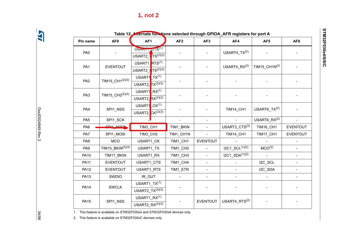

STM32f030f4p6 not isr on timer
I am a beginner. Please help me figure out why the interrupt is not happening. I want to measure the duty cycle, but the interrupt is not enabled. I am losing hope that this is possible.

waclawek.jan
waclawek.janBest answer
Jan 7, 2025 12:36 PM UTC
GPIOA->AFR[0] |= (0x1 << GPIO_AFRL_AFSEL6_Pos);
8 replies

Thank you for your reply, but the interruption is still not there. I am using cnt to check. I have experimented a lot, but haven't achieved the desired result. Maybe I missed enabling some required register.
waclawek.jan
Jan 7, 2025 11:01 AM UTC
> GPIOA->AFR[0] &= ~(GPIO_AFRL_AFSEL6);
> GPIOA->AFR[0] |= (0x2 << GPIO_AFRL_AFSEL6_Pos);
PS. Don't RMW TIMx_SR. Make sure variables you share with interrupts (here cnt) are qualified as volatile. Be careful with modifying GPIO_ODR in interrupts; better use GPIO_BSRR.
Wsitc.1
Wsitc.1Author
Jan 7, 2025 12:28 PM UTC
Thank you. I still don't understand how to fix the situation.
waclawek.jan
Wsitc.1
Wsitc.1Author
Jan 7, 2025 1:04 PM UTC
Thanks. I seem to be getting timer interrupts. The code still doesn't correctly determine the pulse length. Could it be that the falling edge of the signal is not set correctly?

	TIM3->PSC = 47;
	TIM3->ARR = 0xffff;
	TIM3->CCMR1 |= TIM_CCMR1_CC1S_0 | TIM_CCMR1_CC2S_1;
	TIM3->SMCR |= TIM_SMCR_TS_2 | TIM_SMCR_TS_0 | TIM_SMCR_SMS_2;
	TIM3->CCER |= TIM_CCER_CC1E | TIM_CCER_CC2E | TIM_CCER_CC2P;
	TIM3->DIER |= TIM_DIER_CC1IE;
	TIM3->CR1 |= TIM_CR1_CEN;
	NVIC_EnableIRQ(TIM3_IRQn);
	NVIC_SetPriority(TIM3_IRQn, 0);
