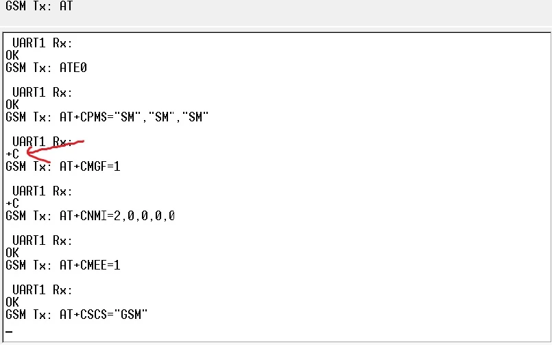

HARI krishna
Dec 15, 2016 12:53 PM UTC
Posted on December 15, 2016 at 13:53
This is the source code what is running for GSM COM,
UART1 for Quectel M95,UART2 is for Hyper terminal.UART not receiving full reply message.

And the hyper terminal  Displays below :
At the red mark we are expecting  result :
''+CPMS: SM,0,50,SM,0,50,SM,0,50'' but not sucesses

aaron239955_stm1_st
Senior
Dec 15, 2016 8:05 PM UTC
Posted on December 15, 2016 at 20:05
The response you are seeing makes perfect sense because your logic is completely confused.
Regardless of the command, this is the way your logic is currently working:
1. You transmit a string (command) to the M95 like AT+GSM.....
2. You delay 2 seconds, during which time the M95 sends a response
3. you THEN enable the UART to receive data, using interrupts (and I still don't see your interrupt handling code)
4. the result of (2) above is that the response from the M95 happens while you are sitting in a 2 second delay.  As a result you get whatever was received by the hardware before it overflowed because you are not emptying the Rx buffer as characters are coming in.  So you get the first 2 characters '+C' which is the beginning of '+CPMS....' but since nobody is looking at the receiver, after the first two characters are buffered in the hardware peripheral (in the Rx register and the CPU interface register) it drops all subsequent characters on the floor.  The whole message was sent back by the M95 while you are sitting in a delay loop and ignoring what is coming back for 2 seconds.  So when you finally enable the Receiver with your HAL call it gives you the two characters it had stuck in the peripheral's registers.
What you need to do is enable the Receiver BEFORE you send a command so that you get back anything that the M95 sends you.  Including the command you sent if you have Echo enabled.  YOU need to figure out what to expect back based on whether echo is on or not, etc etc etc, and throw out any extraneous information and extract the useful response.  You can't use delays to hope that the bad stiff gets ignored and you'll get the good stuff because you don't know how long it will be before the M95 responds.
By waiting 2 seconds to look at the receiver after sending a command, you are ignoring the response from the M95.
And as a side note, setting a receive buffer 5 characters bigger than the size of the buffer you were passed is dangerous at best.  (assuming this will even know what the size is since what is passed to the function is pointer to an arbitrary array)
If you would like me to write the code for you, let me know.

HARI krishna
Dec 19, 2016 8:19 AM UTC
Posted on December 19, 2016 at 08:19
Thanks for quick reply,
The Above code has errors if  we paste same in Debugger,
Any how some what i managed to compile but the code was stopped working on this function
UART1_kbhit
My old code was some what improved it working fine with modem replies .
but how to read modem SIM Messages those are very lengthy. For reading one message it is working fine but at the same time second message is not reading simply executing SIM read command.This is done by
HAL_UART_Receive_IT(&huart1,(uint8_t *)uart1_aRxBuffer,120);
can i do like this?
AT+CMGR=1;
** some text Message Reply**
AT+CMGR=2;
Simply OK
But when i delete first message second one is reading.help me on this issue.
HARI krishna
Dec 19, 2016 8:49 AM UTC
Posted on December 19, 2016 at 08:49
For the while(!UART1_kbhit()); in function
char UART1_getchar(void) is not getting exit from loop.
