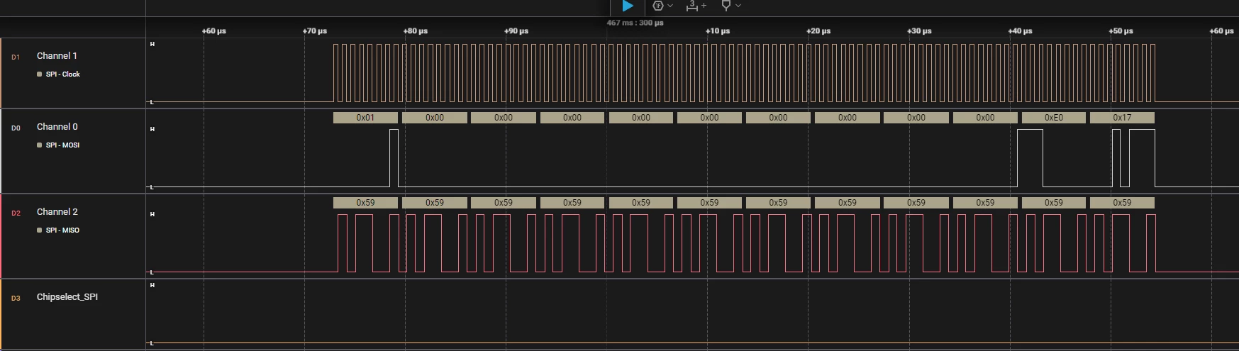

Attached you will find a Logic Analyzer file that shows what the master
sends, as well as a debug file that shows the data in the array in which the
problem occurs.
