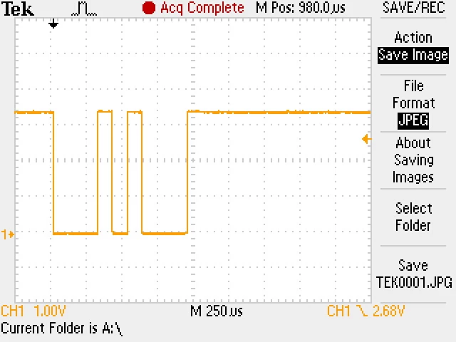

thanks for your reply. I am sorry that I did not make it clear enough that I have the STM32f0 discovery board with an STM32F051R8T6 on it.
The link Shows you the board https://www.conrad.de/de/p/entwicklungsboard-stmicroelectronics-stm32f0discovery-443923.html.
Both the Manual en.DM00050135.pdf and the data sheet for the MCU make it clear that PA10 and PA9 can be used as USART 1.
In the schemtic MB1304.pdf I could not see that PA10 is connected to something else.
I double checked that I have connected Rx of the cable to Tx of the microcontroller and Tx of the cable to Rx of the microcontroller.
I double checked also that I have 9600 baud rate , 8 data bits , 1 stop bit , no parity and no handshaking setup in my terminal program and the discovery board.
I also measured with the oscilloscope already on pin PA10 and I see the data package there.
I also tried it the way I saw in some other examples online where they set up PA10 as floating Input instead of Output push pull like it's done in the examples from the library. Did also not help to solve my issue.  And a third thing I tried was to use the Code snipets in the Appendix off the reference manual en.DM00031936.pdf.
So this leaves to check the clock setup. Do you have any other ideas now that you have the info which board I have ?

If the transmitted packet looks right on the scope (can you post a screenshot?) then there's nothing to improve on the STM32 side.
Disconnect the serial adapter from the board, and connect its Rx and Tx pins together. Can you see the echo of what you are typing in the terminal?

I checked with the scope that data package see attachment. The value on the scope is 0x14 which is what I send.
Also when I bridged Tx and Rx on the FDTI cable. The reply was as it was supposed to be. Timing measured with the oscilloscope cursors was 100 microseconds per bit. I calculated 104 micro seconds for one bit for a baud rate of 9600.
I found out after the hind from Ozone that the Hyperterminal was tested on the STM320518-EVAL as well as the other example project for USART I mentioned yesterday.This EVAL board has exactly the same MCU as my STM32F0 discovery. I program and debug via the USB cable at the moment.
I used the USART setup from Ozone's last answer. Only thing different is the 9600 baud instead of 115200 baud.
Did also not help so far. I need to check SB14 and SB15. And I also still need to double check the on the flags.
This I'll do tomorrow.
